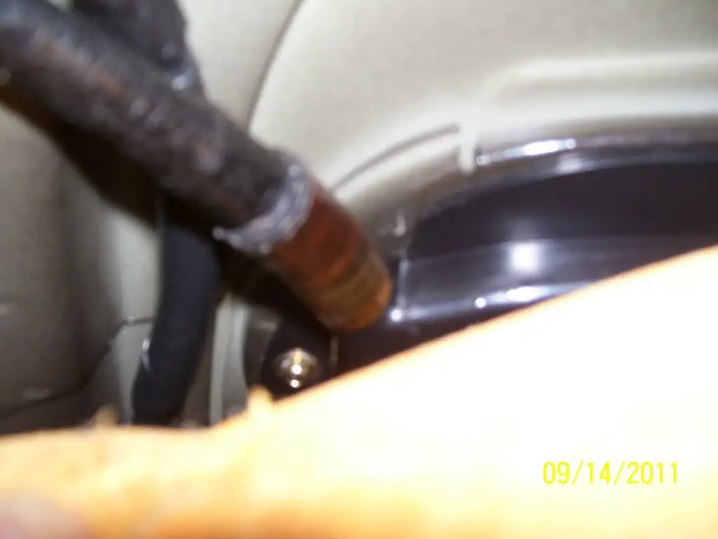

So since the leak lets water under the sunroof into the cavity underneath, the drain tube is supposed to let that water flow under the rig and cause no harm. Well, that would be great, if it worked like it was supposed to.

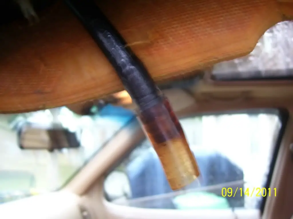

LOTS of water was in the rig. Seat, headliner, & carpet was soaked on the Drivers side. So I removed the trim and the sun visor and carefully pulled it back a bit to get a good look inside. Found the drain tube attached to the sunroof. When I touched it, it fell off. Aha! So, that's where the water was getting in!

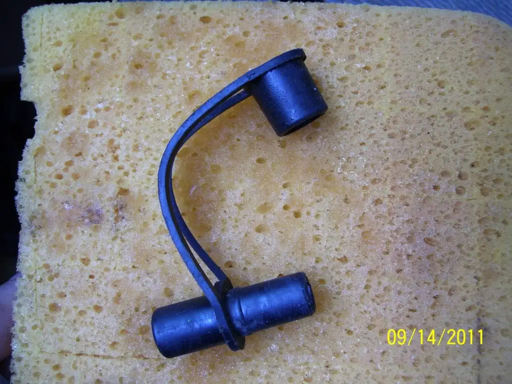

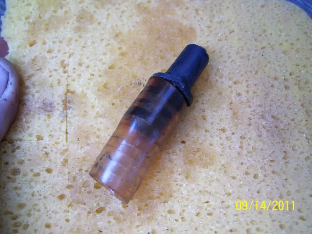

There is a plastic insert on both sides of a short fat tube that acts as a tube size adapter. Well, it had fallen apart inside. Crumbled to the touch, and was blocking the water flow. The drain tube in the A-pillar is a dif size then the nipple on the sunroof, so they made it fit with the inserts and a fat short hose.
This is the drain tube & the drain nipple separated from each other.

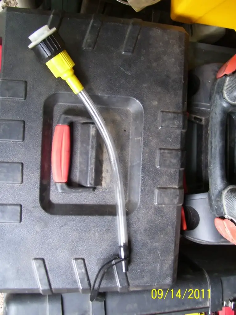

After using a coat hanger to clean out the drain nipple and channel, I came up with this fix with something I had in the shop. This is about as redneck as it gets, but works like a charm.
Enter the cheap fluid hose that attaches to fluid bottles.
The black tip is what I was after. Two different size ends that fit perfectly in the two different size tubes.
