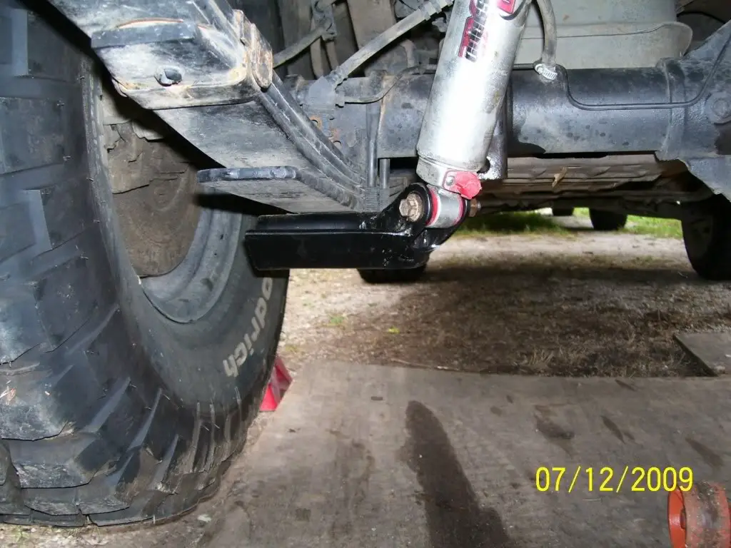

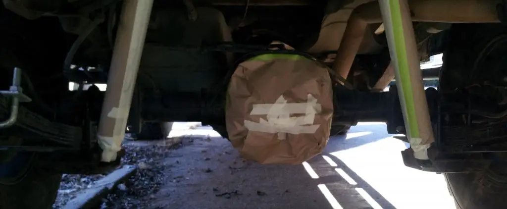

Rear axle, Leafs, skids, all got prepped and freshly painted today.
Now to figure out something for those rusty shock cans. :scratch:

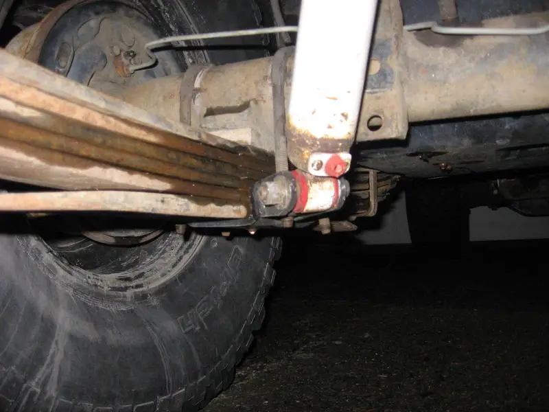

Don't know if you noticed how fast the rancho finish failed. My friend installed a set of those to his blazer and they started rusting in a month of pavement driving.
Turn your shock bodies around so the adjuster knobs are facing the front unless you like replacing them (he says from experience)
The Rancho shocks are a few years old now, and they are just now starting to get some rust. They look great new, but look terrible with rust. I might remove them, and paint them with some xlm bonding primer and a color of choice.
Since they will be off, I will install them as you say Phil. Guess I have been lucky to not have busted them knobs off. Maniak has told me about having to replace his as well over the years. I just never got around to it. I'm sure the 3" raised mounts have helped somewhat.
I think mine are a little higher than yours. If you don't back up, no problem.
They are about $15ea IIRC.
Total Chaos U bolt plates with tabs welded on. Notice the missing knobs :(

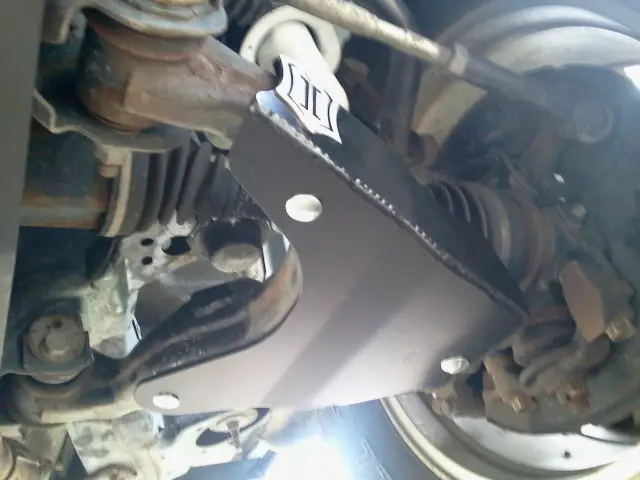

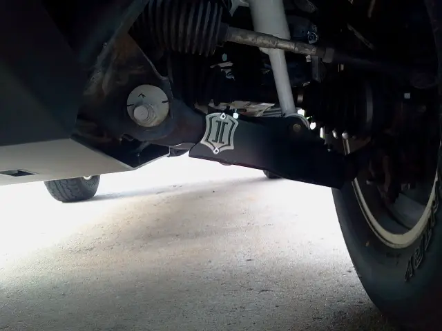

These are a set of ICON II skids I installed on the FJ Lower control arms. They were tested in MOAB last spring and worked amazing. I have been talking with a certain member here to try to fabricate a set for our 2nd gen LCA's but with a 45* slant on the front of them to help slide over better. Stay tuned folks, these could be a reality for us soon! :)

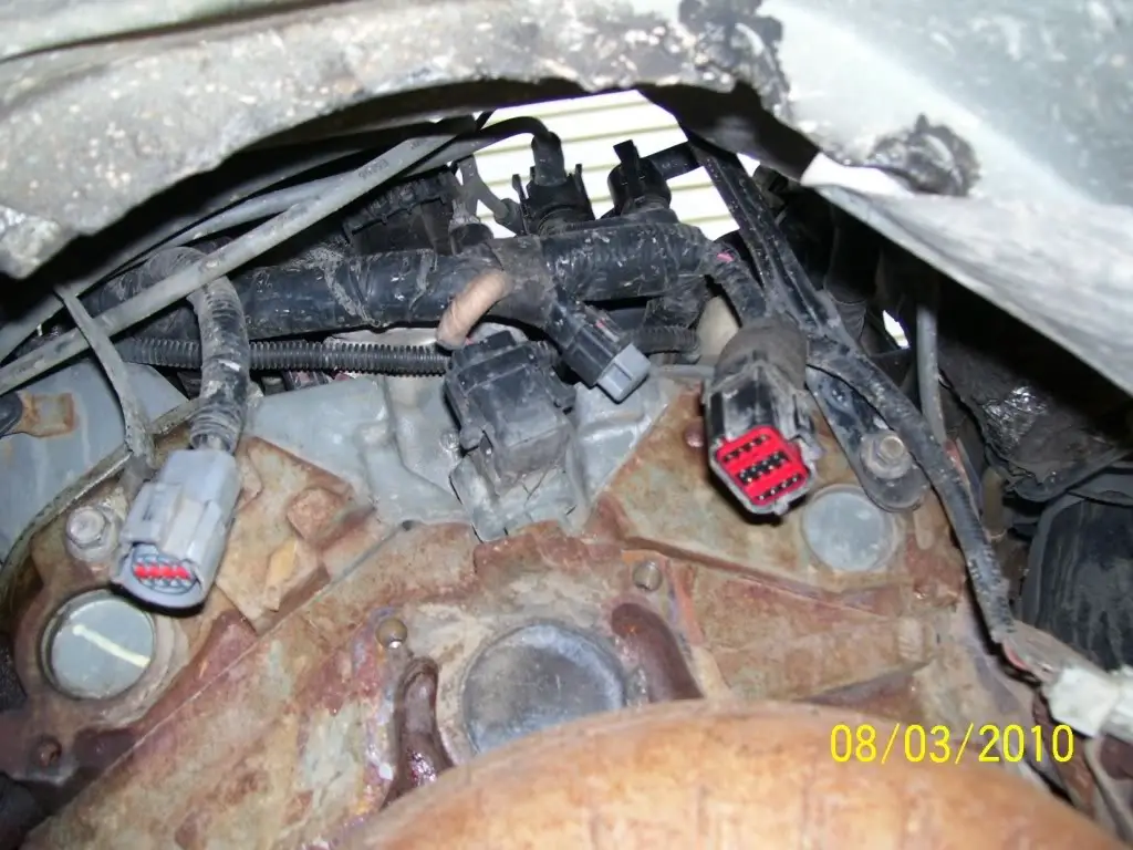

So I couldn't find the Spout connector anywhere in the engine bay, or close to the ICM to remove for a test. I was just reading the Going Full Manual thread again looking for something when I spotted the Spout connector in a Picture I posted. LOL, crazy!
