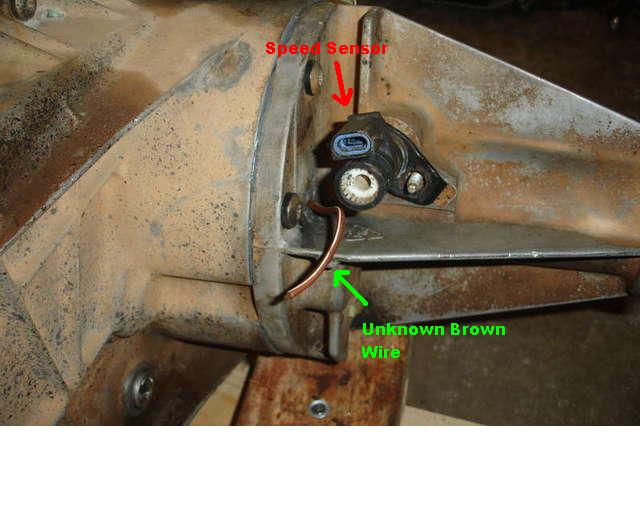

I'm just a little worried about how low that range sensor is.
Nobody answered my question about that threaded hole above the range sensor or the brown/white stripe wire coming from the tailshaft housing.
I thought the tailshaft sensor was the speed sensor?
Maybe the second front sensor is a low fluid sensor?
They made a bunch of different versions didn't they? Mine is different still, I have nothing on the front, and at least one sensor on the back besides the VSS.

from my conversion thread, in my sig:
I asked the same question
The brown wire is circuit 779
Electric 4x4 shift module to electric clutch in t case, directly from the module to the t case.
Same wire for my 88 BII wiring book and 93 explorer book.
I am not sure if the 96 has a electric shift module or if it is done through the GEM or what
I will continue to dig, it powers some clutch inside the t case
Okay according to my 01 explorer wiring diagrams the shift module is located near the GEM and is controlled by the GEM it does have the 779 brown wire output to the t case. Power is switched to the 779 wire from the 4x4 fuse in the power dist box. So if the electric shift module does work in your truck (the signals to the GEM from the t case and possibly 4x4 button on dash will need to be hooked up in a truck like mine) then adding the fuse and hooking up the brown wire should work.
I will have to test it with a multimeter after I install the fuse, then if it works hook it up to the t case.
If not then trying to get the GEM to work with the manual shift t case and no dash switch is the next step.
completely fool the truck 100% or basically build a manual shift t case 5.0L truck like Ford should have.The question is when does the shift module send power to the t case internal clutch.
When in Neautral?
What does the internal clutch do?
I suspect its for shifting to low range when the truck is in N
I do not have this wire hooked up in my 96 XLT, I have used and abused the 4406 t case in that truck, beat the living cr*& out of it off road and I have no issues shifting from 2wd to 4hi while driving
for 4 low you have to stop and put the truck in N
I believe the brown wire is for an internal clutch inside the t case, I do not believe any of us explorer guys have hooked them up, and I am not exaclty sure why it is needed.
I can tell you my 88 BII has th esame brown wire in the 1354 t case, it is hooked up, its part of the electric shift 4x4 system on that truck...
