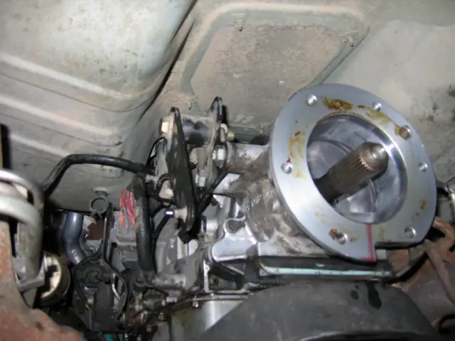

3.5" should be plenty I am thinking, but are you talking about right here? this is not on the t case its on the tailhousing
if the only linkage you dont have is the solid rod that goes from shifter assembly (side of tailhousing to the transfer case shift arm) I would think you could fab one of those at ace hardware
Linkage:
Nice pictures, Jamie!
See the gold bolt at the top of the shifter arm? It needs room in the trans tunnel for a non BL truck. Don't know how much is enough though-

Here is a picture of where the non Body lift guys will need to "adjust" for some clearance
red circles are the spots to hit--
Yellow circle is the shift linkage mount--you need additional clearance here
Blue circle shows relocated harness, to first bolt hole.
Yeah it is dirty under there--I'll hit it with the powerwasher when I am finished--
