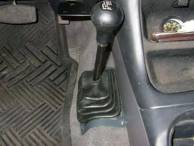

You'd just about have to use the boot and knob only- the curve on the side of the trans hump is fairly steep. See the curve in the picture below-
agreed rubber only or custom bend in a metal hoop
I plan on going with leather when I do the swap. If need be, I'll have my aunt to custom make one. She does a lot of sewing.
I bet Evan would like to cut his carpet again. Mounting the shifter and bracket with the carpet out would be the best way to do it. After that you can cut the smallest hole possible, and have the boot protrude out around the rug opening. Regards,
Like mine :)
Looks clean, I was amazed at how lucky I got cutting the carpet, I started small of course but I actually got the fit I wanted the second time, perfect, i was like um okay that works.......expecting to spend alot more time on it then I did
Right- my cut is actually fairly small- I can still get another boot and re do it, but I am satisfied with my current setup. It looks worse in the pictures because of the bright flash.

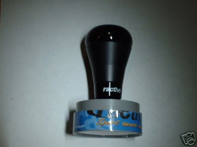

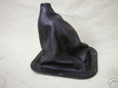

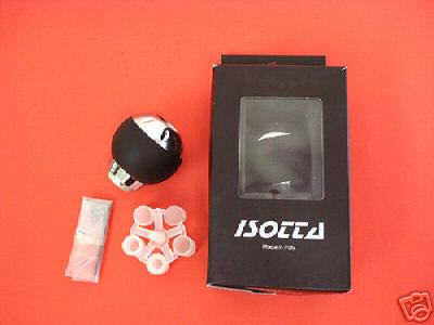

I found a boot I like for a good price--
I like both of these knobs--bottom one is my favorite I think--

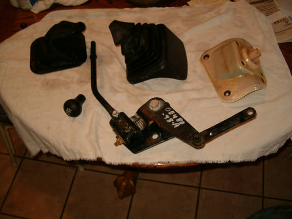

UPS brought this today-
I hope to use the white boot-it looks like it will seal out the elements well,
Then I want to ditch the rubber boot from the middle assembly, and run the leather one ( on left) up through the plastic finish trim piece. I'll try to trim it to fit nicely against the console--maybe under it a bit.
Oh yeah, got the rear drive shaft also--

I tried the white boot, couldn't get it to work at all. The curve is not right for the trans tunnel, in order to get the shifter to fit through the hole, it sticks way into the foot space on the drivers side.
So your going to get that stuff installed ASAP? Get that thing rolling! Jackstands are not a good place for a 347 ci Mounty!
That's a good set of parts to work with. With the plan you mention, I'd set the white plastic piece against the trans hump, then start trimming away the right side of it. Make it fit properly against the tunnel, then add epoxy to it to give you a place to bolt it down.
