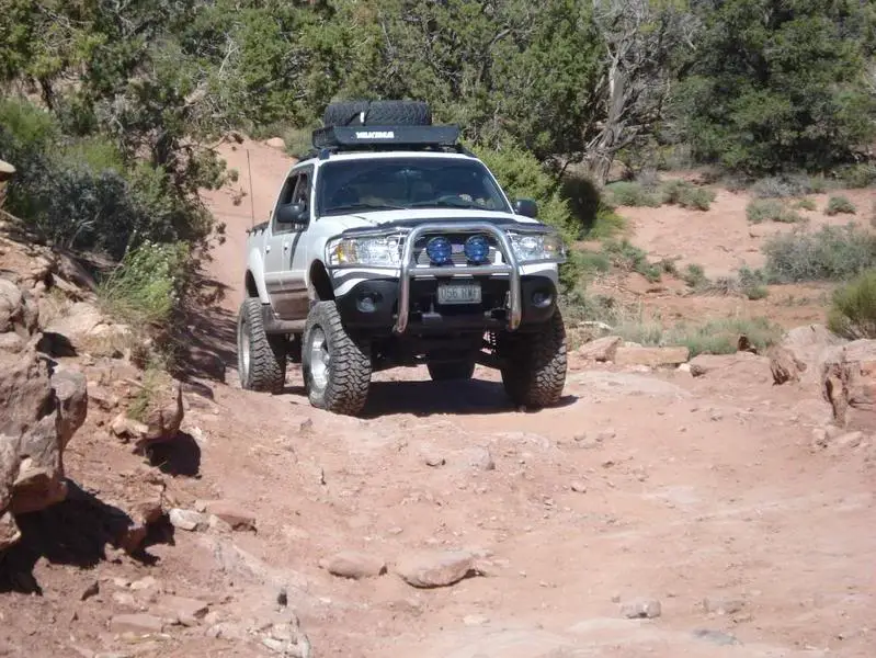

Those coilovers need more preload. When I installed those on my rig I gained another 1.5-2" of lift on top of the 4" Superlift kit. Your lower control arms should not be level they should be angled down to ahceive more lift. Also did you install the aluminum bushings/spacer that go between the upper shock mount and the stock shock tower?
Just my 2 cents... I noticed the same thing on Jons rig at CCR.
Here is how my springs looked when installed. I was worried they would bind up on compression but it never happened.
Chad,
The control arms are set to allow about 2" more of droop. They could be set higher, however going past half way on the shock is a bit un-nerving to me. Not only that, the arms would be at their droop limit.
Maybe a 800 lb 14" spring would be better, instead of 12"
I will say, to the center of the control arm bolts on my truck was a mere 10" where Pete's truck is sitting at 12.5" with the same pre-load. The rocker panel has about a 3/4" rake. I like how it sits, and rides.
:dunno:
The alignment guy liked it. The Camber adjusted right in.
OH edit
The posted pics are before final adjustment. The pics were to show how good we had eyeballed in the first setting. It was level.
I can see the confusion, Petes arms are angled a bit now.
I would say the shocks are pre loaded about 1/2" up from where Chad had them on his Sport trac.
