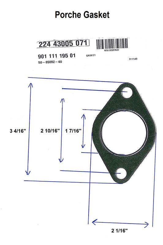

I've been struggling with finding a gasket for the drivers side 2 piece header.
Bringing the remflex gasket to Canada is massive dollars to ship to Canada.
I then tried bringing in the porche gasket, and the source listed didn't think this gasket would work as its metric, and didn't want to bother even quoting on shipping.
Enter ebay....I found the porche gasket at a reasonable price and decided to bring it in to try. The dimensions will be extremely close to fitting. Has anyone actually used this gasket and can confirm it works?

Porche gasket is a bust
Ok, The porche gasket works in a pinch, but I don't know for how long.
I had to remove the copper from the gasket, and 'modify' the bolt holes.
We need to try the next option and get an answer as to if its a bolt on solution. I sure wish people would post what doesn't work so we could all learn....I'm sure I'm not the first to try this.<<<<end rant.
Sorry about the crap pic of the gasket on the header, but you get the idea.
So, What gasket do we use that works?

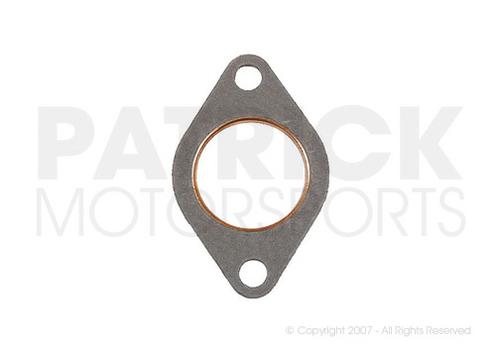

I "think" it may be this one.
GASKET - EXHAUST MANIFOLD TO CYLINDER HEAD - PORSCHE 914 6 '70-'72 / 911 '65-'76 - VICTOR REINZ - LIST: $13.92
part number
GAS 901 111 195 01
http://www.patrickmotorsports.com/part/gas-901-111-195-01/
I only have one of these. Andy already spoke for it.
Mine blew out last week (pretty sure it wasn't the originally supplied gasket) after a ton of searching and ordering various vw and Porsche gaskets I found one that only required a little trimming to fit the bolt holes. I'll update with the part number tomorrow.
http://imgur.com/Rm9tFfA
Edit: Same part number I used.
930 111 191 12 also fits and has a little bigger hole so if your tubes aren't flush with the flange it'll seal properly on the flange itself
