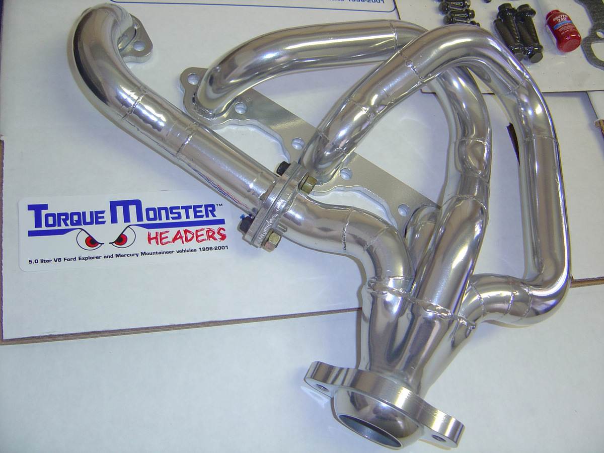

the ports of the gt40p heads are different, the header bolt is moved slightly trying to use a "normal" mustang gasket will result in port protrusion.
The #5 tube is 2 piece to get around the steering. The gasket is for the tube joint. That is why they are "messing around with it" :rolleyes::rolleyes:

The gasket in question is in the header assembly not the engine header interface.
Headers are not factory manifolds (duh Right?:)). Simply by the nature of the materials used (cast vs. steel or stainless) expansion rates are different. There are more factors than just bolt torque. OEM gasket are designed with cast on cast expansion not cast bolted to a piece of steel. The rigidity of the header is different than the stock manifold and the list goes on.

Grrr okay. This is gonna sound silly coming from someone who's had these headers nearly 5 years now. But I'm replacing the driver's side gasket and everything was going alright. That is until it came to lining everything back up right. Some of the bolts were fighting with me then I got 7 outta 8 snugged down. But the 3rd bolt over from the front (Left bolt on primary 6) Will not thread in for the life of it. I cannot figure out why and has resulted in a paragraph of colorful language and a few slammed wrenches. I've done this task several times but for some ungodly reason it's fighting me big time. And no matter how much I try to move the header flange and slide the gasket around It still will not thread any bolt in there. Any ideas?

Start by removing bolts until you can move it enough to get the stubborn bolt in, then place the others again. Do not remove the end bolts though--you need something to hold the gasket in place. Hope this helps.
You aren't going to like this suggestion...but you may have to loosen the flange nuts on that tube that separates. The problem with that...is finding a gasket to replace the one you are likely to ruin. But I'm betting that once you have everything loose, it will allow everything to line up. Worse case scenario is you drill out the hole in the flange a little larger, but I would make that a last resort.
Well I actually did loosen the top nut on that flange tube. Now I can get that one bolt to sort of go in. But it doesn't go in straight and tightens prematurely. So I may just need to loosen the bottom nut on there just a but and maybe it'll go into the hole straight. I never remember having this much issue replacing this before. BUT I will say a couple of months ago I did actually put a new gasket on that flange tube. Maybe I didn't line it up straight with the rest of the header because I did remove that tube without loosen the rest of the bolts. Thanks for the tip Jon as well, I actually been trying that and even then it still won't line up quite right. So let's so I loosen the flangeg up some more and it does line up. What order would you recommend re-tightening everything down? Once all 8 of the main flanges are in place then re-tighten the joint tube?
I believe in tightening down from the inside out. That way everything moves in an outward direction. After the flange is tight, tighten that tube flange. Warm up the car, let it cool, and tighten again. Do that a couple of times. If you used MLS gaskets, you may never change it again those are so good.

Finally! It did take unloosening the joint flange to get them all lined up and threaded in. Now for a test drive! :salute:
