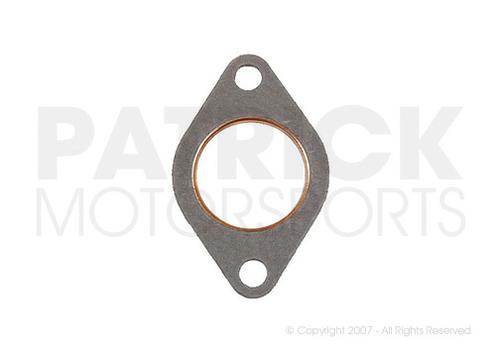

If it helps, Bob told me the gasket was from a Porsche. He didn't give me a make or model, but if there was a parts source nearby and a helpful counter person, you may get somewhere. I can't remember if I still have my box of spare gaskets or not, I'll try to look this afternoon.
That's damn good info!
Again, for the main gaskets, see if you can find a set of MLS gaskets that will work. But you know, since these are the different 5.0 head, I wonder if that will be an issue...
No wonder they run, with Porsche gaskets... :D
Actually, I'm surprised they even start with those gasket! Ok...here it comes...
Maybe a 928???
Good stuff Jon. Looks like the gasket fo sho. If anyone can confirm, I might order a set or two for future use.
I've been talking with someone from Remflex the past couple of days about getting replacement gaskets, and I mentioned this one to her too. She asked me for a couple of measurements and she will try to find one that fits. I'll report back when she lets me know if they have one.

Has anyone tried this gasket before? Looks like it might fit perfectly, and Remflex is willing to send me one to try. The ID of the gasket is 1 7/16", and the header tubes are 1.5" OD correct? That should be pretty close.
http://catalog.remflex.com/COLLECTOR_CONNECTOR_Flange_Exhaust_Gasket_p/8051.htm

And that Porsche gasket doesn't have any dimensions listed, so who knows if it would actually fit.
