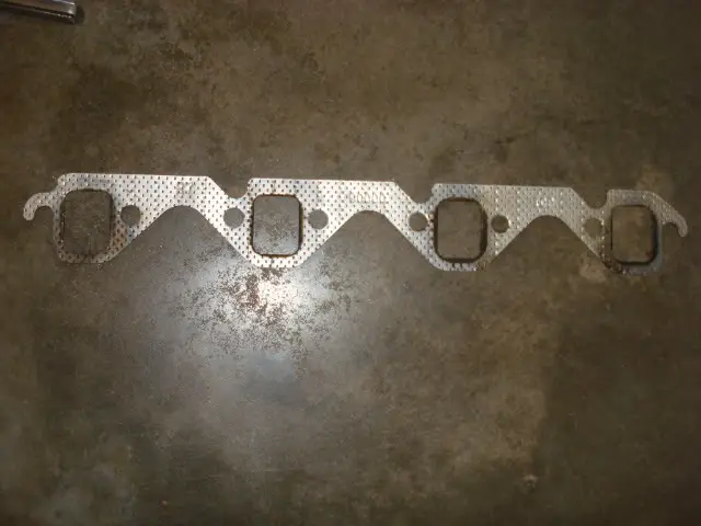

I hope the Headers are working as advertised for everyone and we thank you for your patronage. All the best!

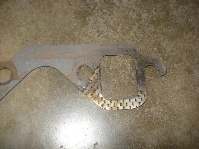

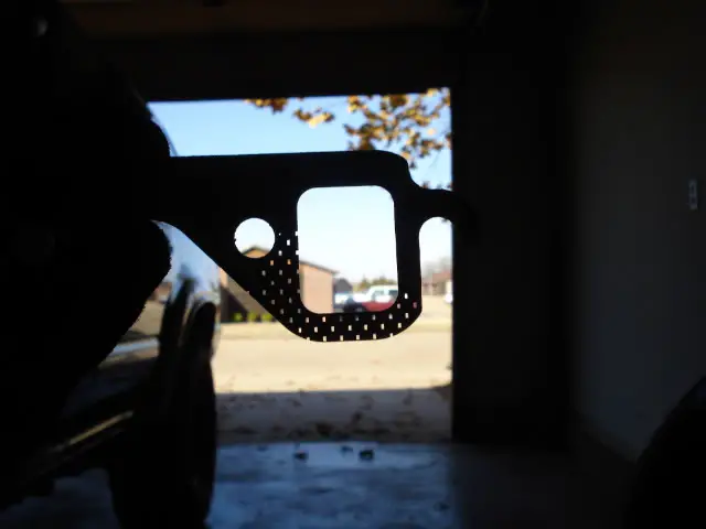

Took the driver side header off today to fix the leak. Here's the gasket, notice the left port.

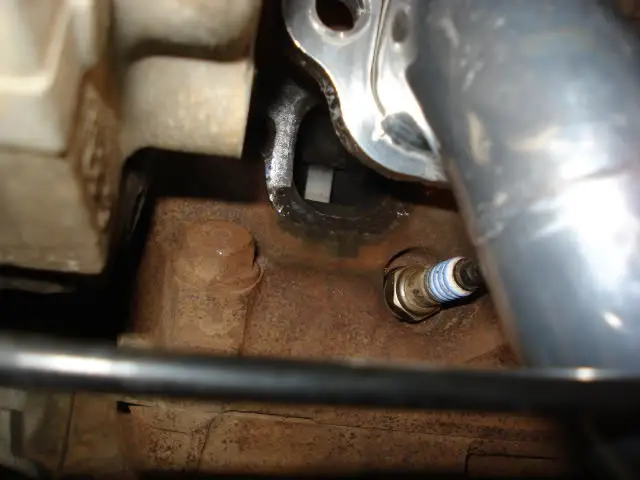

Here's the back side of that same port.
I think I found the problem...
Notice the soot that 410 was talking about.
I re-installed the header with one of the new gaskets that were included with the headers, no more leak!
Was that a fel pro gasket? I haven't ever seen a paper one.
It's kind of a headache to get new headers to seal up sometimes. But I'll bet it sounds great now.
Yes, that was the Fel-Pro gasket that broke. I was out driving it tonight and it sounds and feels so good, I was struggling not to speed the entire time.
