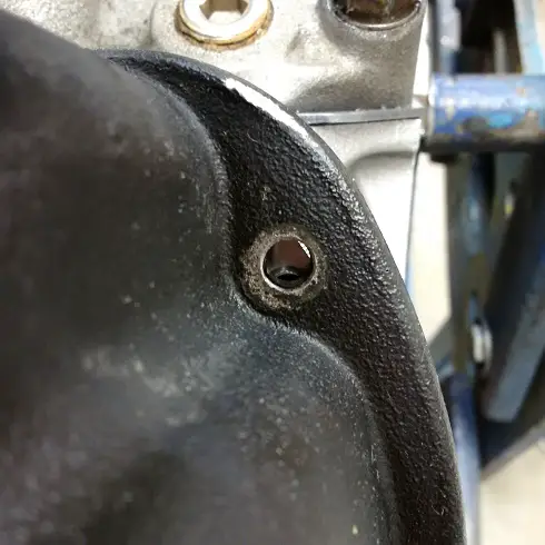

I ran in to a 'snag'. Explorer valve covers positively will not fit. So, who do I text? Tim. He says, come on over....I have a set of trickflows that will clear everything. Then after I explain that my passenger cover has an an6 bung for my oil return I get the 'who gives a cr*p', we will plug the hole.
Now, If I find an aluminum an6 bung and a welder tomorrow we still might get the motor in this weekend.

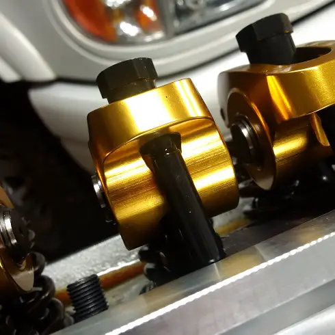

The heads took a bit longer than I would have liked. Ed ran in to a few issues that slowed him up, then the rockers were on back order with comp cams. Ed did manage to get comp to drop ship the rockers directly to my shipping location.
I am very pleased with Flowtech Inductions. I do like to deal with the small business guy for many reasons. This does include personalized service and what I tend to expect to be better attention to detail (This doesn't always work out for me).
On closer inspection of the heads, I can see where Ed un-shrouded valves ever so slightly. Also, interestingly enough, he spent some time massaging the oil return ports in the heads for smoother oil return with less restriction.
The trickflow valve covers from Tim do fit (I tested them 'before' drilling a hole in the side of one). The guy I get to do my welding has the valve cover and thinks he will be able to weld the an6 bung on tonight.

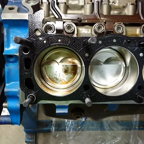

I checked the block with a straight edge before the heads went on. As flat as flat can be. After cleaning the block and heads with brake cleaner (again) I set the head gaskets. I will say the Mr Gasket Graphite's are very different. The surfaces on them are super sticky. I also found that a re-torque did tighten down about another 8th turn after they sat for a few hours.

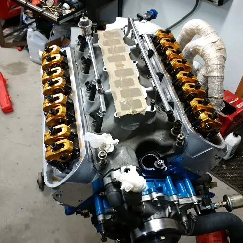

Here's a few pics.
The headers have been extremely frustrating.
First, I knew I'd have to adjust the head and/or the #5 cylinder header pipe flange as the split pipe gets in the way. No problem, Mr. Grinder took care of that. Some off the head and some off the flange. Not to happy about clearancing (Is there such a word?) my shiny new head, but.....
Then, I install the valve cover...WTF? The header pipe is in the way. Valve cover wont slide in to position. Noooo...... Well, out comes Mr. Hammer. A bit of work on my header and the valve cover fits. Nice....I just tightened up an already small exhaust pipe slightly. :(
Ok, on to the passenger side.... WTF, not again? The flange won't mate to the head tight. Yup, time to pull Mr. grinder out on the other head. Now I want to cry.
I have a close look and notice the headers couldn't even have been designed further from the block as I can see the other side of the same area is rubbing on the motor mount. Headers have no business being on our V8's. Period.
Then, I go to install the dipstick tube....Where's the handle of the dipstick I say to myself? Found it....Broken under something else. After picturing myself behaving like a 2 year old, throwing myself on the ground and kicking and screaming, I regained composure with a deep breath. I tried some JB Weld, and we will see how well it holds tomorrow.
End result is that both headers are on. Im still not happy about what I did to my new heads. Tomorrow is a new day.

I know. I took the header wrap off in the area's that were against the valve cover and it brought me close. After that, some massaging of the header pipe was in order. The headers are just that tight.
With my turbo, I really have to question if the headers have been worth all this pain. The 'damage' has been done to the heads already, so the headers will stay on.

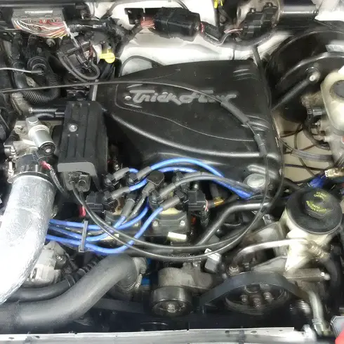

Tim was a champ yesterday. Id have called it a day before finishing, but Tim was determined to hear the motor fire before leaving. And fire it did.
The heads created all kinds of fitment issues. Exhaust wouldn't quite fit, there is a bolt in each head that is 5/8" for the accessory brackets instead of the 3/8" factory bolts...After finding the bolts, then I had to find a 5/8" metal drill bit. Not common.
Spark plug placement is very different. There is room for plug wires and a spark plug wrench, but not without some finesse.
This modifying stuff takes so much time (even traveling back and fourth for bolts, drill bits, etc.) I'd never have completed it this weekend.
Motor started great. Then during warm up the coolant overflow tank filled right up and was bubbling. Noooooo...
Tim kept me calm. Just an air lock.

The bad.... exhaust leak to deal with.
The good.... runs really strong. There seems to be way more bottom end. I flirted with 1 lb boost and it felt pretty good. Coolant level is where it should be.
