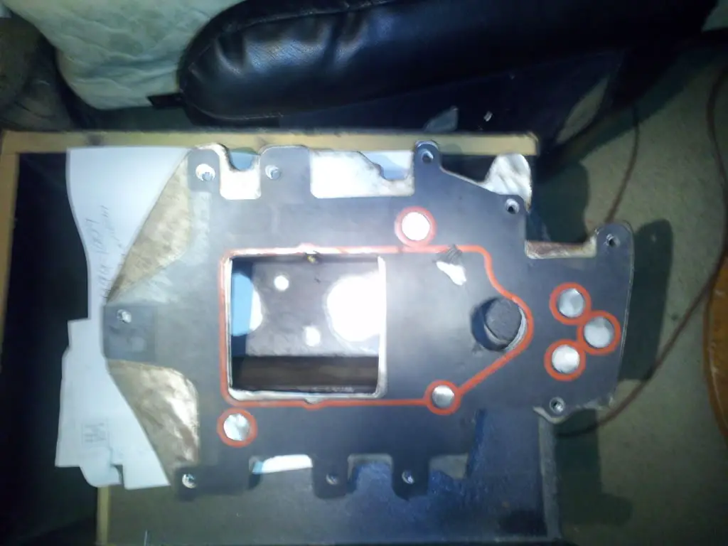

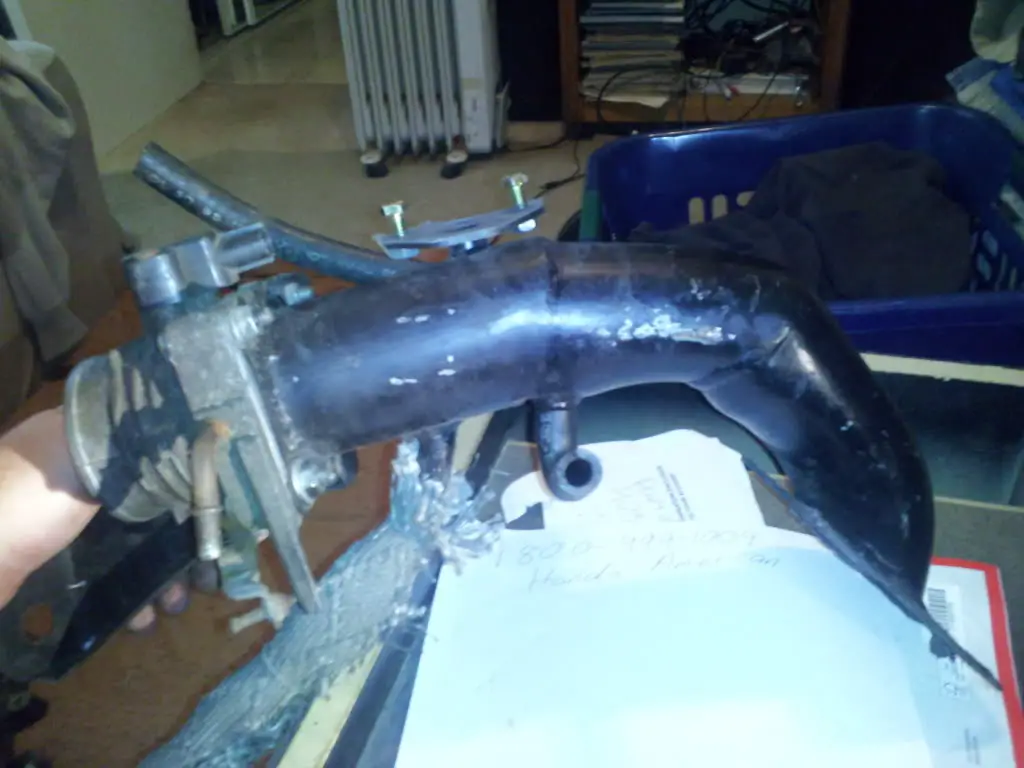

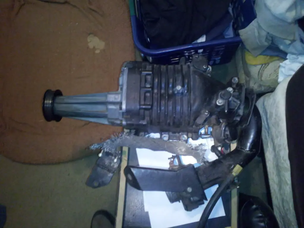

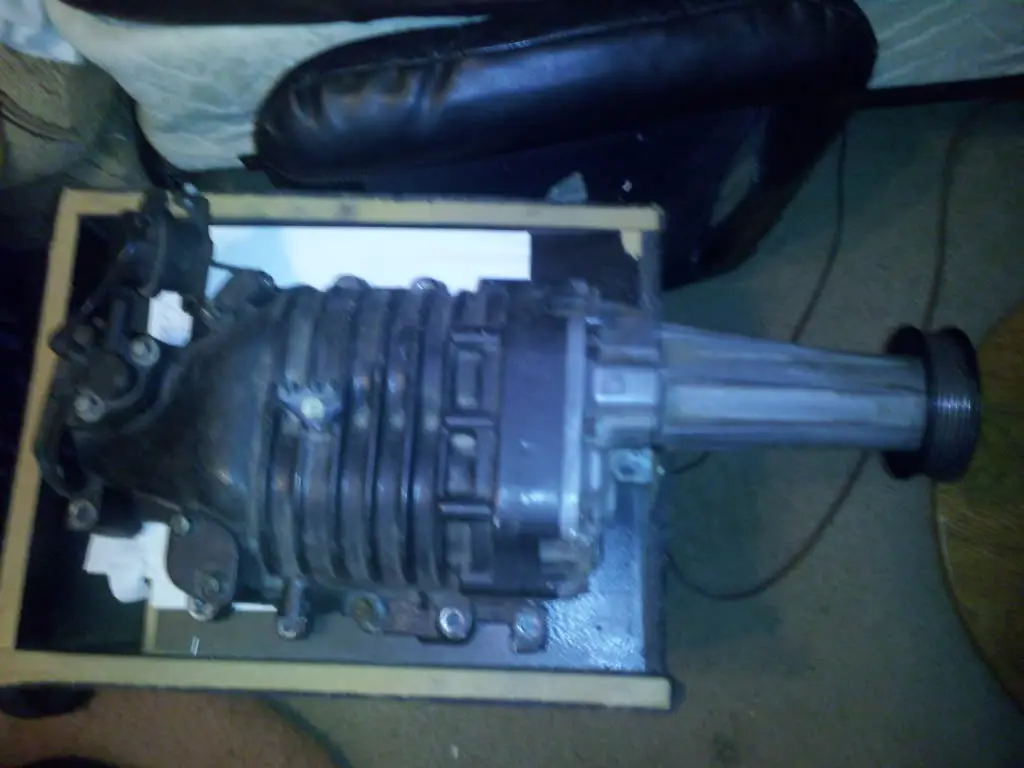

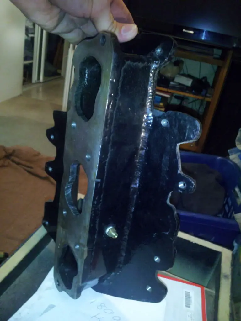

so everything looks really good.guy put alot of work into it.the only thing i dont like is the intake manifold where the tb mounts.its a master piece but its a little small.these things from what i have read like large intake manifolds and can really affect boost.i wonder if the manifold from a tbird fits on the 3800?idk how i would even go about finding out,could be as simple as searching for that gasket and see if they all use the same.they make aftermarket manifold for the tbird i think.any rate on to the pics
That is a nice manifold. Some serious work went in to it.

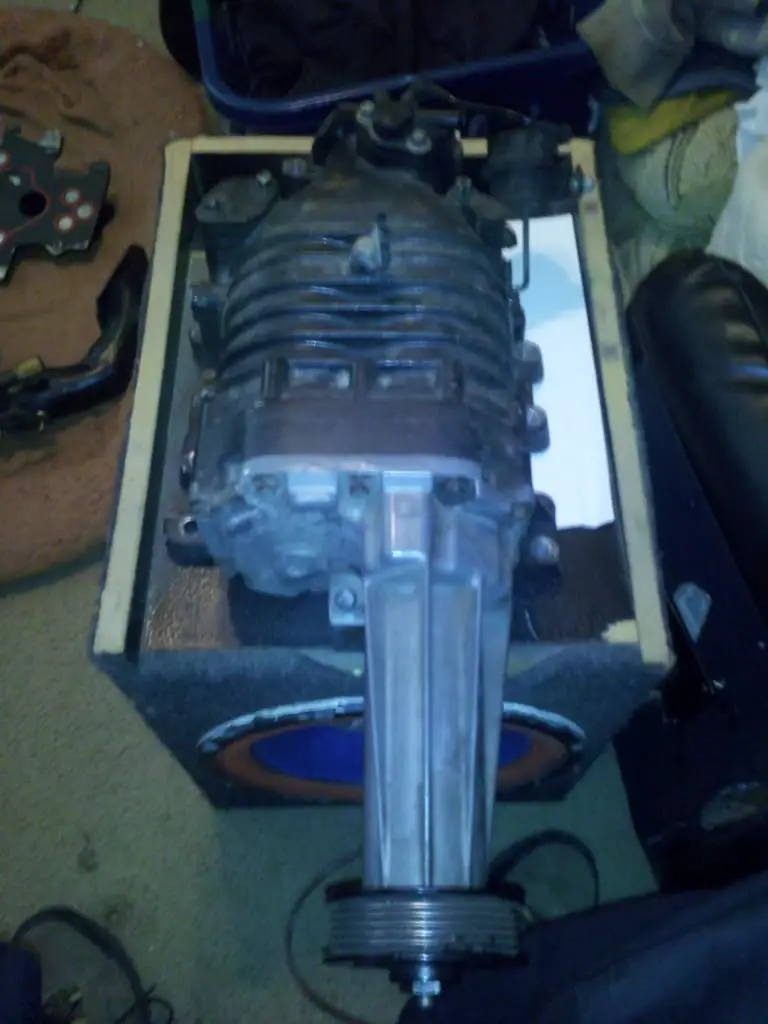

So just a little update.i called and talked to the guy at 3800performance and he is going to build me a custom charger.he is filling a couple of the holes i won't use and porting and polishing the whole unit afte.he is also milling down the snout to fit smaller pullies.there is some other stuff getting done to it but that im keeping a secret till at least i get it back and only if you can tell by the pic will you know;)i helped out my buddy Chris(boomin ) with picking up an explorer after a 10hr straight trip so i now have a sohc oil pan and all parts for it.figured it may help a little and why not it was free.so next sat i will be trying to put in the fuel pump and sohc oil pan.im going to try and do it with out removing the engine,i have a 3" body lift and 5.5 so i should have room to crank the motor up pretty high to get it off.do i have to use the sohc pump and pick up or can i use ohv pump and pick up?or can i use sohc pick up on my ohv pump?i have a high flow pump so i don't wanna get ride of it?!!!!
