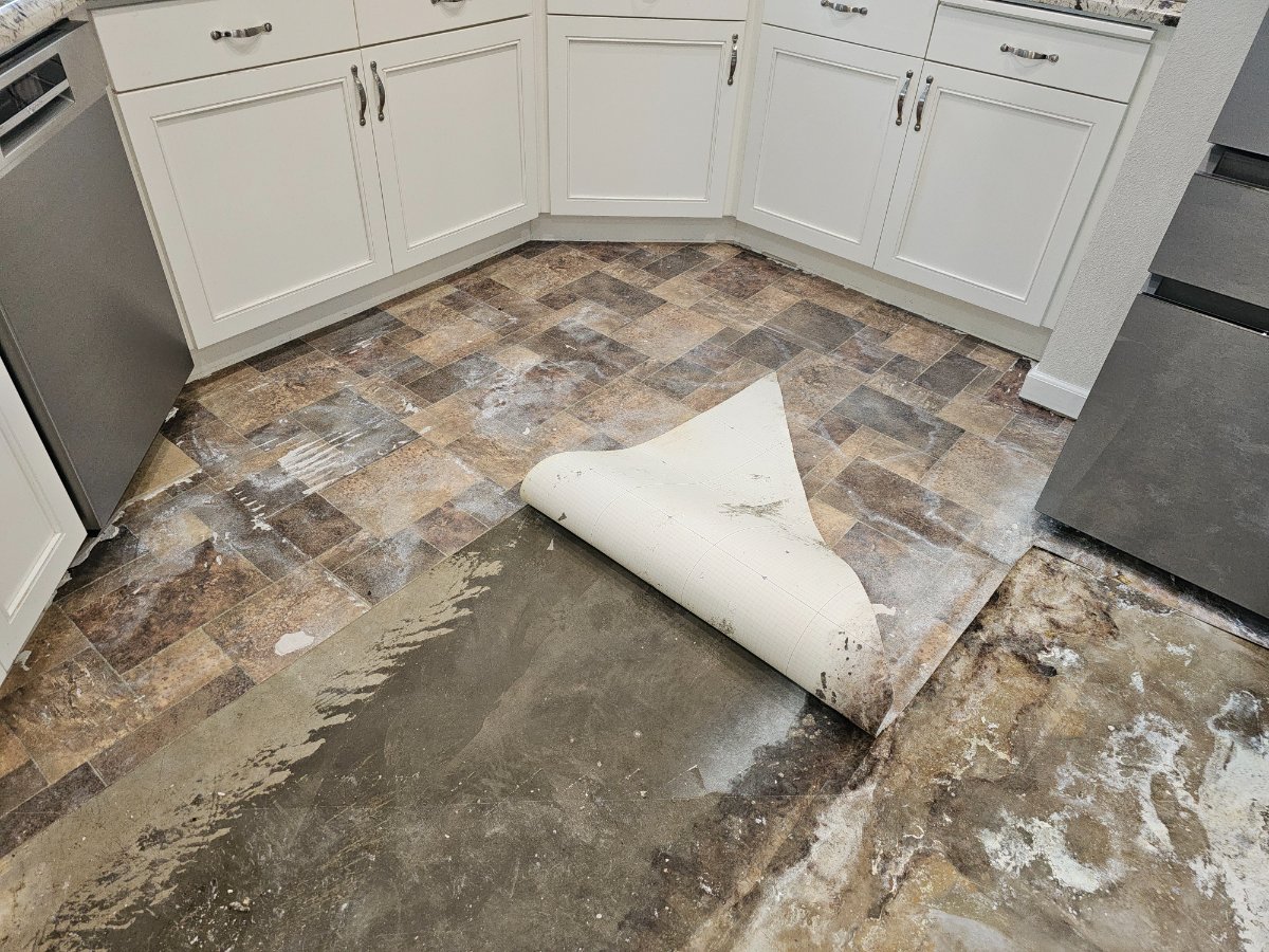

I might not dread it if it were just new flooring. Unfortunately it's soft subflooring that means tearing it down to the studs and rebuilding.
Basically a full kitchen remodel at minimum and will expand as I find the extent of the damage. Plus complete water line replacement. Can't tell that it is leaking yet, but it's polybutylene and well past it's sell by date.

Glad I'm not the only one. Actually my friend John was supposed to be released from the assisted living facility on Wednesday. Tuesday night he couldn't speak without slurring his words so he ended up in the hospital, he admitted to me he doesn't want to go home now so I'm helping my dad replace the floor in the kitchen.
