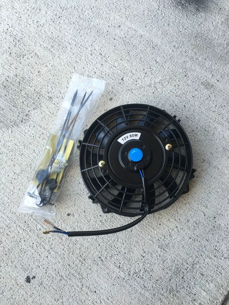

I got a 7 inch fan from Amazon for about 25$ it came with the fan zip ties to attach it to the radiator with. I would suggest getting a 5 1/2 or a 6 inch fan as I have about half an inch hanging from the bottom and the top of my radiator but it's no big deal.

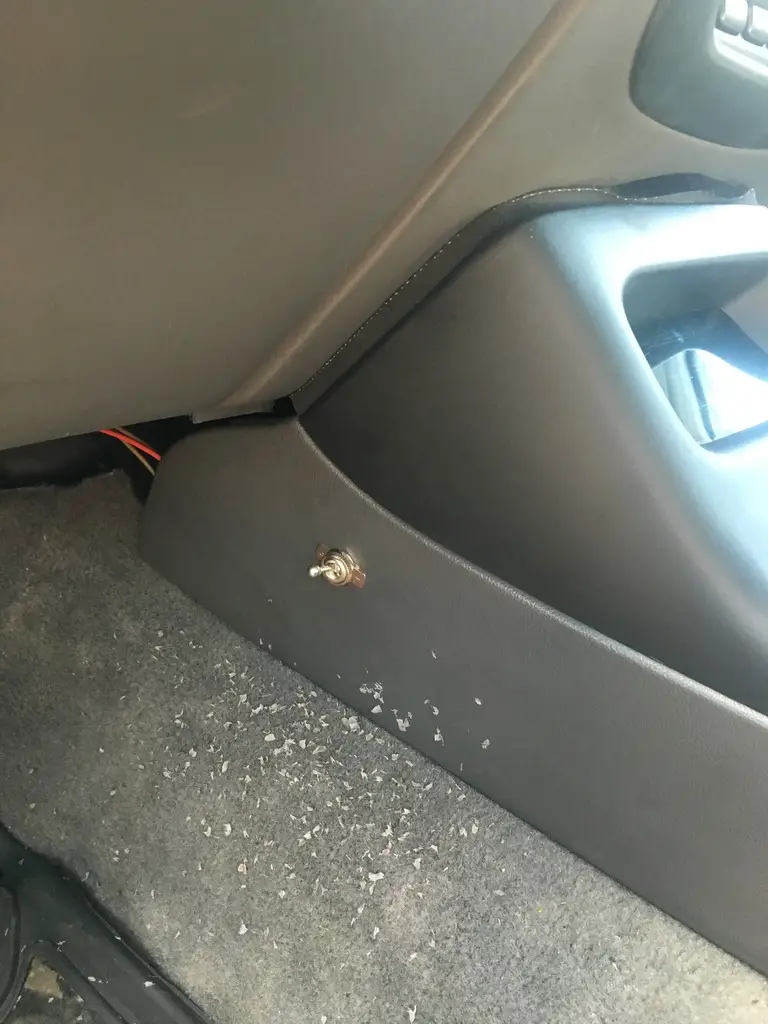

Next I found out the polarity of the wires to get the fan to blow the right way then I mounted it. I ran one wire to ground and the other to the center console to be mounted on my switch. I ran another wire from the battery to the center console with a 7.5 amp fuse to go to the other side of the switch in my console. Here is the switch I've mounted, it's below my message center so I don't accidentally hit it with anything.

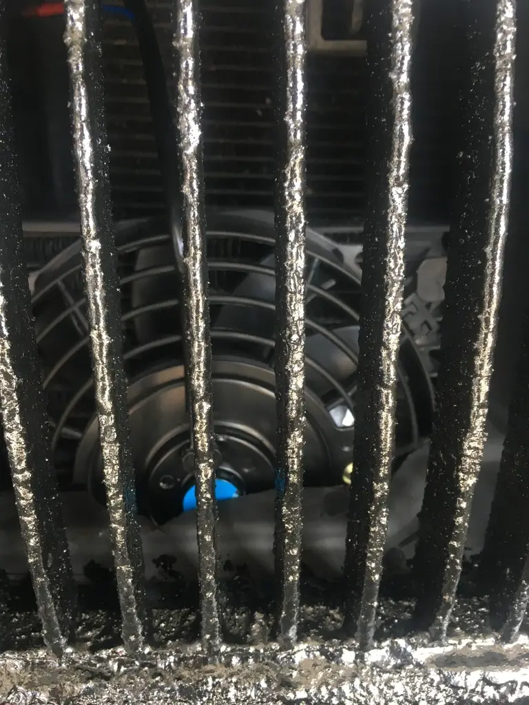

The fan and switch work great so I cleaned everything up and tested it out. Here's the fan with everything put back together
My first worry was that the fan being on the front would block wind and make the radiator not operate as efficiently as it did before while I was driving. So the first thing I did was cruise around with max a/c on. I rode around some back roads ranging from 35 to 65 mph and everything was working perfectly. So then I left my truck out in the sun (around 95 and sunny) for about 45 minutes to get it nice and hot inside. Came out, turned the fan on, then turned the truck on. The a/c got cooler noticeably quicker, it usually didn't get cold until I started moving down the road a bit but I sat for about half a minute and it got very cool sitting there. After that I decided to sit in the parking lot and see how it did maintaining the cool airflow. Sat in the parking lot for about 20 minutes and a/c never got warm. Overall this fan worked great and for 25$ and a few hours of time this was very much worth it as I sit in my truck in traffic and just waiting for periods of time.
