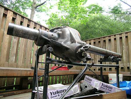

Sooo FROADER - got any d44 "C"s for me? :rolleyes:
Mine have acquired a "C" deficiency syndrome.
UPDATE & EDIT: won a set of inner "C"s from Ebay - item 8072285889
So ball joint sleeve issue resolved :confused: stupid thing :fire:
Here, this is the old inner "C" -----> C :shoot:
