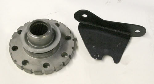

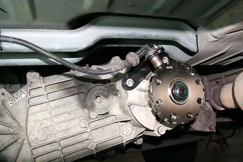

Since this is related:
Apparently someone makes an output flange for the t-case with in grooves for a tone ring. The pics below are on a full-size Bronco's transfer case so I dunno if these guys make output flanges for the 1345/4405s or whatever (give em a call, they might even be the same flange). But here's the contact info and some pics for anyone swapping out the Ford 8.8:
California PreFun
(909) 845-8820
Yanked from this DR build thread :):
http://www.dezertrangers.com/vb/showthread.php?t=74698
