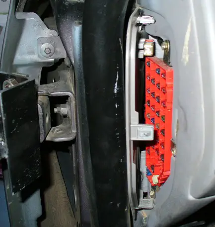

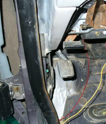

I snapped a couple of pictures just in case it helps. I think it was Jefe that said something about cutting the door panel to make room for the A pillar and access to the fuse panel, so here's what i have.
