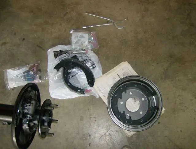

Finally got something done on the truck yesterday. I got the new u-joints in and the balljoints in the knuckles. I used a trick I found on BMX's sas thread that he had a link for. It worked really well. FOr the ball joints I just used the ball joint tool and they went really easy as well.
I also ended up doing the rear brakes. I had to go to the junkyard a couple of times because I didn't have the brakes to begin with when I got the axle so I had to start from scratch. This was the first time I have ever done a drum brake rebuild, but going to the junkyard and taking apart old drum really helped. Also the haynes manual was a good resource.
also that tool in the top of the pic was a great help.
After the brakes were on I got the hard lines connected and the e brake lines on. I'm using stock 88 f-150 ebrake lines on both sides. I have no idea yet how I will tie this all in, but I will figure it out later.
