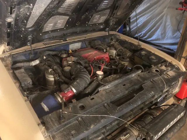

Pic of 1988 bii my wip
Went 5.0 in 2006 been using the crap out of this truck ever since
88 battery was right behind the headlight and the ol 2.9l airbox was on top of the pass fender skirt crappy location so…
Amsoil blue dry filter w pre filter
Round plastic abs sheet to keep the water and mud off and direct cold air around the filter
Next to headlight is a 3” round hole I cut feeds cold air right at filter
So I can just throw the filter on, fab up a heat shield, slap a hole in a spot to feed right to the filter, fun. More plans to the three mile long list! lol
