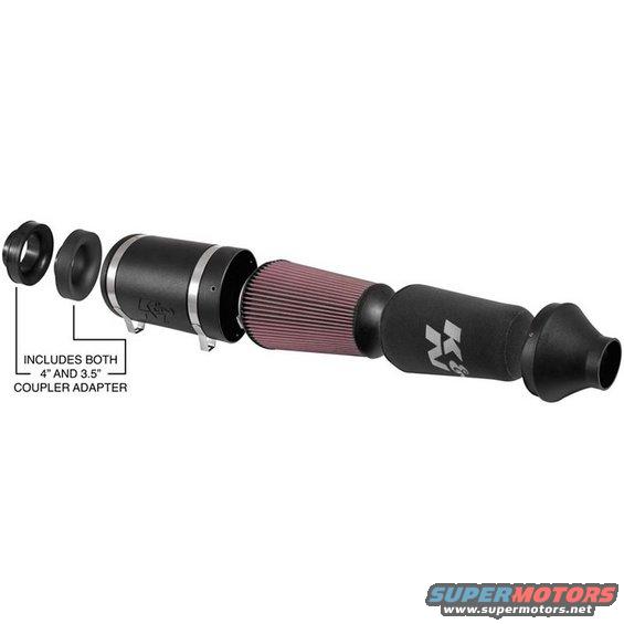

And opinions on the K&N CAI? Want to be sure that its setup is good enough to keep it from pulling heat from the engine, I'll do some searches too, but I figured I'd ask while I'm in here.

Most of the k&n parts my family and I have used so far are holding up pretty well, no complaints. But it's also a cold air intake, it's mostly similar to all the others, differences could be the tubing material and choice of filter mostly. Which this one is an HDPE tubing, or "strong" plastic like many other companies. But the heat shield around the filter is what I'm worried about mostly. And so far, most I see doing the same kit worry the same thing, think it'll be fine, if not I can always modify it myself.

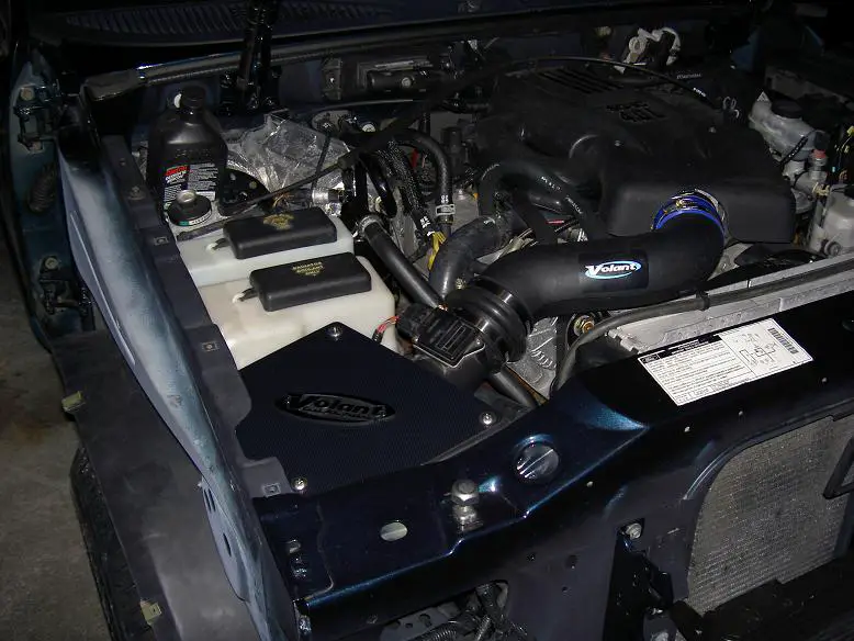

Volant 19640 air cleaner, obsolete;

Well, for starters, that's out of stock, they dont even sell it on their actual website any more. Second, that looks more like it's for a sport trac or a ranger based on the angle the tubing ends with by the throttle body. Otherwise it would be great
It was made for the Explorer, before the Sport Trac existed. I have it in my 99 Explorer. That should be the standard to match or improve over.
