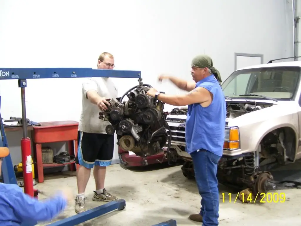

Old engine is out.
1354 manual is installed.
New clutch is installed.
new slave cylinder is in.
Waiting til morning to install the engine.

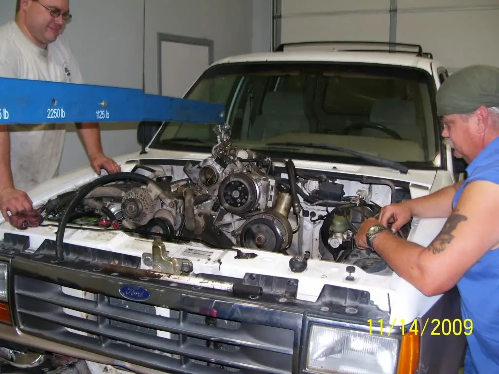

Engine install is complete! All went well, and Unclemike is happy as can be!

The New motor fired right up. No hesitations. Once it had started running, we discovered a small problem with the headers. These are a 4 pc header design. Their was a small leak in one of the connections. B2guy had fixed that in a jiff .
Bryce had this engine out in no time, all the parts swapped over from Mikes original engine, installed the new clutch, manual 1354 swapped in a total of aprox 12hrs. My hats off to these guys, they really work fast, and have a top notch shop to work in.

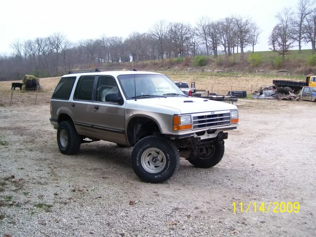

Mike is on his way back home and will be enjoying his rig a bit more now he has a running engine back in it.

Hey that's great to see the rig on the road again! Enjoy:chug:
Awesome looking explorer. That is good that the engine swap went smoothly... I can only imagine the headaches I will get when I do one myself.

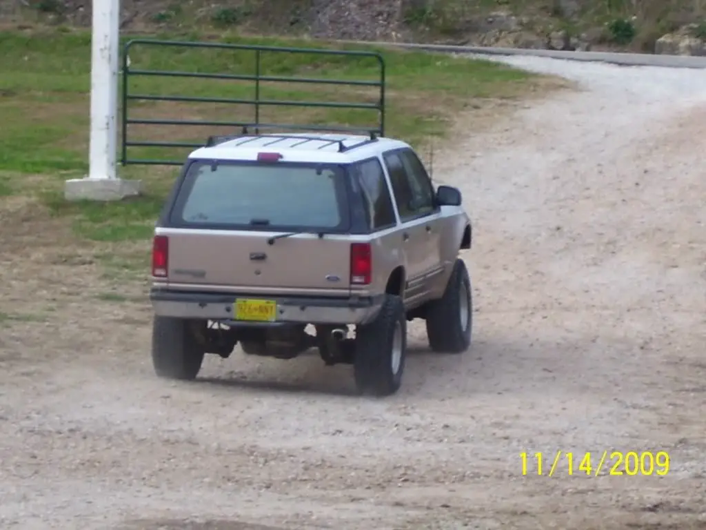

It did go smoothly, but still took about 4hrs longer than planned, if we wouldnt have had header issues and broken manifold bolt issuses, but other than that very pleased, and glad to have been able to take it for a drive, was very impressed with its ride and how it handled, amazed at steering radius for a 4dr! wow.
WOWZAAAA!!!!! It did go real good on the engine swap. Can't give Bryce and Brad enough thanks. Only having a exhaust leak after all the work and effort is just awsome. Plus the hospilitly (sp) of Brad and Bryce family made me feel right at home. The pics are great.

It took me 3 hours longer to get back on the same route I took up there, don't know how that worked out, no sleep till I got back, hit Ft. Worth at sun up and home around 815, then passed out til now. It was worth it big time.
Total of 1600+ miles, engine swap, manuel xfer, new clutch, numerous other items, getting to go with Gman to B2's and Bryce's, riding thru the woods with B2 (now I know why his motto is "rubbing trees is fun" ),now these things are pricless!!!
