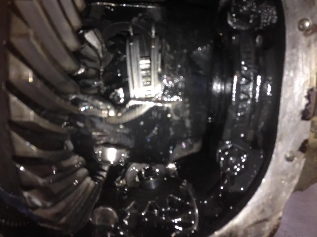

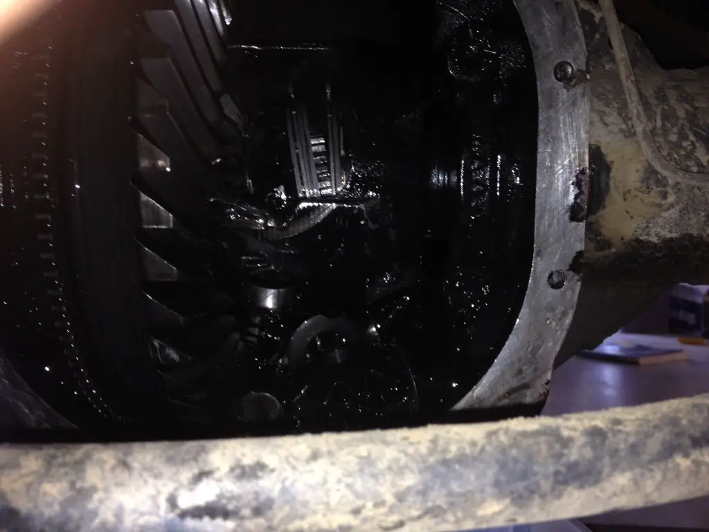

Well my buddy showed up and we started tearing into the drive train. My rear diff blew up, open up the carrier and just looks like a grenade went off in there. Gonna have to borrow a car from someone for a while and save up to get everything I need to get this back together. Pics will follow tonight.

Looks like that center pin shindig that holds the LSD together slipped outta the carrier and just went to town on the gears back there.
At this point I'm thinking if I get a car to buy I may just try to save up enough to throw a Detroit locker in the rear, pick up a new 4405(if my current one is shot) and put it all back together. Currently I have her sitting on jack stands with the rear drive shaft off, the jumble of shattered metal pulled out and the housing all cleaned up. Gonna spend some time underneath her cleaning her up and doing some house keeping under there too.

Yea, from what I could see I didn't see any cracks in the housing or anything. I'm gonna get under there tomorrow when it's cooler and really take a more in depth look. The drive shafts survived untouched, so I guess that's some good news. Gonna get the rear diff together first. Then see if things work with my current T-case.
Now, my currently Ring/Pinion is trash, so if the Carrier. Would you all recommend saving up to get a whole new aftermarket carrier and locker (do they sell them pre-built?) or should I look to pick up a decent one from the local Pick-a-part, then build off of that one. Obviously I won't be able to measure the previous gaps and such.
