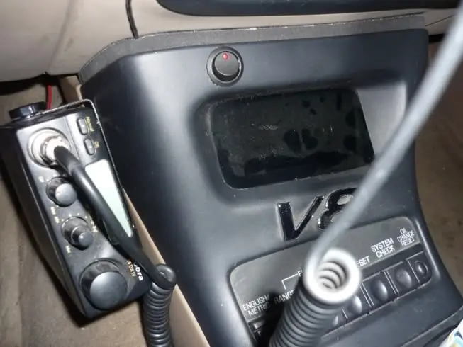

Hooked up an ABS defeat switch this weekend and mounted the switch in the center console. Later down the road there will be a couple switches beside it for offroad lights.
Besides that, not much has changed, she's gotten a few more beauty marks though. Next up will be a front skidplate/tube bumper with 2 kragen HID lights (probably 7"), and limit straps.

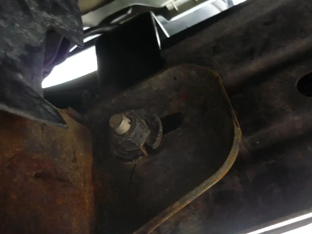

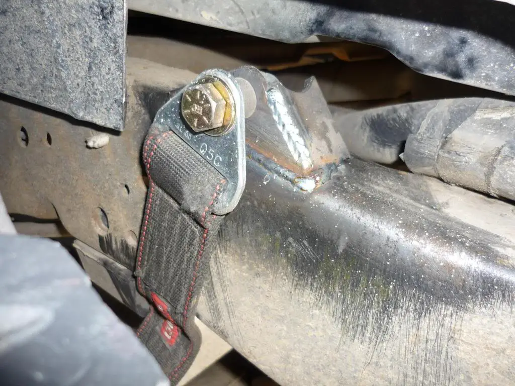

Next, I went here to have limit straps installed.
They're 10" in the front and 14" in the rear. I could have gone with 12" in the rear but i found these at the swap meet.
Front:
Rear:
Because the rears were slightly too long, Brandon made that little boxed in tab which i think was a cool execution, and to lower the cost he just used the traction bar mounting tab on the axle. I recommend Brandon at BTF to anyone in the area, he's the nicest guy and as you can see does great work and does some nice looking welds too.

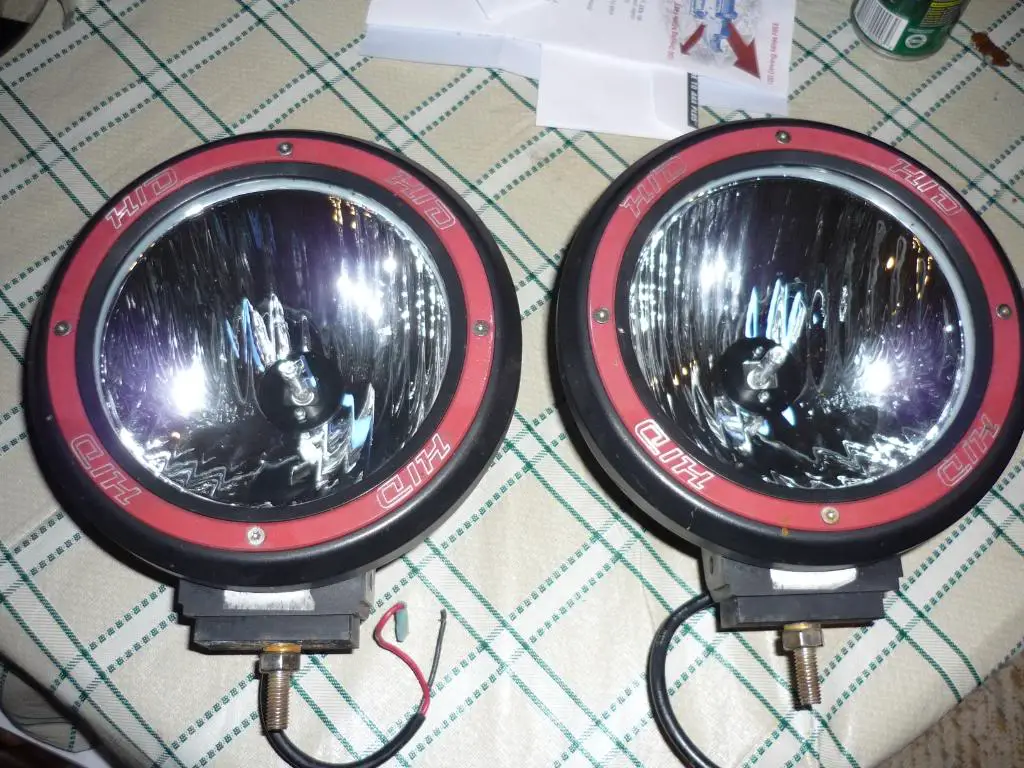

Then tonight i picked up a pair of Kragen 7" HID lights:
They're only 35watt, so my plan is to wire them to the stock foglight wiring so i can use the factory foglight switch as well. I've been told that should work fine, but if anyone has some input on why it wouldn't, feel free to share.

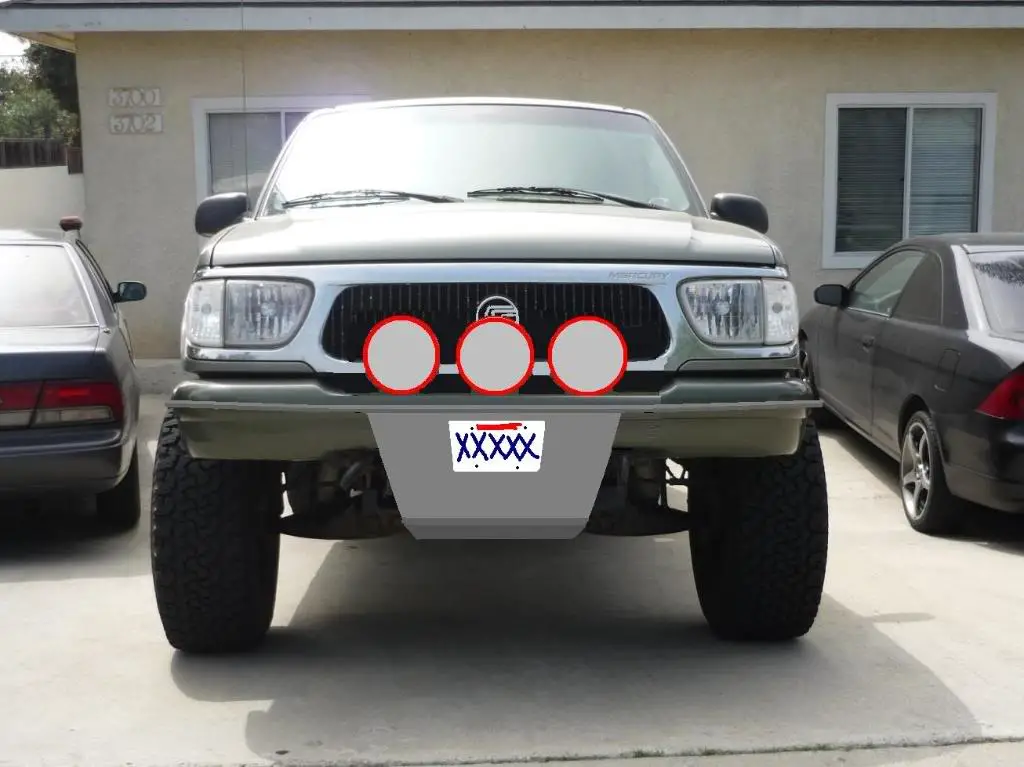

Eventually they'll be mounted up to a skidplate/lightbar/bumper which will look something like this:

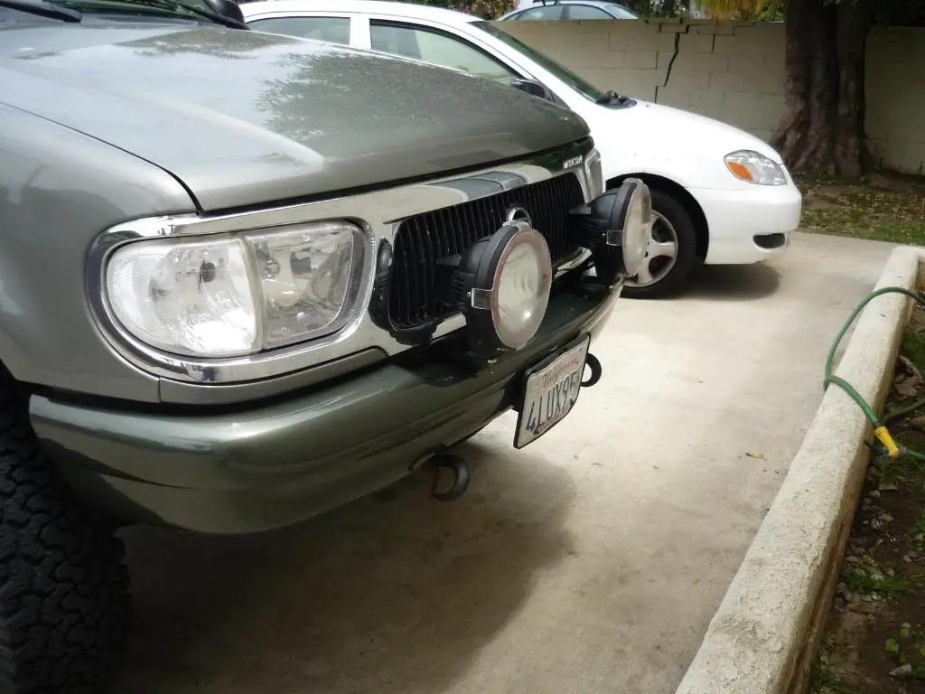

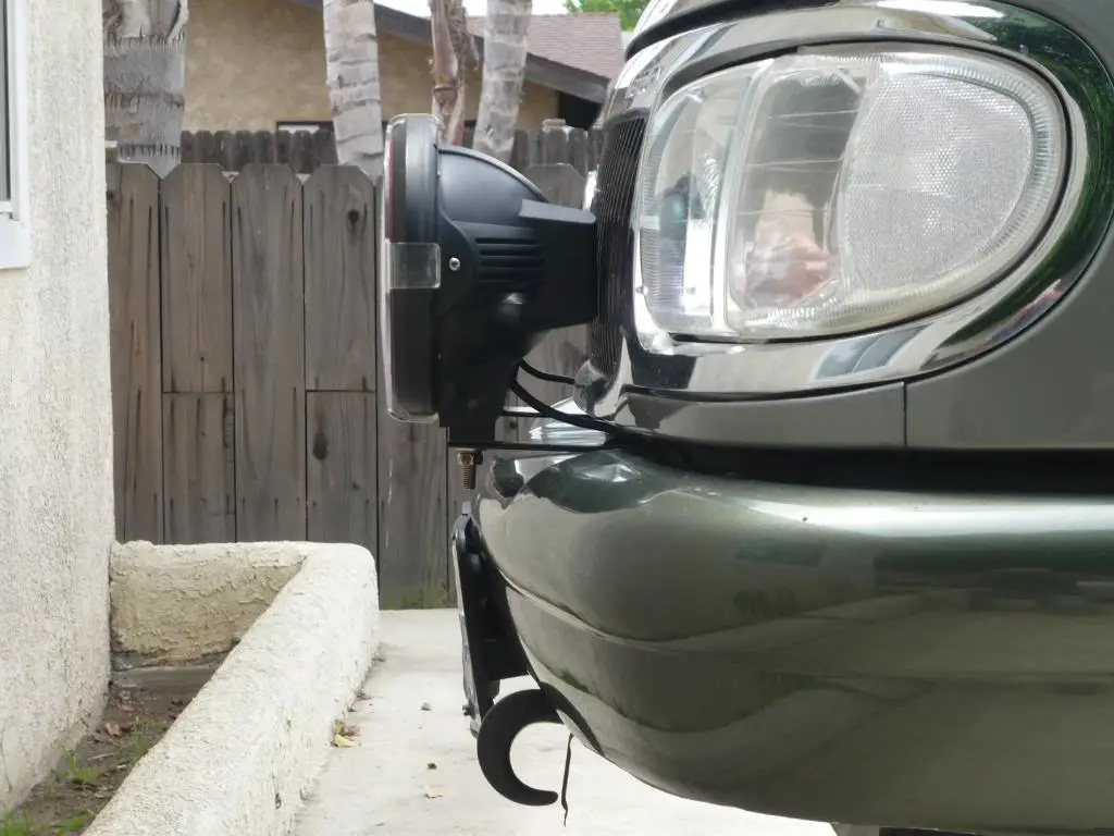

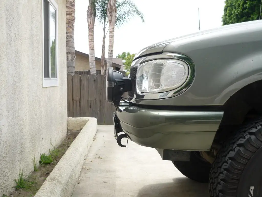

Finally got my HIDs wired up and mounted last night, these bad boys are freaking bright! I used the stock fog light switch, and they're wired in after the connectors so i can take them off easily for daily driving and not worry about them getting stolen. The clear covers look foggy on the bottom half because they guy i bought them from had them on a roof rack and painted the bottom black to prevent glare on the windshield. I just sanded off the black paint and then polished them a little. A friend of mine fabbed up some brackets that use the bumper mounts as attachment points. These mounts are somewhat temporary until i can have a bumper made like my MS paint drawing above. After mounting the lights i also did the 'fog lamp mod' which allows the fogs to stay on when the brights are on, something i've been waiting to do since i haven't had any fog lights for the past 3 or so years. So here are some pictures:
I'll take a couple tonight to show how bright they are.
