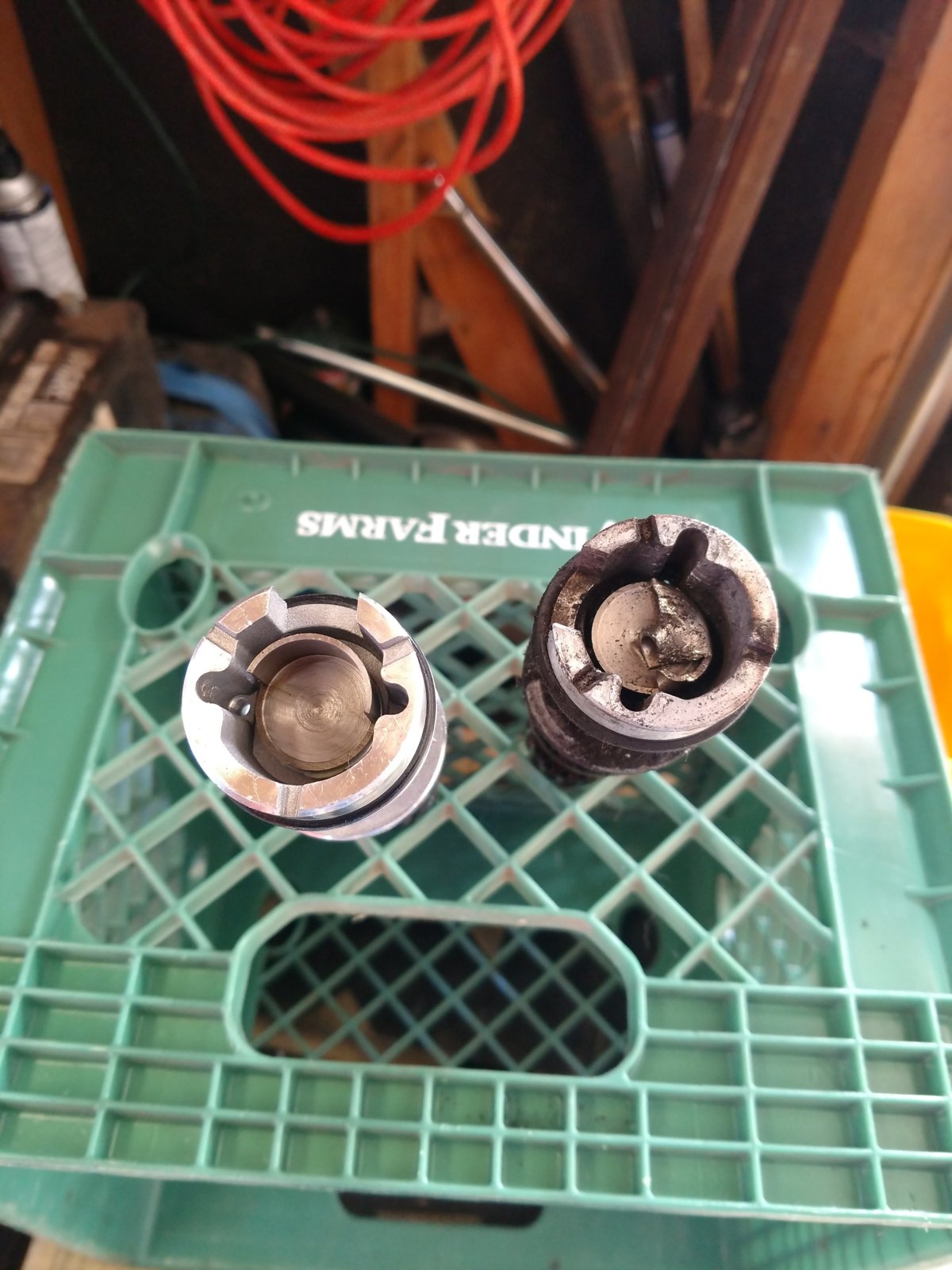

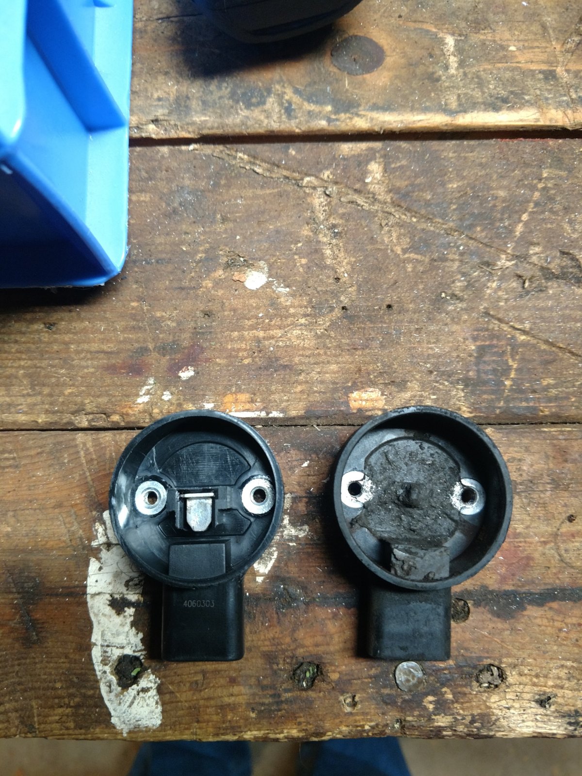

Well I got my Camshaft Position sensor and was about to replace it. Got the Top off and was About to put on the new one and saw that it would Make no difference if I had. The Synchronizer is bad.
The Difference in Sensors
Not sure if you can tell the Difference between the Good one and bad one LOL
So I have to replace Synchronizer :-( Gonna be ordering that now to get my Girl back on the road again. Forgot to get picture of the Synchronizer but when I get new one and replace it I will get a picture and post it. Not sure how my Explorer was running after I saw how back everything was.
