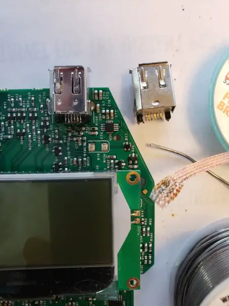

ok, so a quick look at Tim's sct and I could see the pad that goes in-between the connectors on the firewire input was missing on mine. That would explain the 'shorting out' on the pins.
It's a surface mount connector.
No luck finding one locally, so I ordered from Digi-Key. I hope shipping doesn't take very long.
Lets see if my old eye's and shaky hands can still do this stuff.

I think the 'shorting' of that connector hurt my wideband. It seemed to be reading way off. I actually asked Decipha for help thinking it was my Tune I couldn't seem to dial in (Wideband and narrow bands were conflicting, confusing the crap out of me). I'll try to get to this tonight.

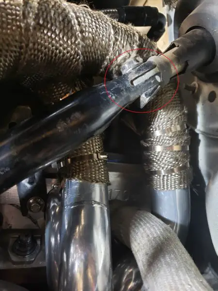

I also had an issue with the drivers side header fitment. It was too close to the steering shaft and the bolt and nut were binding against the header when turning the steering wheel. It was actually so bad, the steering wheel did not want to turn at all. I had to grind down the nut, and both sides of the bolt. I think Bob's jig must have been off when this header was made.

Man, that is a bad spot for clearence issues too. I really do not see a way to change that bolt location up, w/o modifying the steering shaft in the column itself.
I wasn't very happy about what I did.
I was so unhappy about what I was doing, I plunged the grinder cutting disk in to my thumb. No need to ask me how that felt (feels). I'm sure you can imagine.
Now, I have to be very careful till my talking thumb seals up. Anyway, I sure showed that header I was pissed off. lol.
I didn't have much for options. I could have emailed Bob the issue, and he could build me another header, and delay things at least a month, or do what I did. I used some loctite on the bolt, just in case.

Short of replacing the header, a 1" body lift would help, and give extra room to work on near the fire wall, but that goes against the grain of a street build. But, it would allow for some larger aggressive winter tires.
