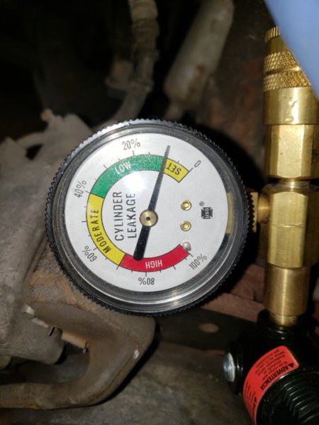

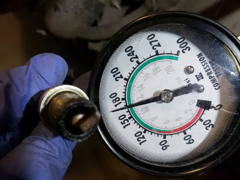

I have an unhappy motor... Is anyone really, truly surprised? Some things just are not meant to be.
Iv'e been pre-fogging the neighborhoods in anticipation of mosquitoes. Blue exhaust.
So, the trouble shooting started.
#4 plug looks very oil fouled. Compression looks good.
Leak down....Looks great. With the valve cover off, I can hear hissing at the valve seals. Oil is obviously entering from the valve seals.
I'm going to need to replace all the valve seals with a different style of seals. I'm not exactly looking forward to it, its going to be a back breaking, slow going job in the truck.

How were the other cylinders, did those plugs look just as bad?
To replace the seals you usually put compressed air into the cylinders to hold the valve up while removing the keepers/retainers/valve springs etc.
Once you get the spring off, you could hold the valve stem up, pull the air out of the cylinder and then wiggle the valve stem to check for excessive valve guide clearance just to make sure there isn't anything going wrong there?
Of course if the seal is damaged from the spring hitting it or something, then maybe that's all that is wrong with it?
And at least the compression is good, that has to be a relief.
Hope you get it corrected without too much loss of sleep!
