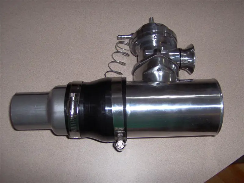

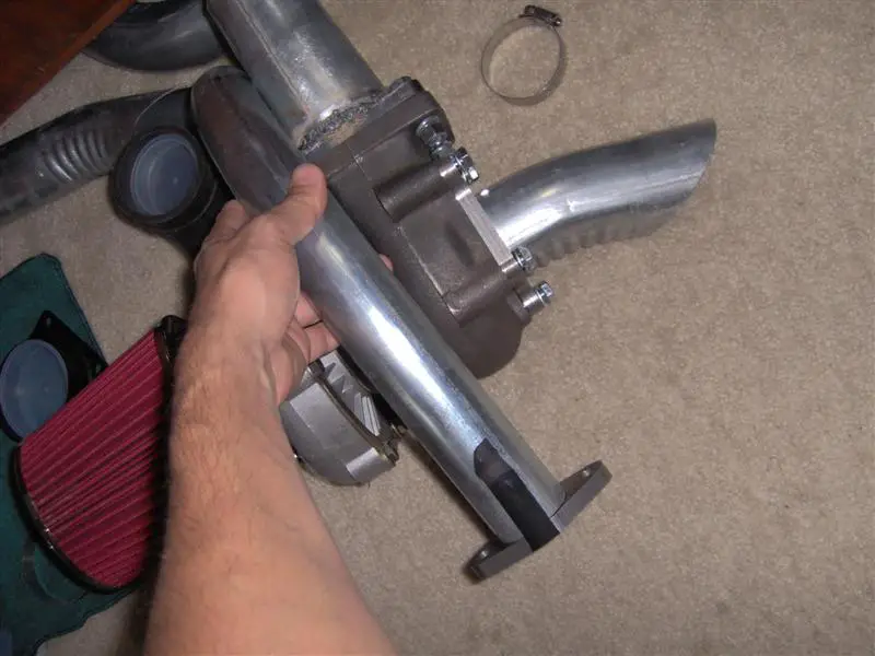

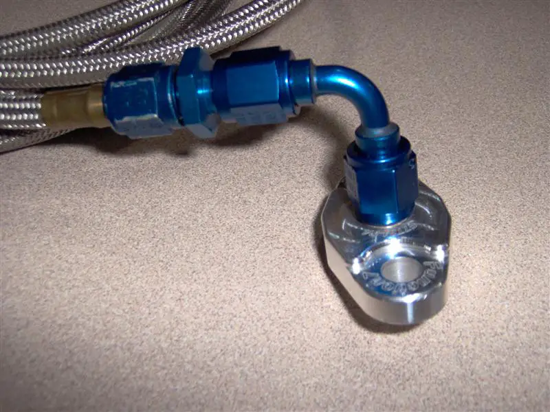

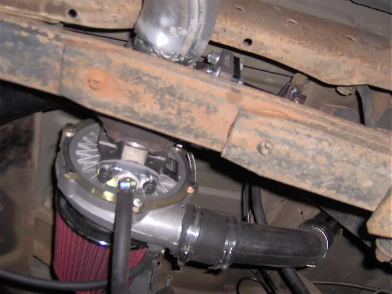

Here are a few more pictures....
The first is the complete oil feed system. Second is the T added to the oil pressure switch. The third is the Function 7 oil inlet. Fourth is the BOV adapter and couplers.
In the 2nd picture, you see the true -4AN fitting(blue) vs. a hardware store flare fitting. The only difference is that the true AN fitting has a 37degree flare while the hardware store flare is 45degrees. Depending on the oil line feed hose(nitrous hose) you use, the hardware store piece will seal just fine. I just chose to use the true AN piece.
Another thing to know is that JIC hydraulic fittings are the same as AN fittings. So you can have your oil feed line made at most auto parts stores.
The T on the oil pressure switch is plain 1/4 pipe thread. All of the pieces came from Home Depot. I just to put it together with a new/clean oil pressure switc, because it was only $11, and I wanted to double check the thread size.
