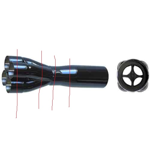

Moving the collectors to allow better space for the merge point is a compromise I'm willing to make. I'll build mine from the back to the front, so the down pipes will be no issue for me to alter when needed. I've been hunting some for a merge collector section, to build onto. I want a merge point where the four pipes come together, to be a little under 2.5", say 2.25", and then expand immediately back out to 2.5". They make that for most sizes, but unfortunately the prices are in the $250 range, each. I'll have to adapt something else which at least has the four 1.625" primaries coming into each other at a proper angle. They need to be angled, not parallel, and not too sharp like the OEM collectors which look easily to be 45* or more. That angle should be mirrored on the other side where the tight spot opens back up. I bought something from Summit which was supposed to be that design, for $49. But it was an entirely different part, the pipes were all parallel with no narrowing merge point.

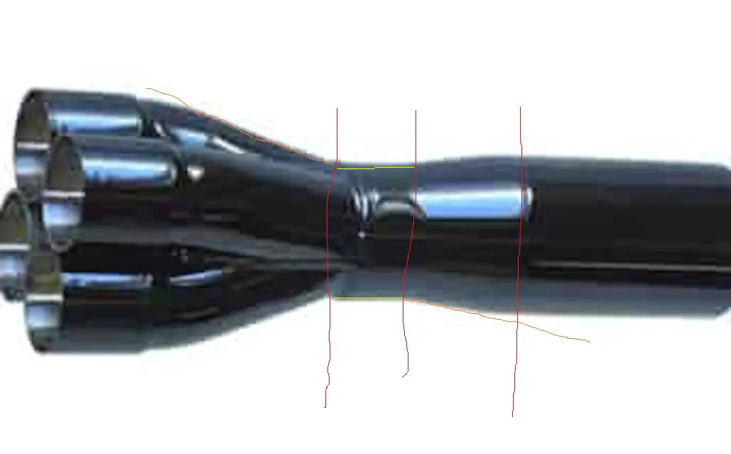

I played with that picture but didn't hunt the ideal merge collector picture. This pic is decent to explain with. Below note the yellow lines I made, that flat(parallel) section should not be there, the pipes should come down to a narrow point, and then immediately open back up, to the end collector size.
Note the orange lines, those are the angles of the pipes coming together. The pipe after that merge point, should open back up at the same angle, see the orange line I made on the other side where it expands. Those two angles should be the same, that is for maximum scavenging. That is more valuable for power than equalizing the primaries. Skip the primaries, ignore the lengths, make them whatever it takes to fit them easily and well into the space. The merge point is far more important, the OEM collectors are terrible, and the TM headers copied them.
