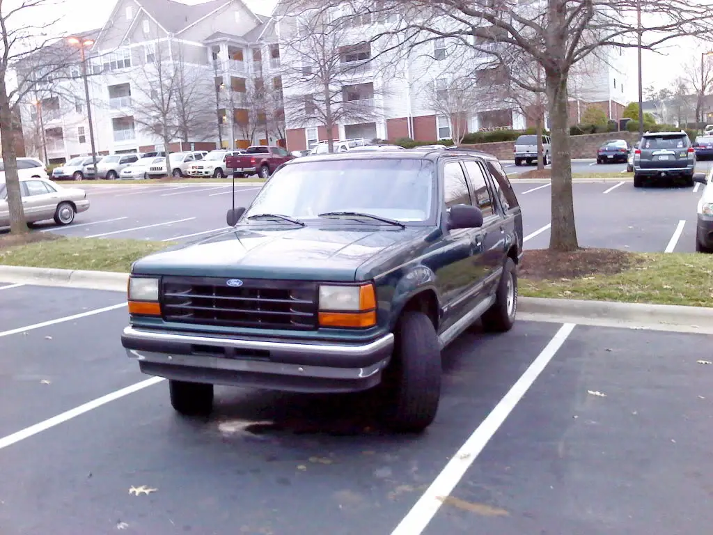

Right when i got it
This was after i painted the front grill bezels and re coated the signals too.

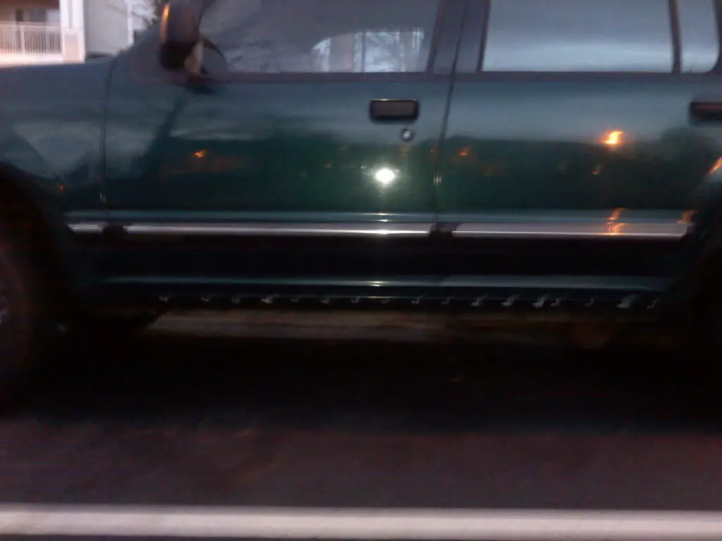

Anyone have any suggestions on fixing a rust hole?
How do you remove that bottom trim? (without breaking it)

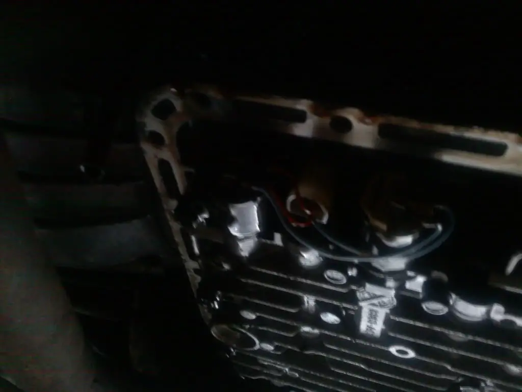

Removing the valve body

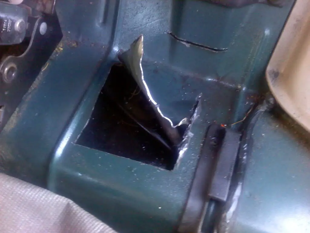

Cutting an access hole

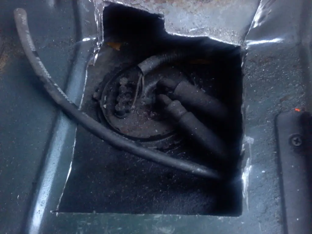

Currently waiting for some $$ to replace the fuel pump battery and buy the tool to remove the lines.

The bottom trim is held on with plastic push clip type things. All I done with mine was pull on it. If you will look on the front piece you should see them. Just take your time and pull them.
I would expect to see a lot of rust,

First things first. I sold some stuff and bought a battery charger and charged my batt. I traced my no start problem to either a bad ecm fuse or a bad ground. so After cutting a hole in the floor and buying a tool to bench test my fuel pump. I patched the hole with some silicone so when it does go back i can rip the panel off to get to it.

I used hardware store 2.50 black gloss spray paint and i just sanded the grill and bezels down and coated them 3 or 4 times with the black and coated it with 3.50 can of ace enamel clear coat... and i sanded the turn signals and headlights and re coated them with clear coat... I have heard of a dealership that does this to foggy headlights..
Like the front end look and its what I think I am going to do. The black that is. I also need to get around to filling the bottom holes from the ground trim and then bed line it also just been waiting as I would rather paint the truck first but it just seams like every thing keeps pushing that back father and father from getting done.
I will be interested in how well the clear coat holds up on the lights also as I know mine clean up nice but then get foggy again kind of fast but may be best to just change them as I also get a lot of moister inside of them also.

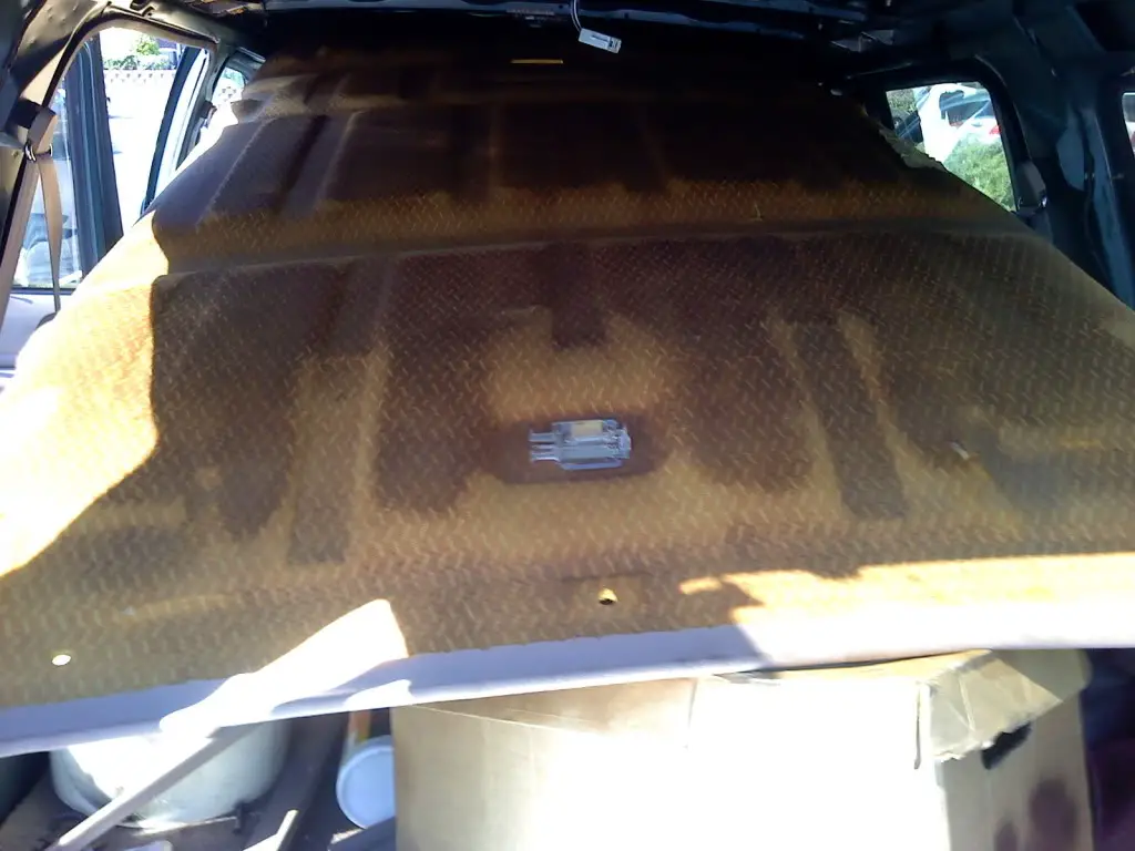

So for the past two days i have been tearing the interior out of my explorer due to the fact that im tired of getting it dirty and the headliners messed up and needs redone so i figured id get it out of the way... here are the pics
right before i pulled it out...
Pulling it out of the Back cargo bay....

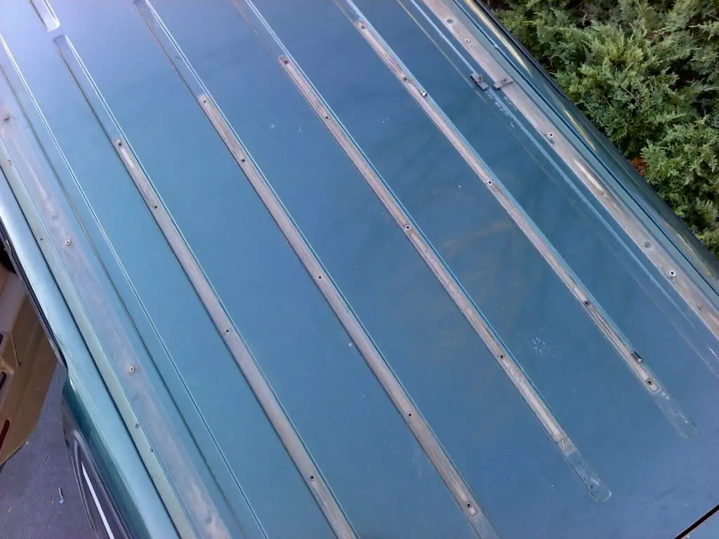

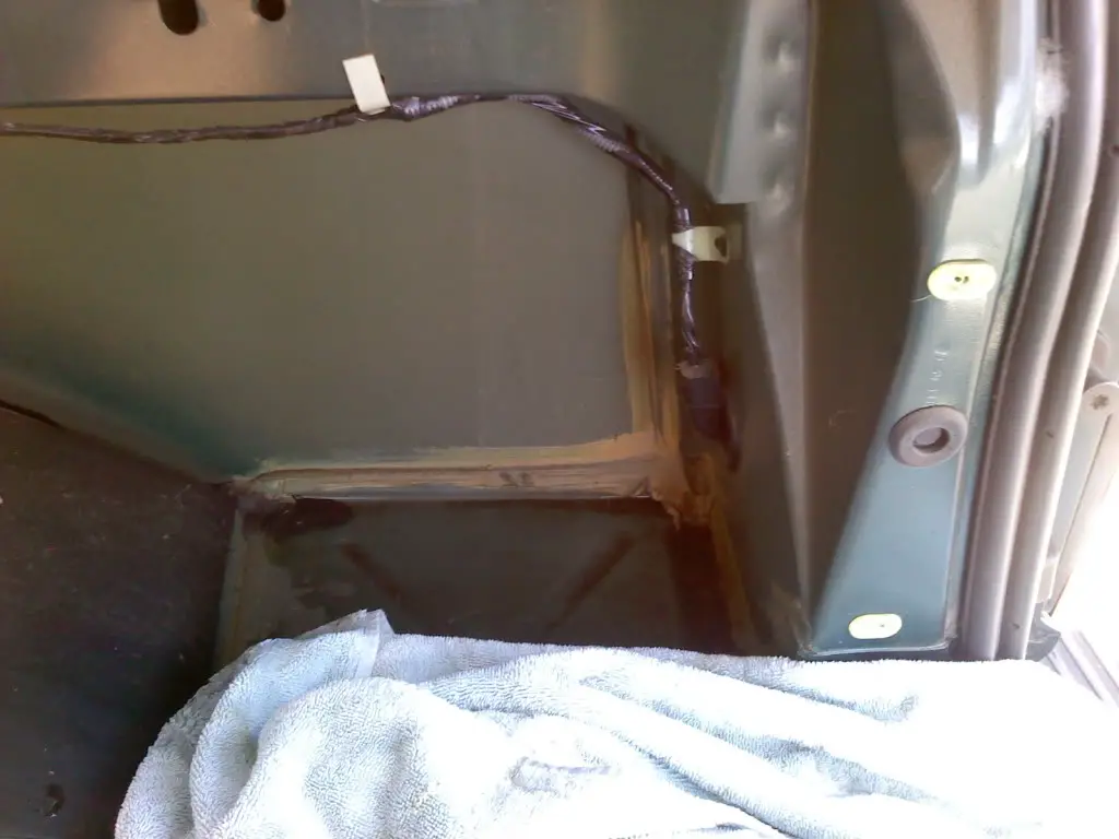

a nice clean interior roof.. I also used a t50 torx bit to remove the seatbolts so i could pull the interior panels off and then i rehung them Now I had a good opportunity to remove the roof rack track and the part of it thats riveted down (forget what its called) i just used some mini bolt cutters to break off the rivets and for the tracks previously when i tried to remove them they were seized but on the inside there are the bolt side... I just used a 8 mm socket and loosened it and it broke the screws free.
BEWARE
if you remove the roof rack etc. You will have holes to deal with. I just used expanding foam for now until i can put some teflon tape over them.
if you leave it when it rains you will get water inside.

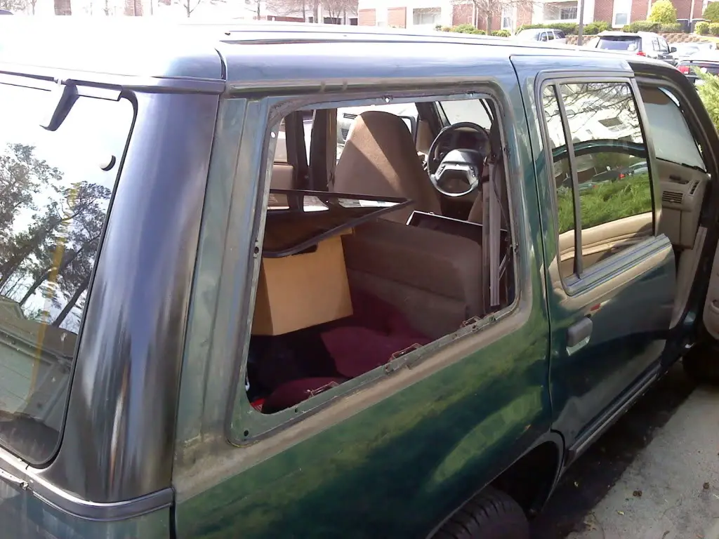

another thing i found was this:
Somehow the side fixed window found its way loose and leaked (it rained 3 days ago) and i had a nice puddle in the back of my x. I just tightened the bolts on the window... hoping that was it.

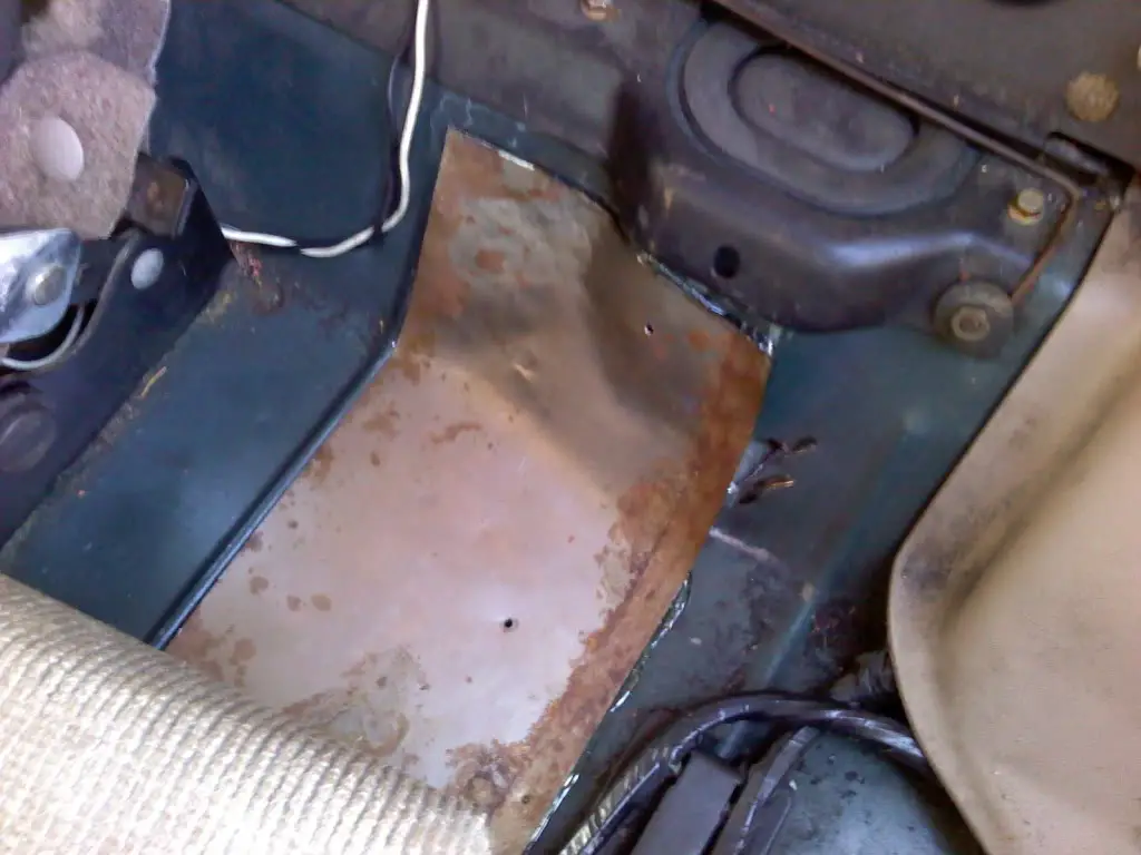

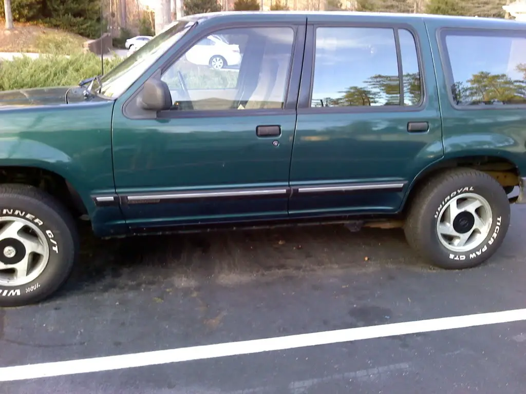

Just got the bottom rocker painted after doing some sanding and some prep still havnt done the other side and idk when ill get to it so until then..

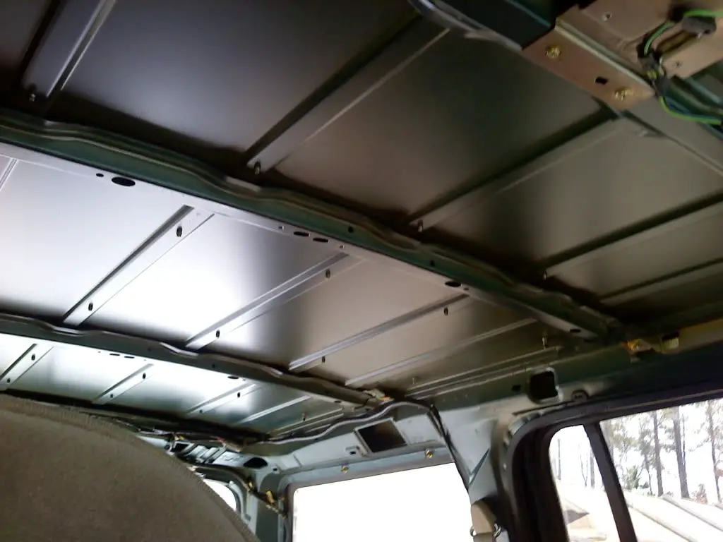

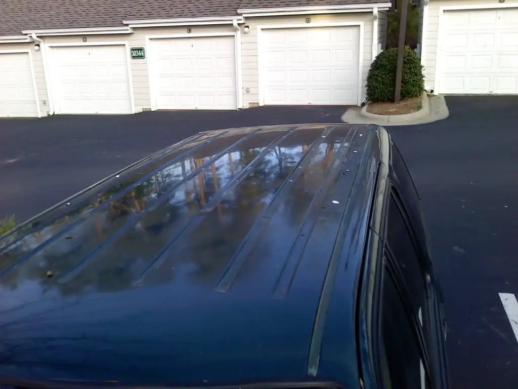

After all that work this is what my roof looks like:
cleaned it up some and NO RUST WOOHOO!
And if anyones wondering a dog supposedly was locked in the explorer and wanted out and scratched the headliner. and this truck was previously owned by a lady... who figured

Well I have been very busy. being that im only 16 without a license and no job yet Its hard to get money but i have sold some stuff and got the money to do a soft rebuild on the transmission. I have read Glaciers diary and i have downloaded the manual to rebuild it. So at this current point i still have the transmission in but Its 4 bolts from being out. here are the pics:

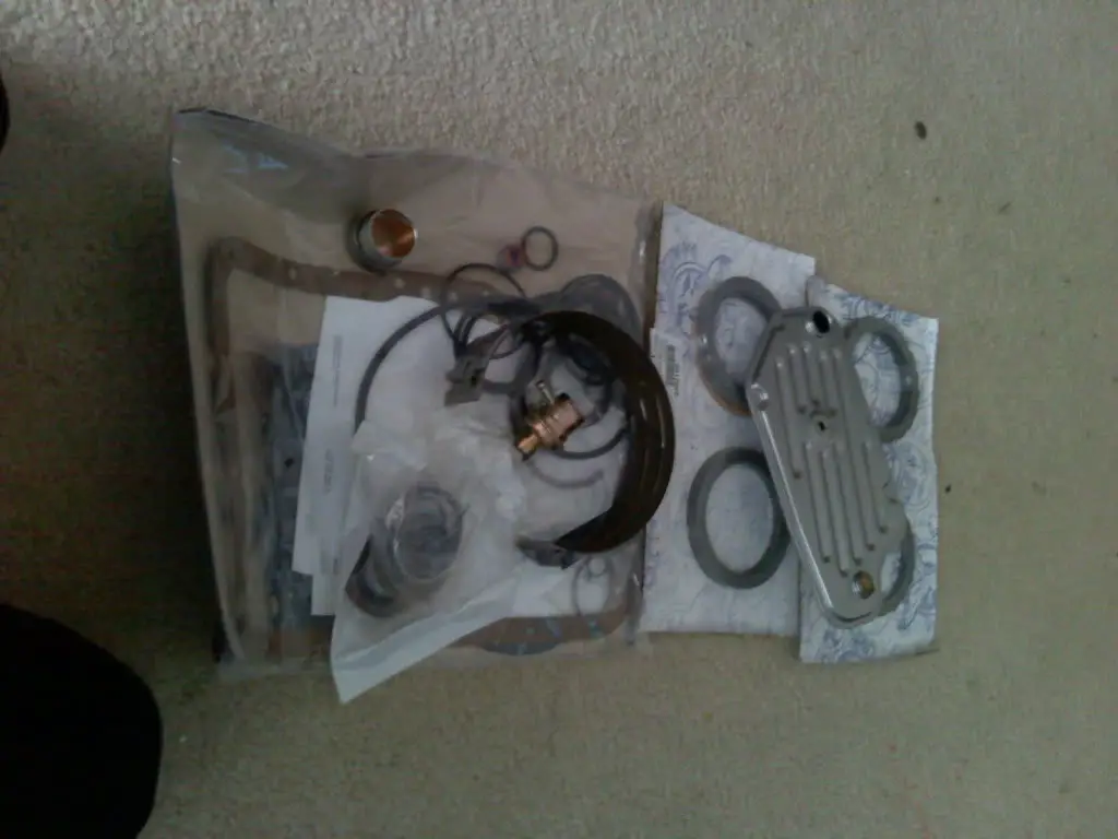

master Rebuild kit

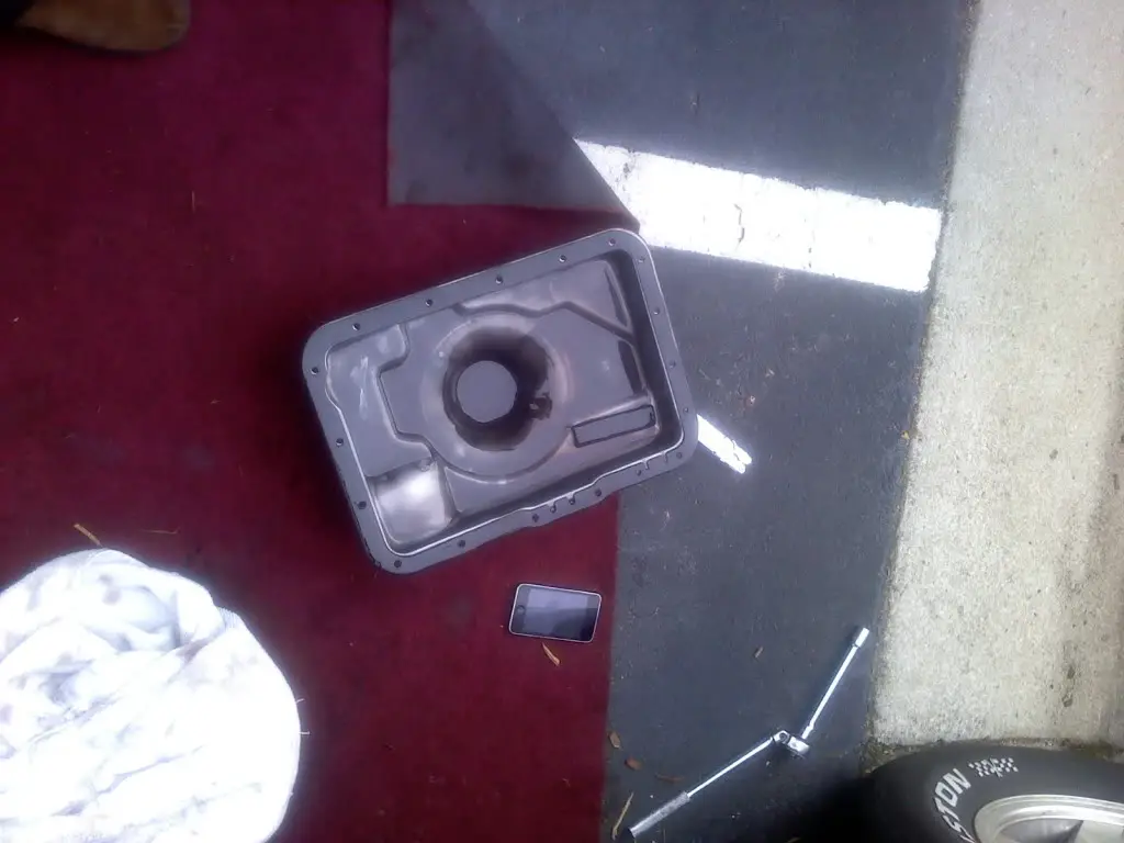

Pulled the pan and look at all the shiny glitter!!

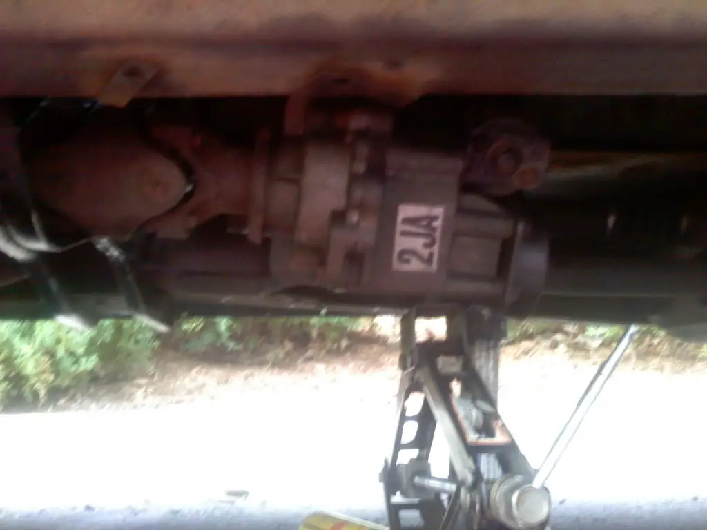

Dropping the transfer case
Almost got the tcase out.
That about does it for the big Ticket updates but on another note I fixed my leaking window problem, The actual problem was a part of the passenger side window gasket wasnt sealing and causing a leak. A little bit of some acrylic Sealant Fixed that.

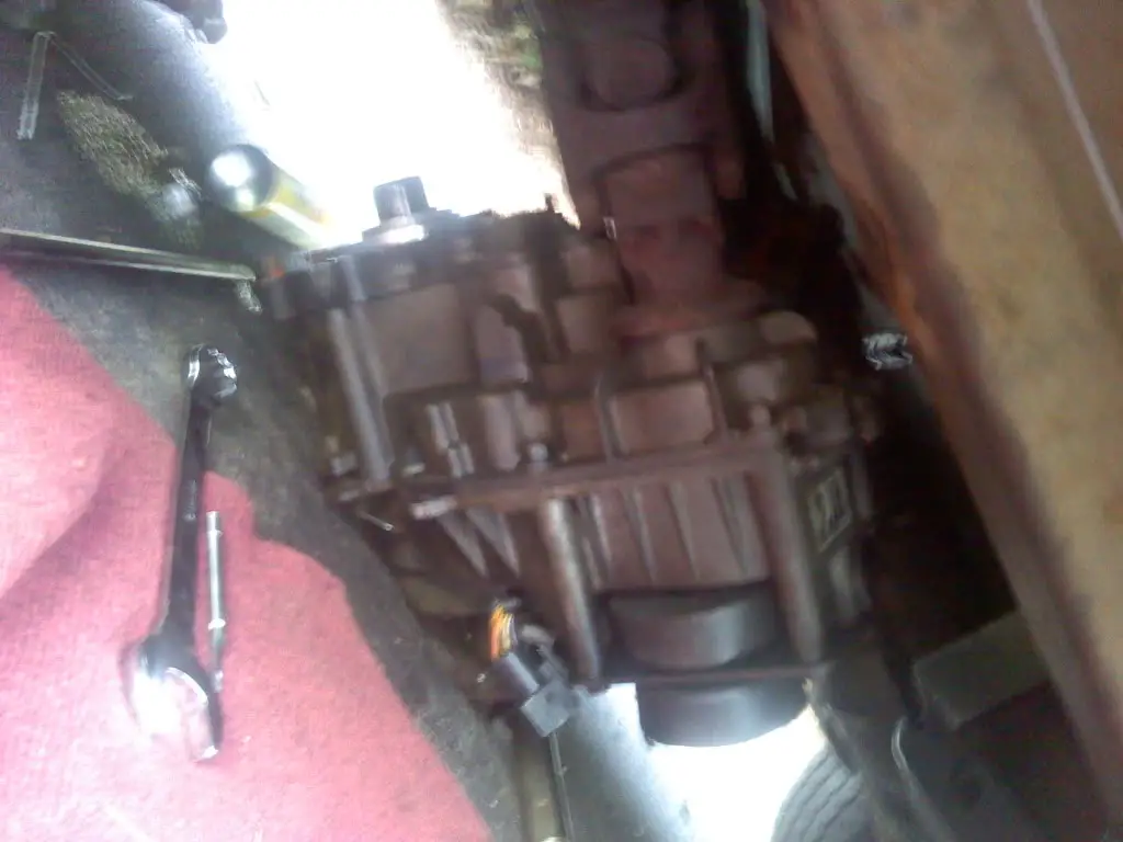

My transfer case after i took it out.
