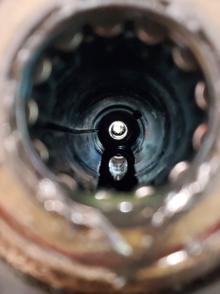

Friday night party..
Hmmmmmmm:banghead:
that axle tube is bent!?!?!
No, just installing the tone ring, and thought it would be a cool picture looking across the housing..
Those are fun, the bearings that is. Before the slick tool everyone has now, to pull axle bearings took some thought and plenty of spare parts.
That axle probably is bent. The passengers side was seized in the housing last time I took it apart. I had to get creative to get it out.
The passenger side, pulled out ok. Had to pry it out a bit, but nothing crazy. Going back in, I had to tap it in the last inch or so.
No worries, it's not staying under there in the long term.🤷‍♂️
