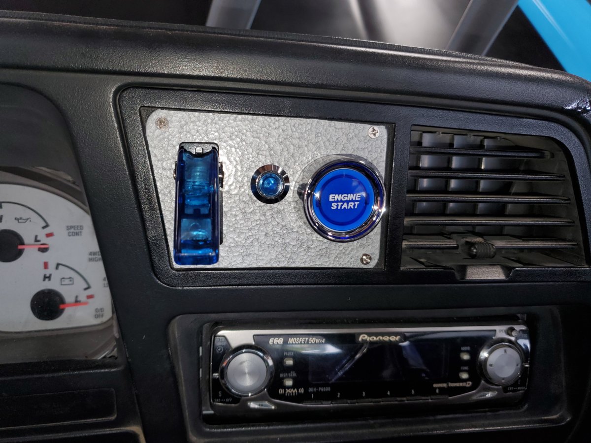

So nobody likes push button start buttons... Meh ok.

ooooh la la I like pushbutton starts! Especially when your rzr is about 22 miles from the truck and you lost your key (wife)!
The next trip out we have pushbutton starters...I did not know they made them in blue! Nice touch.

The push button start will still take a key... because PATS :rolleyes: but it's more like a key fob now, as you don't actually need to turn it in the key way.
