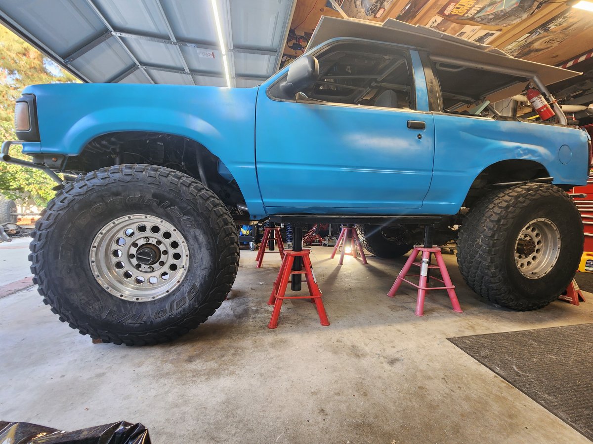

It looks so good 🤩
Looking really good. Late 2002, 2003 and up 1 ton Ford truck are where the axles from? Will you have to come up with or make different driveshafts?

Dana 60 and Sterling from a '03-04 F250. They are actually axels from @Dannyboy old super duty, which originally were meant to go under @FROADER Club Wagon. Now they will live on again here. I will need custom driveshafts. The front diff is just sitting there for now. Not attached. I'm going to 3 link the front. I would look at my other build, as that would give you a better idea then this on a 2nd gen truck.

So I have calculated the weight change
D35 + 8.8 on 35's to D60 + Sterling on 40's
415 lb gain. Not bad really
These things get heavy. Mine was at 5000lbs before the D60 rear end. Still on 35s and D44 up front.
JP weights 5300 lbs. My goal is 4500 lbs or so for this.

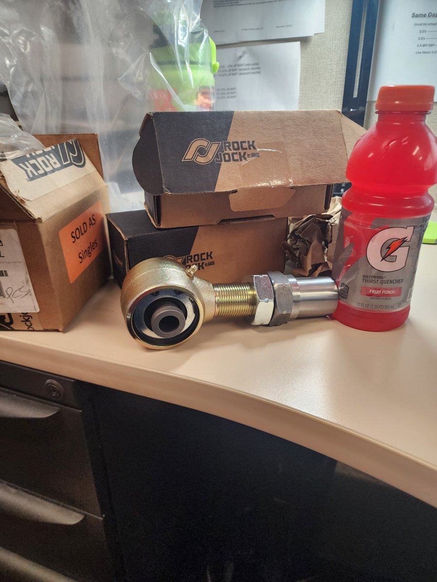

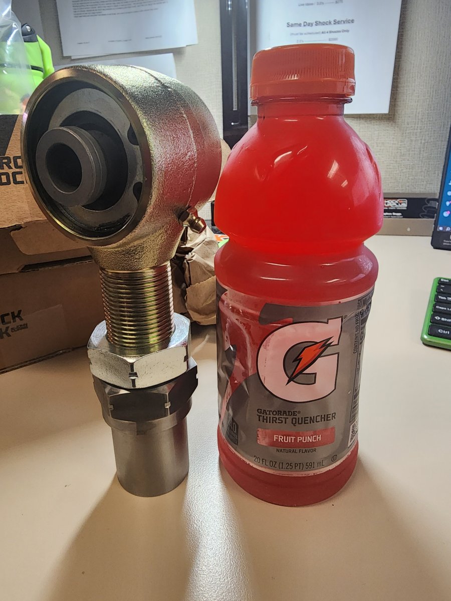

Dang that's beefy!
Massive, ought not to break that thing.
I was going to just run 1", but 1.5" was not that much more. So links will be 2" .250 wall tube. 💪

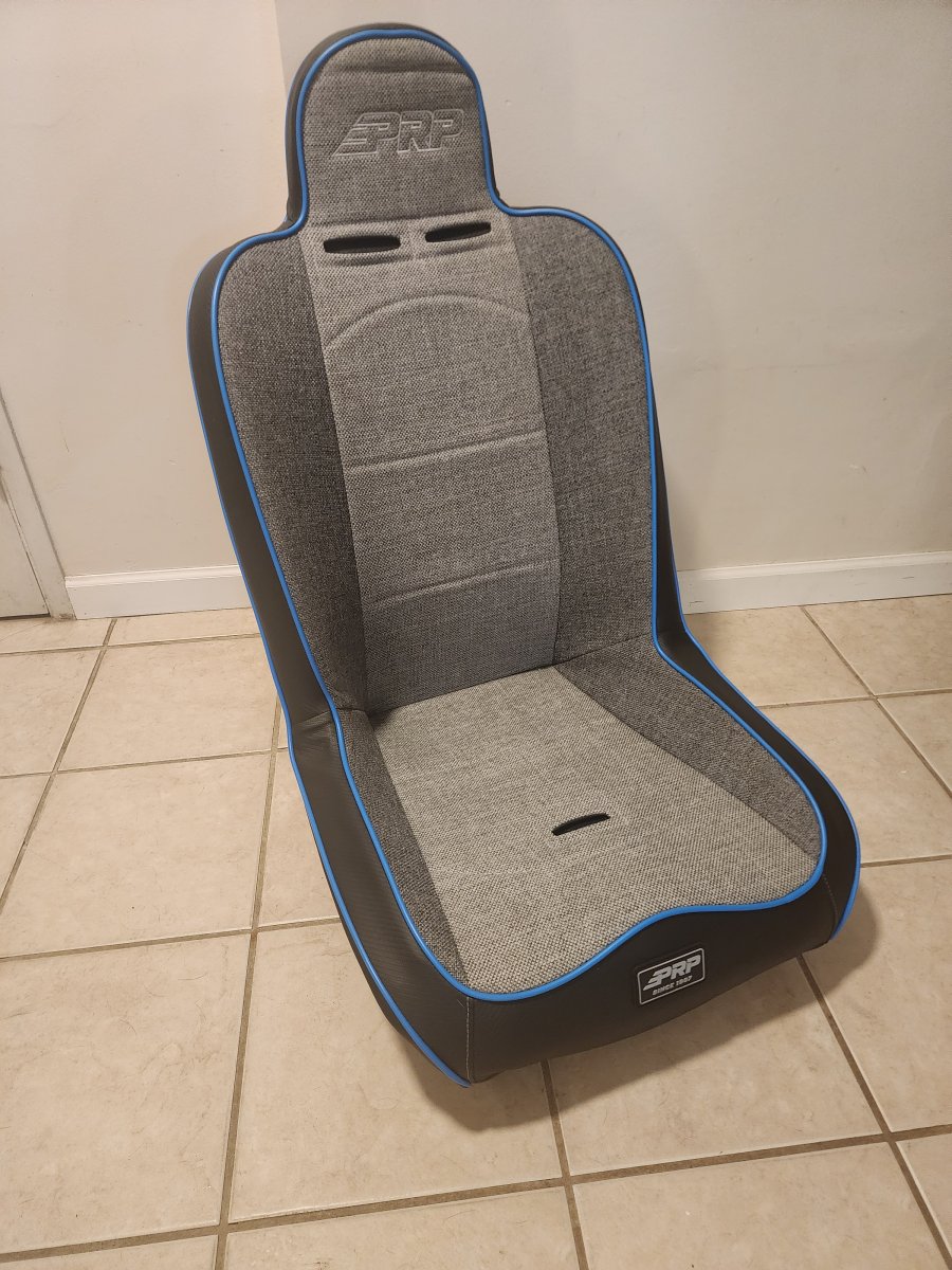

Now I really need to get this done....😎
Yes, they are heated.
