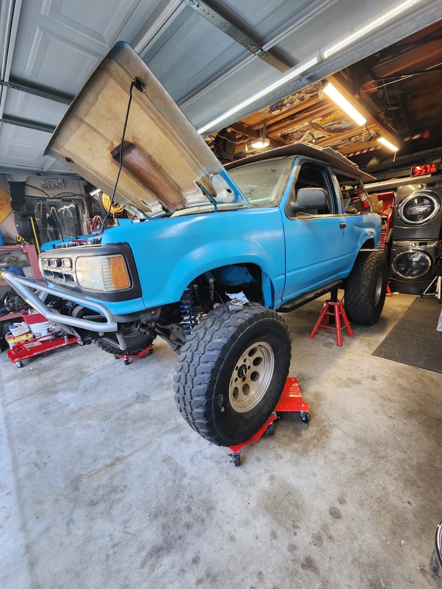

Any idea what the difference in weight is? What is the width of the 37s and 40s?
They are actually both a 12.5 tire. Actual width is different for sure.
The 40's on these old Stonecrusher Rims are 115 lbs.
My 37's on Steelies are 125 lbs. last time I checked.
I need to double check that, but it's pretty crazy.
The 40's are a full Race tire. They are not DOT legal. But I got a good deal, and there is a lot of tread on them.

mustve been fun watching them balance 40s, eh? and when i thoight 35s were my eventual goal...![]()
They are not balanced. They could not do it. Would not fit on the machine.

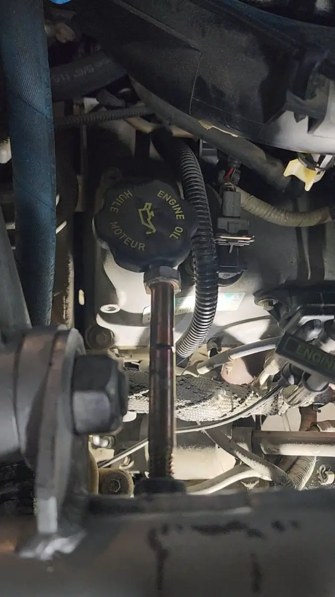

Order of Operation is important.
Maybe engine swap then Suspension was not perfect idea.
Top coilover bolt runs right into the oil fill on the valve cover. Had to cut the bolt off.
If you need the full length of the threads couldnt you pull the valve cover and weld in an angled extension tube to place the cap farther inboard?
The bolt was way too long to start. Robby just threw what ever he had in there it looks like. The rear shocks were the same. Extra spacers and mismatched bolts. I get it. You gotta do what you gotta do, and if it works
This is the last of the original truck, other than the body and frame. So not worried about anything else, that was done like this.

I’m sure you tried taking the cap off? Lol lol looks like there maybe some more wiggle room with the oil fill cap removed
I still needed another inch or more at least. I just cut the bolt off with a grinder. Bolts are cheap and it was way too long anyway.
