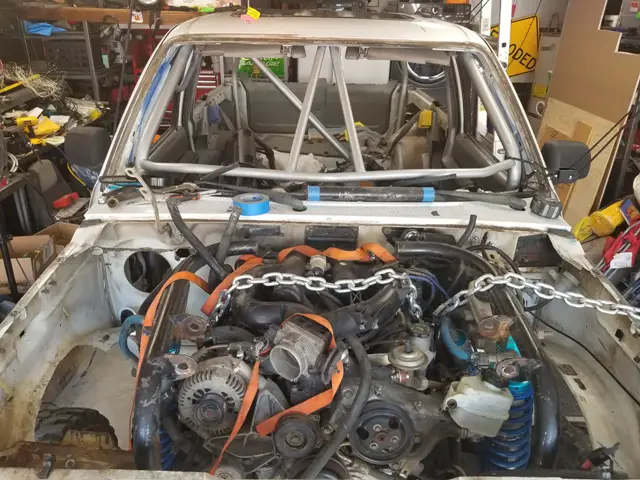

Swapped the OHV engine mounts over the SOHC, and we were able to drop the motor in half way before we hit a snag. The accessories on the motor are to wide to go in with the engine cage. . Other then that we were able to get everything thing to fit with the engine cage. So I'll have to pull the A/C pump and maybe the alternator, but it looks like it should be good then. Once we get past that we'll see where everything else lines up.

SOHC IN!

It fits, and actually pretty well, I would say better then expected. First I had to cut the back of the Engine cage, and will have to modify before going back in. Front one will also have to be modified. There are also a few other thing with the engine cage like hoses and the power steering reservoir moved a bit.
No as far as just a general fitment of a SOHC in a 1st gen, because I know that's all what your dying to know.
  • HAVC- There's no way to retain the 1st gen from what I can see. The Valve cover is literately in the middle of part of it.
  • Oil Pan- The passenger side is barely resting right on the TTB bolts, but once the trans is attached and the rear of the motor comes back up (level) it should be fine. There will not be a lot of room, but enough. @Brian1 's HD motor mounts should solve some of the possible flex here.
  • Firewall- Again, once level, It should be fine here.
  • Hood- I don't see any issues here.
as a side note the OHV mounts must be used, but bolt right in.
More to come:thumbsup:
