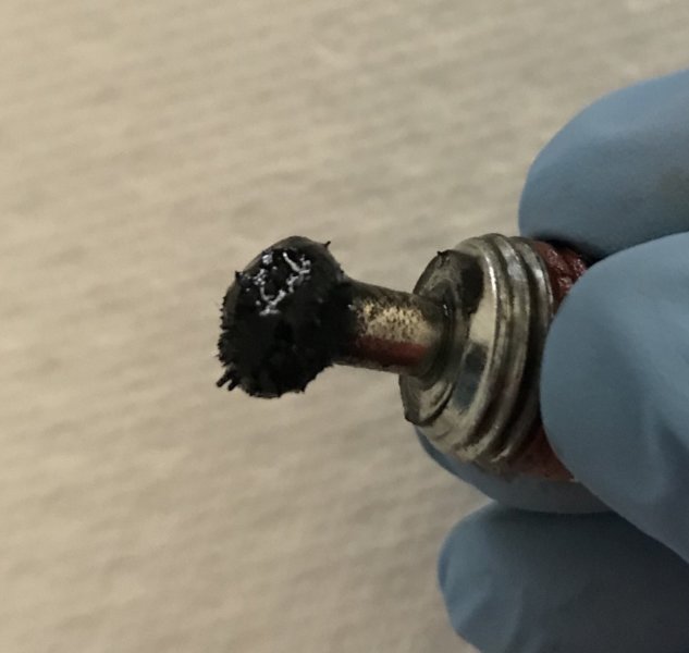

Invaluable write-up! Helped me quite abit performing my PTU fluid drain & fill. One thing I would add is to pickup a suction tool to help “forcing” the new fluid into the PTU.
My Explorer has 11,181 miles on it when I performed the PTU fluid drain & fill. Here’s what my plug looked like when I removed it.
Do you have a drain plug as well as a fill plug? Or do you have to try to suck out the fluid through the fill plug. For just over 11,000 miles the magnet looks nasty. How did the removed gear oil look? Is it safe to assume you have the 3.5 V-6? That engine seems to heat the PTU fluid much more than the 2.3 EB, which I have. Plus I'm lucky because I have a drain plug on my PTU as well as a fill plug. I had the dealer change it at 9,000 miles then I had my mechanic change it 13,000 miles later. It came out golden then, not nasty black.

My Explorer is the 3.5 V6 Ecoboost. Fluid and plug looked very similar to what the original poster experienced in his write up. I did not suck any of the fluid out, just let what could drain out on its own. My plan is to perform 2 additional drain-n-fills at the 5k miles mark. That should replace most of the original fluid by ~20k miles on the vehicle. From there, I figure I’ll continue to do PTU drain-n-fills every other oil change. It’s not hard to do once you know where everything is and have the fill hose setup. And using a suction gun helps speed the process up immensely.
So I'm assuming you do have a drain plug. If so that makes the job much easier and more thorough than having to suck the old fluid out of the fill port. That way leaves a fair amount of old oil still in the PTU.
