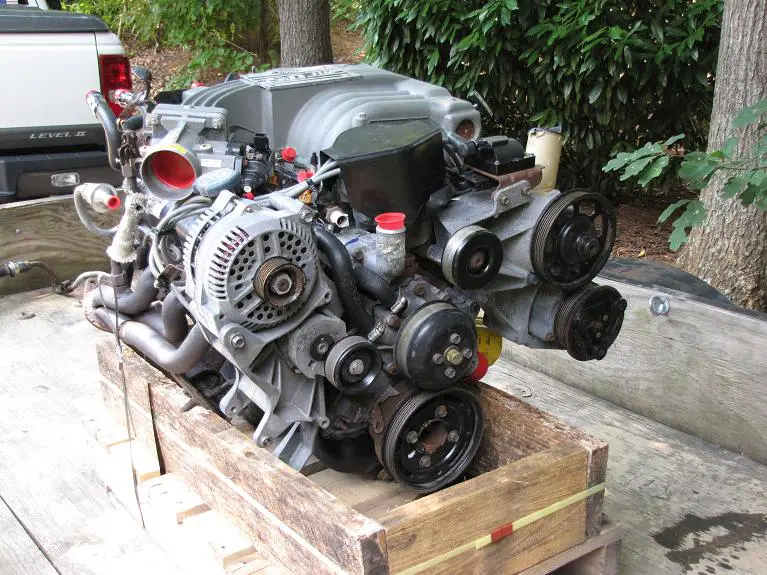

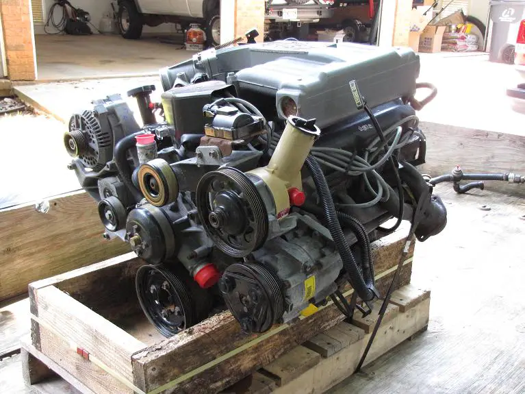

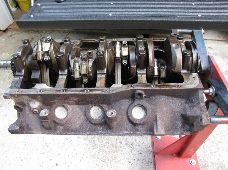

I swapped that engine for a "new" one. This one is out of a 1994 Mustang, and is factory original. A bit of rust on the outside (I think it came from Florida) but the engine looks to have been maintained.
I pulled it apart (down to the short block) and like what I see inside. Very clean.
Wednesday, it goes into the machine shop - I can't wait! Then, time to find a cam and heads.

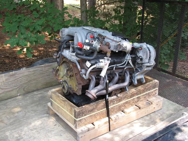

Off it Goes!
Loaded up, going to the machine shop tomorrow!

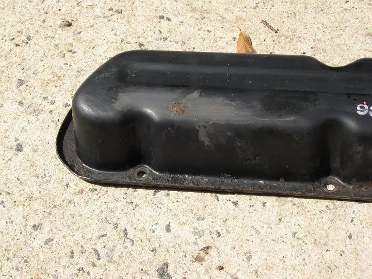

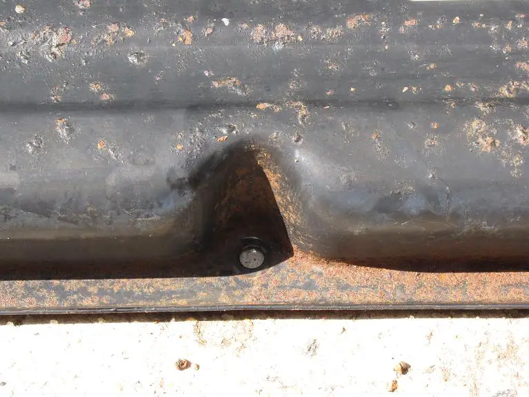

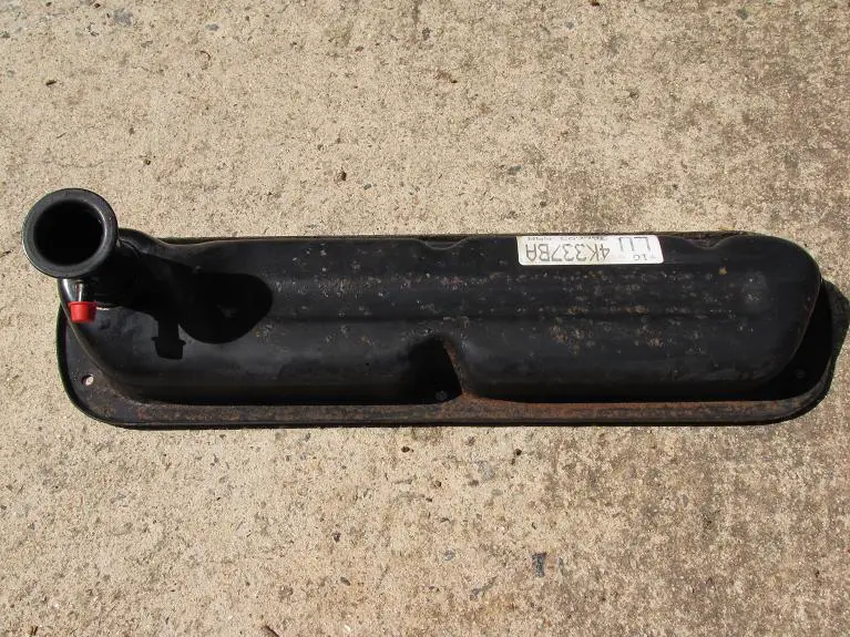

I cleaned up the valve covers today. They are slightly corroded on the outside - the inside is just fine.
Will they look OK if I powder coat these, or will the imperfection of the corrosion show through?

Send them to Turdle for a sandblast and powdercoat and they'll look great:D

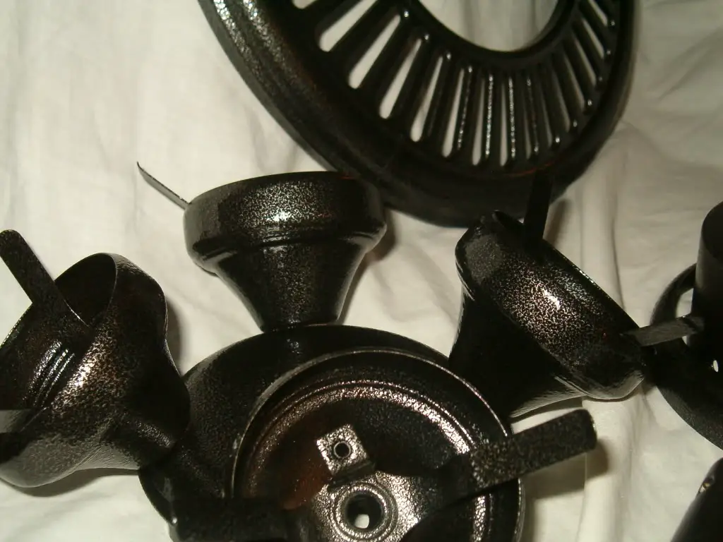

If I used a silver vein on em it would be fine.
not my picture, I just googled it for reference.
I can burn those off and blast them to look pretty good.

I like that.
What color options are there?
I assume you clear coat over the color?
I like that.
Yup
There are several tyes of veins, that picture is just kind of tinted to the purple side.
here is a better look
Yes the vein gets cleared, It can be darkened with black ckear, or a candy colors can be used as a top coat for a weird effect
Then there are gold veins, copper veins, dual color veins, copper with verdegris veins,
etc.
