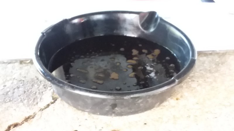

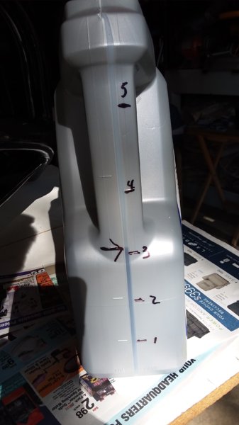

Well..... This is what was drained from the engine after 45 mins, with cap and filter off.
This is the oil filter drained dry, after the pan was emptied into the jug.

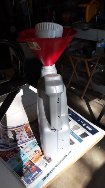

In case you can't see the marks on the jug....
Yep, that arrow is showing the total amount removed from the engine. The dipstick read right, and 2 qts low is just a slap in the face to me.
I'm no longer shocked by what else I find wrong, but it still stings.
another note, that doesn't look anything like new oil from a fresh rebuild. I have rebuild V8s that i had to use a pick to get the sludge out of the oil drain hole with the consistency of pudding and the oil came out cleaner than your rig. just a thought

A) It must not have been filled properly, as I am out of other reasons to be so low.
B) What came out was black as night, and thin as water.
C) Engine ran good, and couldn't tell it was that low.

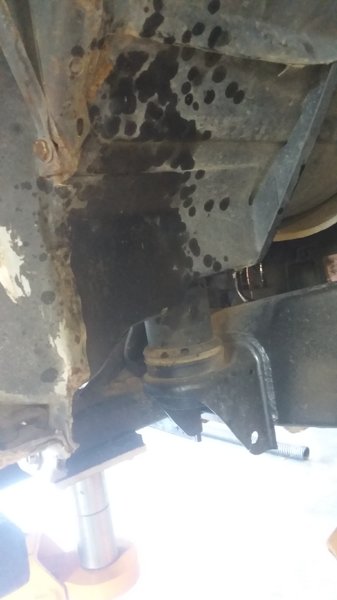

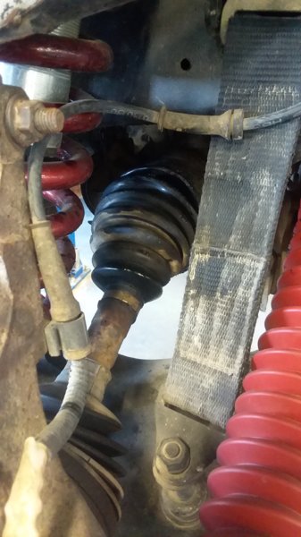

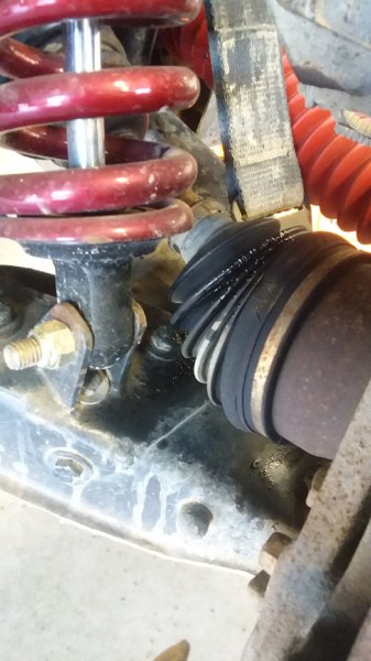

Kurt was squeezing away on the gun, and then I seen it. BOTH CV boots cracked open, and slung the magic CV juice all over. We had another repair, before we could head out. lol Once we got our crap together, His son jumped in the RV, and took on the role of co-pilot / navigator. For 7 years old, he is pretty damn good at it.

Ripped CV boots, and some juice splatter. No actual carnage to the joints, as this happened while in route to Kurts, and they was still wet. Both boots tore, and I suspect from sitting for too long while off set from the lift. I thought about re booting them, but the boot kits are almost as much as a new half shaft. Meh.

On my wifes FJ cruiser we have her lift "stretched out" a bit, meannig the ride height is adjusted to the high side to help clear the tires.
The cheapo lifetime warranty CV axles from Oreilly or Autozone (import direct) last 1-2 years in this rig, usually because the boots tear. The reason is the boot "rib" edges rub on one another (just like in your pictures) until it wears through, then here comes the grease fling fest.
So in recent years I have been removing the factory clamp and adding my own metal zip ties, but before I do I stretch the boot out about 1.5" from the stock location, this keeps the "ribs" from rubbing on one another. So far the CV's are outlasting the previous sets this way, they do not fail nearly as quickly. Maybe something that can help with your IFS setup too....Cheapo cv axles with cheapo cv axle boots, lifetime warranty, takes literally 15 minutes to swap on the FJ since toyota allows us to unbolt the LBJ.

I really like that idea with the boot stretch Jamie!!! I'm going to have to try that on one of my loose spares to see how it goes. Thanks for that!!

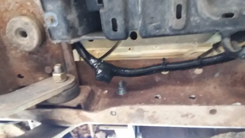

The trigger, light supply, and ground wires are 12 ga. The power supply from battery is 10 ga. I tapped into the 4 ga supply already ran to the rear for the trailer battery charge. Using an Inline split bolt, the 10 ga was clamped tight with wrenches, then sealed with tape, conduit, and more tape.

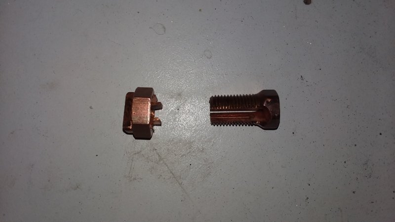

The inline split bolt is a copper threaded lug, used to tap one wire to another in the middle of a wire run.
We use them in ac wiring when adding something to an existing circuit, when a gang box is not possible. They come in a few sizes, and I used the smallest. It works with 4ga to 14 ga.
To use inline, strip off the wire sheathing just wider than the bolt itself. Slip the bolt over the exposed wire, then add the new wire to the bottom side of the wire, than install the special nut. The nut has a concave bar that seats the added wire to the existing wire flush. It spins inside the nut as you turn it, keeping the 2 wires orientation length wise on each other. Being able to use box wrenches on both the bolt, and nut, you get a super tight clamped connection. These can be had in bigger sizes to accommodate up to 1/0 wire, and everything in between.
