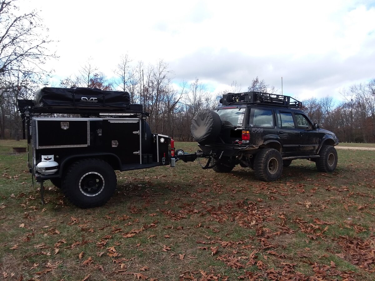

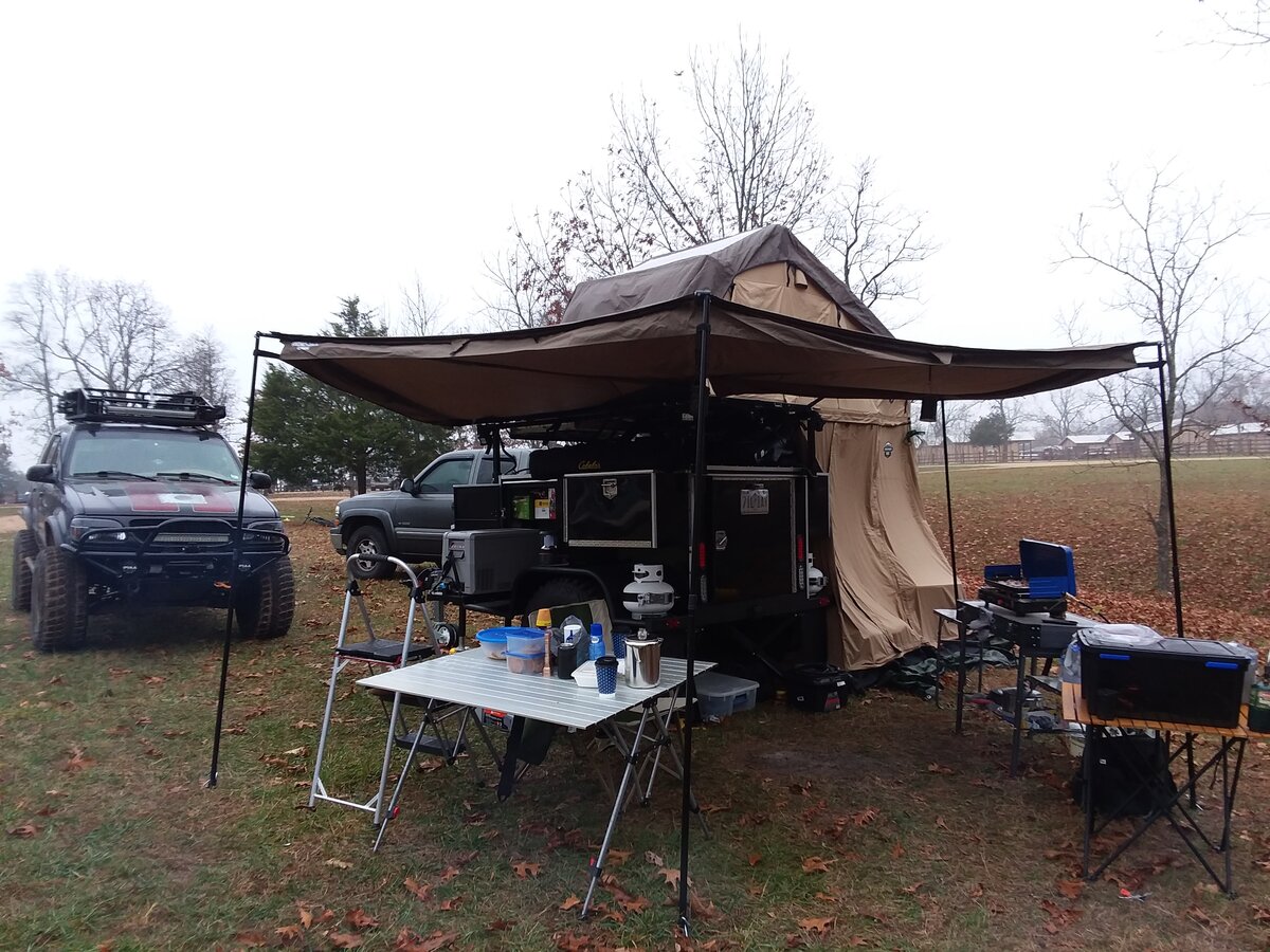

Another trip under this rigs belt. This time, no problems getting there & back. Was only a 500 mile trip tho. lol @KurtECV joined me on the trip, kept me company, helped set/break camp, and was great to have along for the experience.
It towed fine keeping it in 3rd gear (OD off), and under 65 MPH the entire time. Engine temps hit 203, and trans temps hit 208 for highs, in a very hilly Ozark terrain. Averaged 12.3 MPG. Used 1 quart of oil. That oil usage still irks me pretty good. I think I am going to plumb the trans back to the new aluminum radiator.

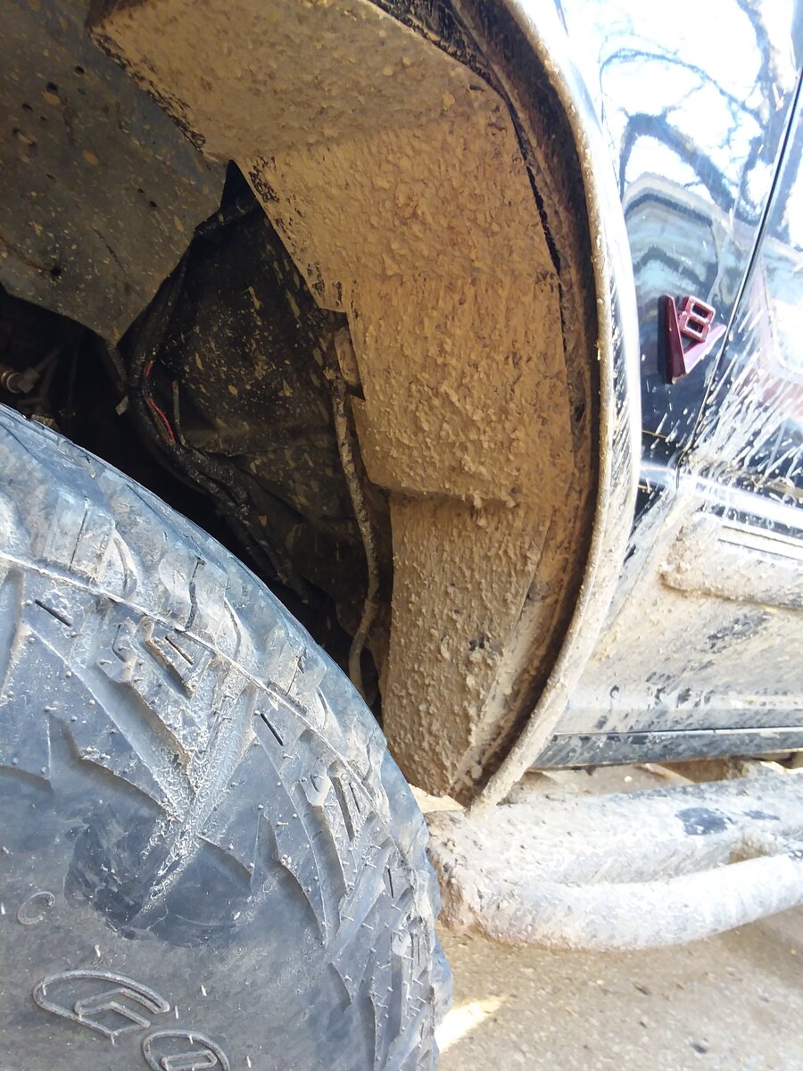

The new wheel well liners worked as intended. Stopped all the off road mud/debris from filling the voids, and cleaned off easily with a hose.

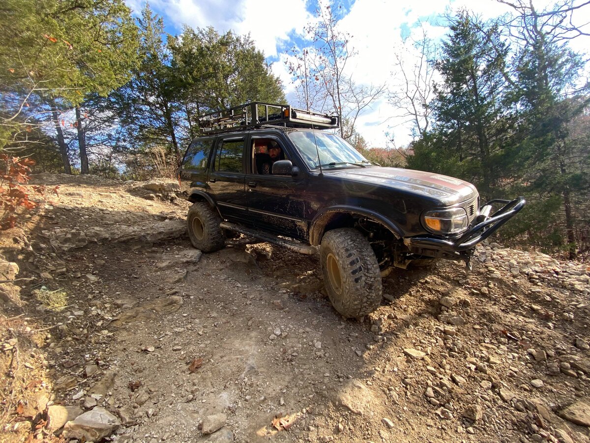

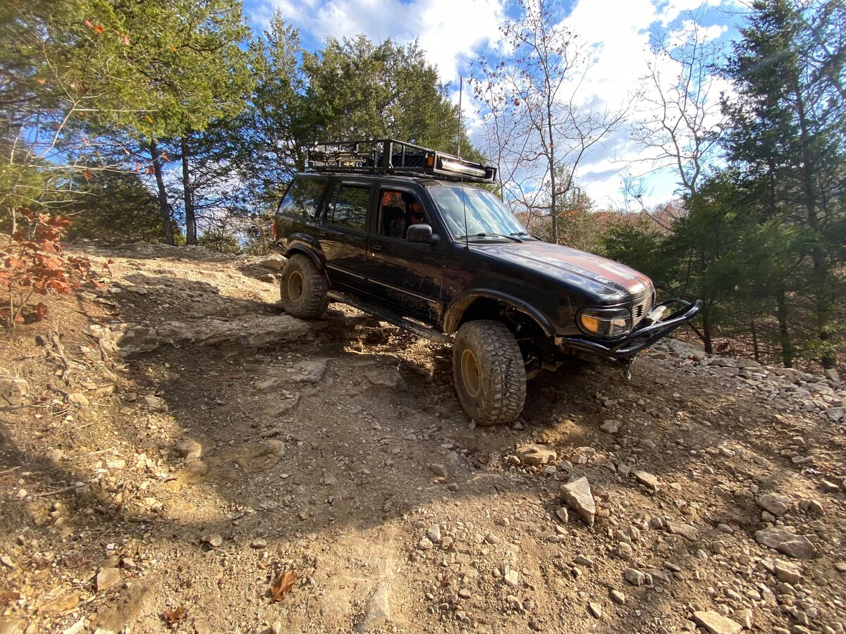

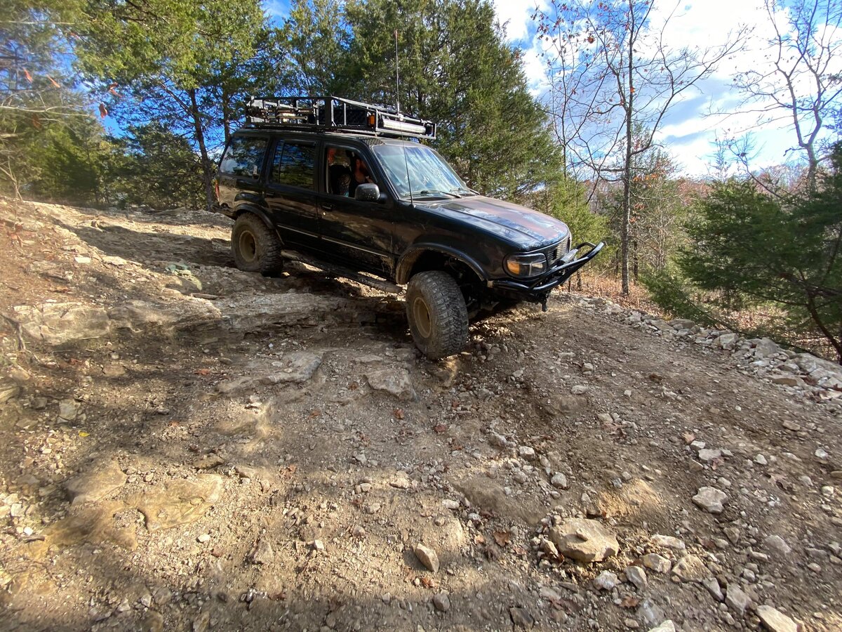

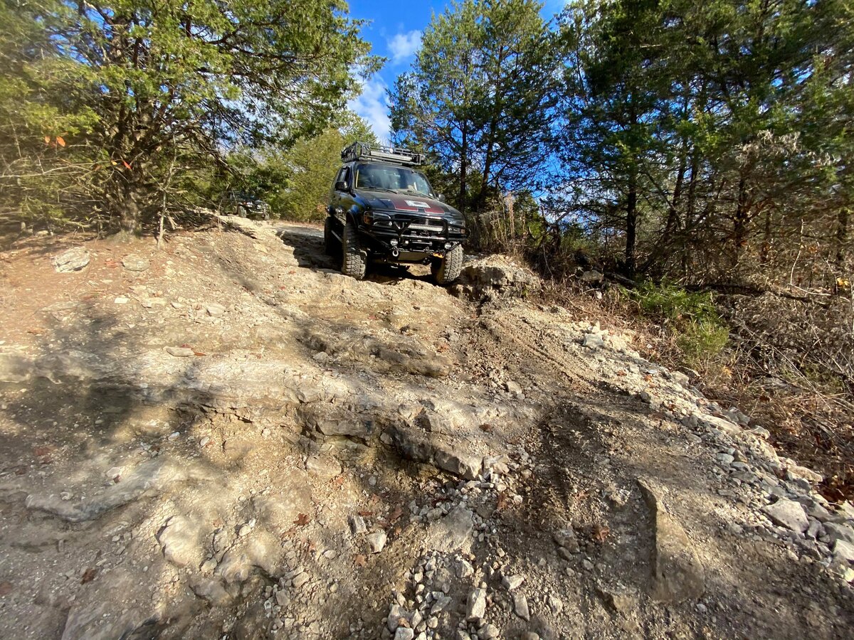

The rig works well off road. Best it ever has. For an IFS rig, it even surprises me how well it does. Level 3-4 trails was a chore or not even doable, for this rig years ago, now they are fair game.
The Overlanding people loved the setup, and was in awe as the rig walked right up and over obstacles they fought. I strapped one of them up a rock wall on a trail. Heh heh.

Pictures given to me by the event host, while on the trails. Finally, someone else took some pictures of this thing, doing more than just posing! LOL!

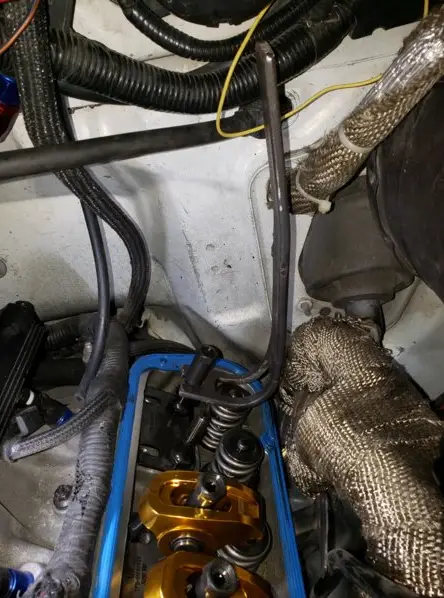

IF you just wanted to do the valve seals to stop the leaking we should be able to do the on vehicle. Just have to pump shop air into the cylinder to keep the valve from dropping into the cylinder... pretty standard work
I struggled with doing my valve seals, as finding the right tool to compress the spring to get the keepers out was not easy for me. Then, It was back braking work for me. Kurt, I'm thinking your still a young guy so hopefully it doesn't hurt.
I'm with you though Kurt, just do the valve seals on the vehicle. It's the lesser of the evil's.

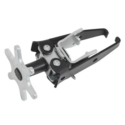

I found a pic in my 347 build thread with a pic of the only thing I could find (Tim could find, lol) that worked.
I did it in the truck on my old 96 with one of these
I would not suggest it, that was the first time I ever did valve springs and man oh man what a chore that was. My hands hurt so bad by the time I was done... that was about 15+ years ago now!!! the twist style tool will work, but it was a real PITA to twist all 16 of the dang springs closed
I like the tool posted above, leverage is your friend.
