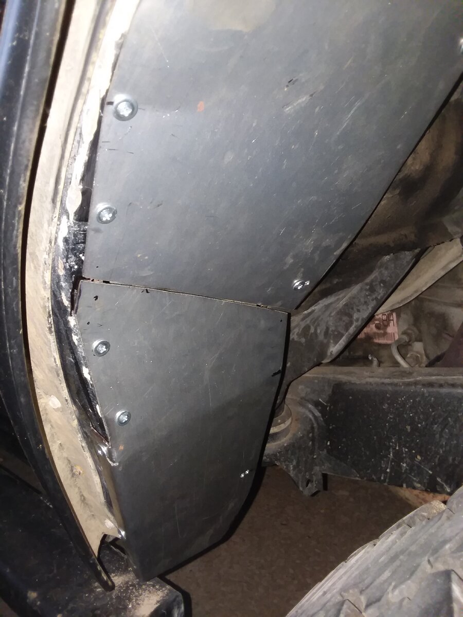

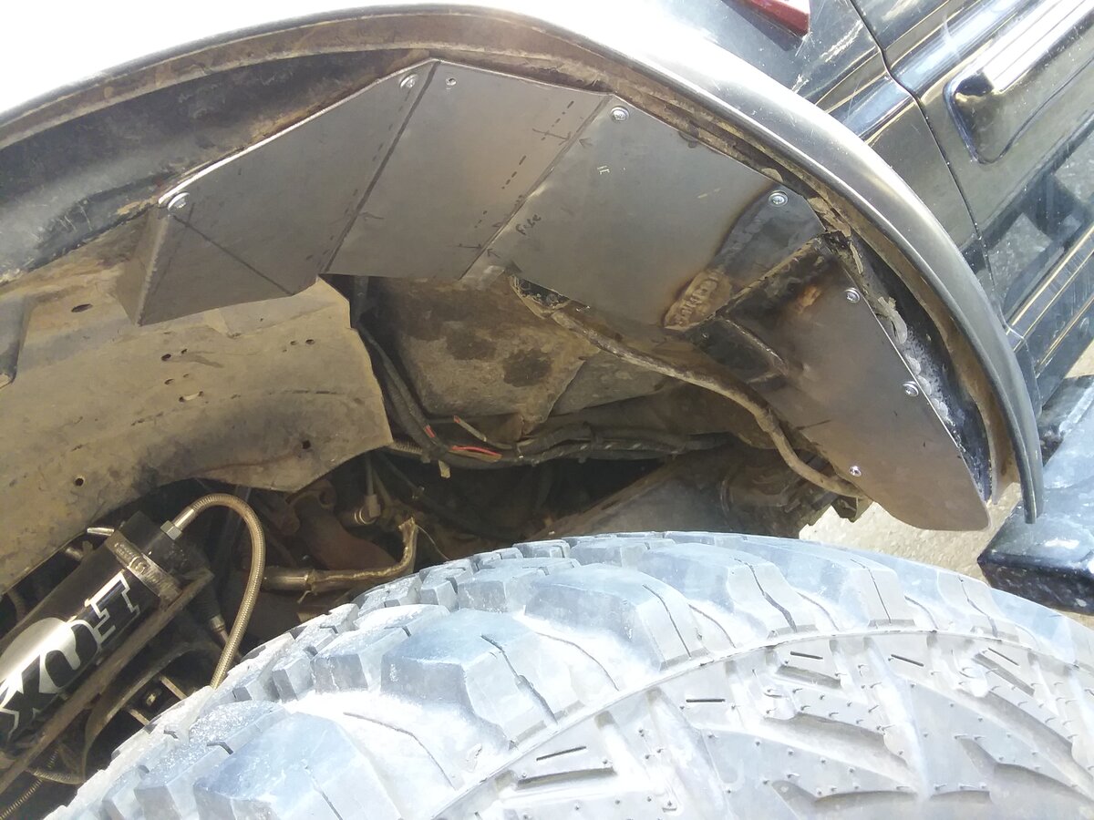

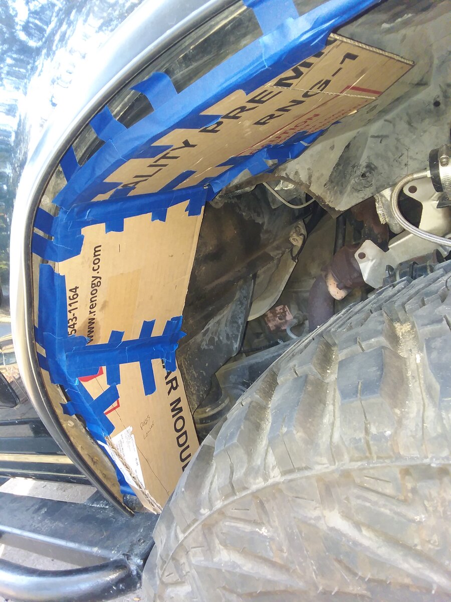

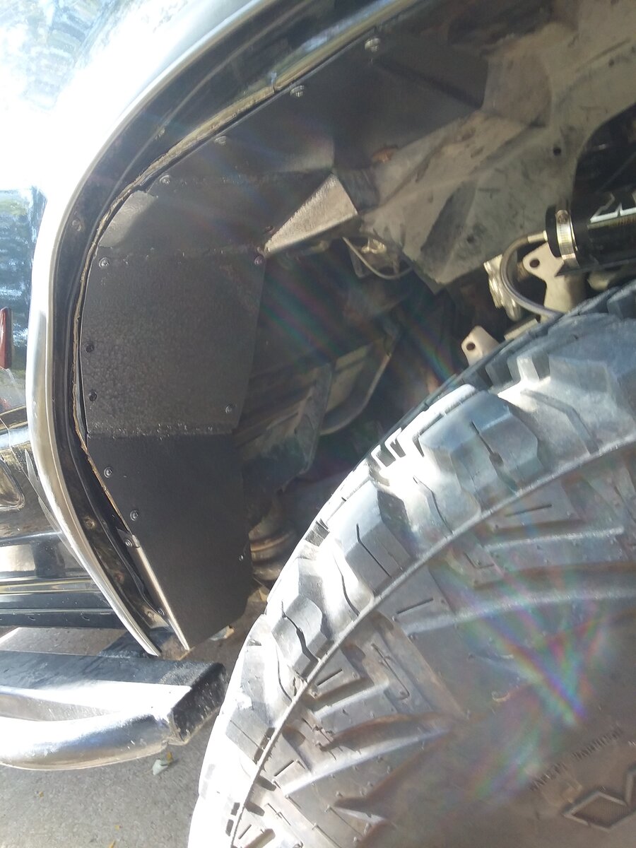

Front back half liners are done. Painted them up with self etch primer, and 4 topcoats of Hammered black. Decided against the bed coating. Paint will be easier to touch up when needed, and it will be needed.
Cardboard mock ups was made for both sides, then transferred over to 16 ga sheet metal. Dr side was 3 pc, and pass side was 5 pc. Panels was bolted up, then tacked in place. Finish welding was then done on the table. This job sounded much easier in my head when I started, but man, wow, what a head scratch'er. If I had to do it again, I think I can cut the time in half after everything I learned on this set.
Not the prettiest, but they are functional for the purpose intended. You can't really tell they are there to be honest. Smaller than they appear in the pictures below. Weigh about a pound each.
Dr side on
Pass side on
Dr side on
Pass side on

wicked!! what paint did you use?
took me 3 attempts to make the final fender skirts I liked........ I use ABS plastic up front and conveyor belt material in the back....... metal would be super cool!!
Topcoats are just Rustoleum Hammered. 4 coats to build up the hammered texture, and take a bit more abuse. Originally was going to use either Monstaliner, or Raptor liner, on them, but thought even those would get chipped up eventually, and costly to touch up.
I am already in the process of making rear gap guards too. I still have leftover 16 ga sheet metal for that.....and to do the front halves of these fronts someday.

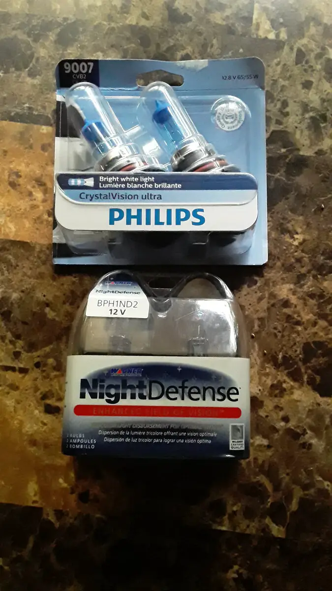

So after installing those clear lens reflector headlight housings, I am shopping for new bulbs. I'm undecided on what to get.
Sylvania Halogen Silverstars are in there now, but they need more output. These have a blacked out tip on them for the reflector style housings. Seems to me, that the clear lens could run a bulb with a clear tip? Dunno!
I'm not going to spend hundreds on fancy projector retrogrades, or top of the line HID's, and am only willing to spend so much on bulbs. The rig is rarely used at night, and is only a part time hobby useage. So far I have come up with the following replacement choices.
Halogen: $45-$55/set, But both have short life spans (as short as 6 months) because of the higher output.
Sylvania Silverstar Ultra (27% brighter than stock) $48
Phillips Xtreme 130% (26% brighter than stock) $54
Or
LED: $50-$60/set long life spans for the lower end chinesium brands.
Plug n Play 9007 from a few manufactures.
Each of those brands have a slightly diff style to them. All claim to be direct plug in swaps. All with built in high speed cooling fans. All are about 400% brighter than stock, which more than likely breaks down to 1/4 of that in real life. So 400% claimed, is more like 100% brighter than stock..
Auxbeam: 25w-2500lm/ea-6500k color- Zes Led chip-IP65- 30k hr life span- 5 star rating @ 100% - $56.00
Alla: 30w-5000lm/ea-6k color-Cree Led chip- IP65- 30k hr life span- 5 star rating @ 75% - $50.00
Katana: 36w-6000lm/ea-6500k color-Cree Led chip- 55k hr life span- 5 star rating @ 78%- $50.00
Torchbeam T2: 30w- 6000lm/ea- 6500k color- House brand Led chip- 50k hr lifespan- 5 star rating @ 78%- $47.00
So, as you can see, the $ pricing is all about the same on all of these, halogen & Led's.
Halogens last the longest, but are the weakest output. BUT... They are hassle free, trouble free install, and can easily be replaced anywhere the rig maybe at any given point.
Led's will most likely outlast the truck, and are much much brighter, and should help with the smoked out reflectors on these new housings, but might take some mod work to retro fit, even tho they claim to be direct plug n play. so far I am reading that the O-ring seals do not seat properly into the RBV housings that great. In the event one does go out, replacement is not easily done and a few days wait time.
What to do, what to do?
Found this website that was handy.
www.bulbfacts.com

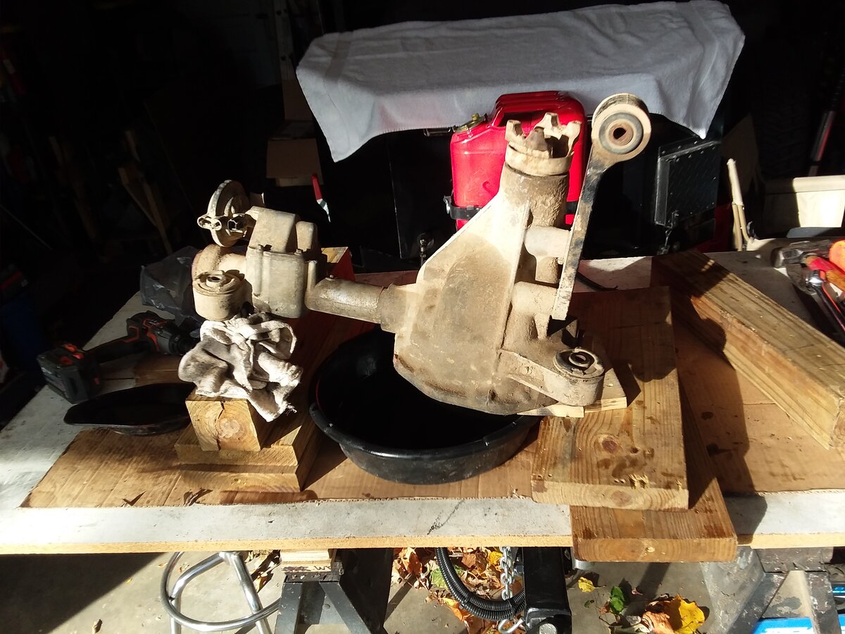

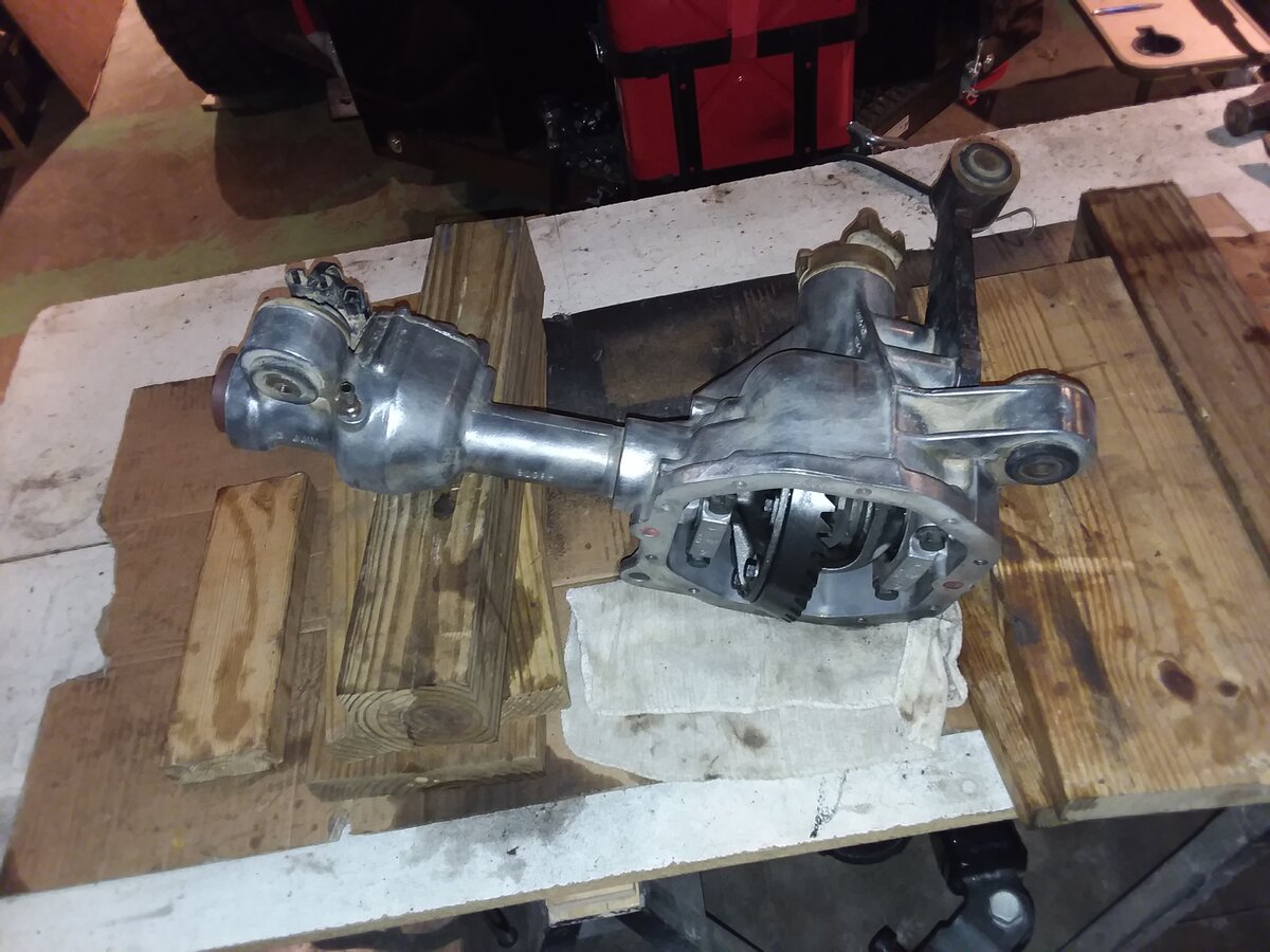

Removed the front CAD Diff housing out this afternoon. Letting it drain overnight, before I dig into it, and clean up 10 years of nasty on it.
Was hoping to be able to just replace the locker pins & springs with the carrier installed. Nope. Ring gear is to thick and it blocks access to two (of 4) of them. Carrier has to come out, and ring gear removed. Figures. What a Richard. Will get to that in the morning.
While I have that removed, I have clear access to the engine's oil pan at the CAD housing location. Going to massage the pan inward a bit for more clearance. I think I might try grinding down the cad housing a bit too. That way I don't have to beat on the pan too much. Instead of just swinging a Ball Peen at it, I have an idea to use a 1.5" hitch ball. Thinking is.... Hold the ball on the pan where I want it to push in, and hit the ball stud with the ole 5 lb mini sledge. If I crack this pan, I'm in a world of sheet!!!
The 3 ton Triple lift floor jack worked better than I thought it would, for dropping the dif. Better than the trans jack actually. Removing the cup on it, lets me use the wide flat platform, that cradles the dif nicely. The rubber diamond strips are actually the platform in the pic below. I have to manhandle the dif on mine, as it doesn't drop straight down like normal. The rear LCA support tube is in the way of the vertical bolt on the dr side, and it can't be removed until the dif is twisted, and shoved around every which way til Sunday, as it is lowered. Fun by yourself I tell ya, just fun! But being able to work this jack handle as I am under the rig wrestling a smelly dirt front pig, helped a bunch. It's also a jack stand. Uses a big pin bar under the platform to hold it up after it's lifted. Pretty safe for a floor jack.

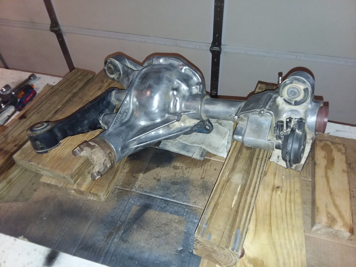

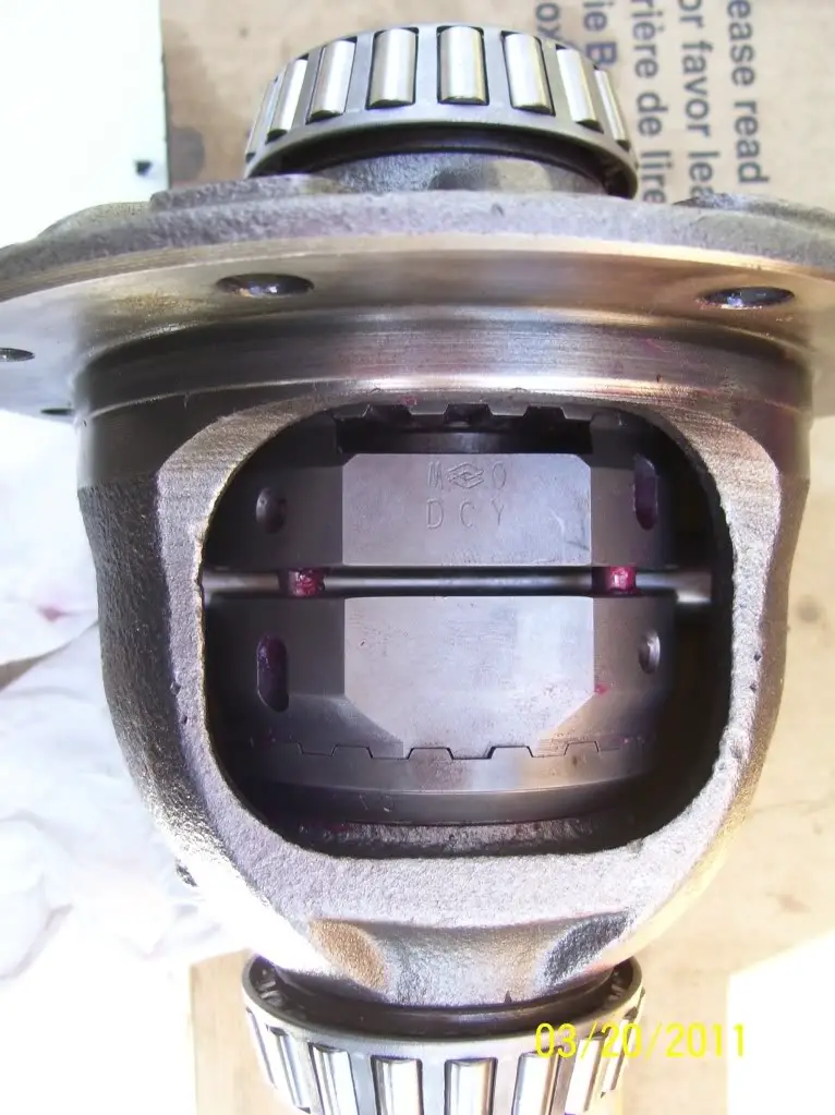

So I discovered something this morning that is frustrating. The DR side wheel turns the front drive shaft as is. I suspected that the locker's springs was worn, and causing the front locker to stay engaged. Ordered a new set of springs & pins to replace them, and is why I dropped the diff yesterday.
After inspection of the locker, the springs are good, and are doing their job just fine. So I dug into this thread, and found the post I made 10 years ago, when I installed it. The picture I posted of this locker after install spoke volumes to me this morning.
The way this locker is installed, the teeth are fully engaged. What this means is, when the dr side axle is turned, the locker case on the dr side, turns the cross shaft, which turns the other half, which turns the ring gear, which turns the pinion gear, which turns the drive shaft. That's only supposed to happen when power is applied, and the 2 halves close together, locking onto the cross shaft. I either installed the locker wrong, or that's just the way it is.
I'm going to email Lock Right, and send them this picture, and ask if that is normal or not. If you look closely, you can see the teeth meshed together on the bottom of it. One thought is, the gap isn't big enough to seperate the 2 halves from the cross shaft. That would need a re-shim to correct it if that is the case. Another thought is that there is just no way to change it up, and I have to live with the way it is. AWD Mounties, have the front shaft turning the carrier at all times, so it really shouldn't be an issue for the carrier to be turning. My front shaft turns, but the Atlas case gears are not engaged in 2wd, so the drive shaft is free spinning inside the case. I need to go buy a new set of feeler gauges today, and get a measure of that gap to submit to Lock Right with this picture.

Ok, so this was what I posted back on page 43, 10 years ago.Future reference...
The distance between the halves of the LockRight, that is between the two drivers, should be about 5/32-inch (.156-inch, or 3.86-mm). The tolerance limits are between .145-inch (3,68 mm) and .170 inch (4.32-mm). If this distance is much over .170-inch, either the case is quite worn or the thrust washers are missing or are too thin and problems should be corrected before proceeding further.
Fast Forward to today...
Took another gap measure on the locker, and it was 0.157". I'm good there and still in the tolerance range. I really don't consider that a change at all over 10 years. No reason to change the springs on it. I also checked the torque setting on the ring gear bolts. 80#'s, so good there too. All that means, is I don't need to tear the axle assembly apart.
I think that the locker is installed as should be, and it is, what it is. Both axle sides turn when the pinion is rotated, the drivers tire will always turn the driveshaft, and the pass side tire spins freely (not turning the drive shaft), because of the central axle disco.

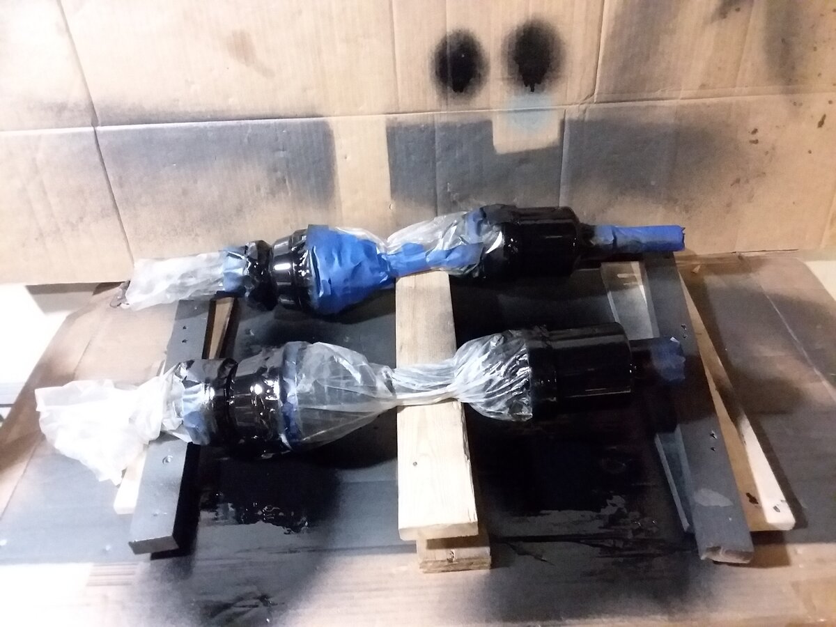

I cleaned up the entire housing with a brass wire wheel as best I could. Cleaned the inside with brake cleaner, and ragged it all down. Cleaned the backside of the engine cross member and surrounding area as well. Scraper and wire brush made a nice black particle rain, and it poured on me. lol
Found a missing nut on the underside of the pass engine mount. The positive cable has a bracket that uses that stud to hold it. No idea if it fell off, or if the engine swap people forgot it. I found one for it, and zipped it on. I think I need to replace that cable anyways, as it is too short. I'm sure the body lift isn't helping that length either.
This wasn't a total loss of time & effort. I managed to massage the oil pan a bit, for the CAD housing clearance. Plus it all got cleaned up real good. 10 years of cross country travel, and some crazy good times wheeling, sure made a mess in an area you just can't clean normally.
Going to be a couple days before I get it all back together. Rains just moved in, and will be here for a bit. Cover back on with some Red RTV, and let it cure out in the meantime.
The pass side CV's rubber dust collar to the backside of the bearing hub, had separated, and left a nice rubber ring flopping around. I replaced that axle last October (1 yr ago). I called the parts store, and asked if that is covered under warranty, and they said yes. They ordered me a new one to replace it with. Think I am going to paint the steel cases black before both of them go in. Dr side is new, so no rust yet.
Lot's of yammering there, with no real good info, other than the locker checked out ok. lol Thanks for reading anyways!
Edit:
That should keep the rust at bay for a while. lol
Good bead of Red curing out.
Paul
