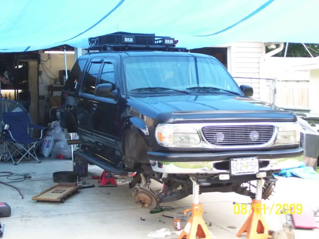

I caught Eric with a cutting wheel, going to town on the rig!
We got the 4.56 gears installed. Wow, My hats off to all that helped out!

Also Jon was able to get my brake line situated, the line extension is in place, and system bled.

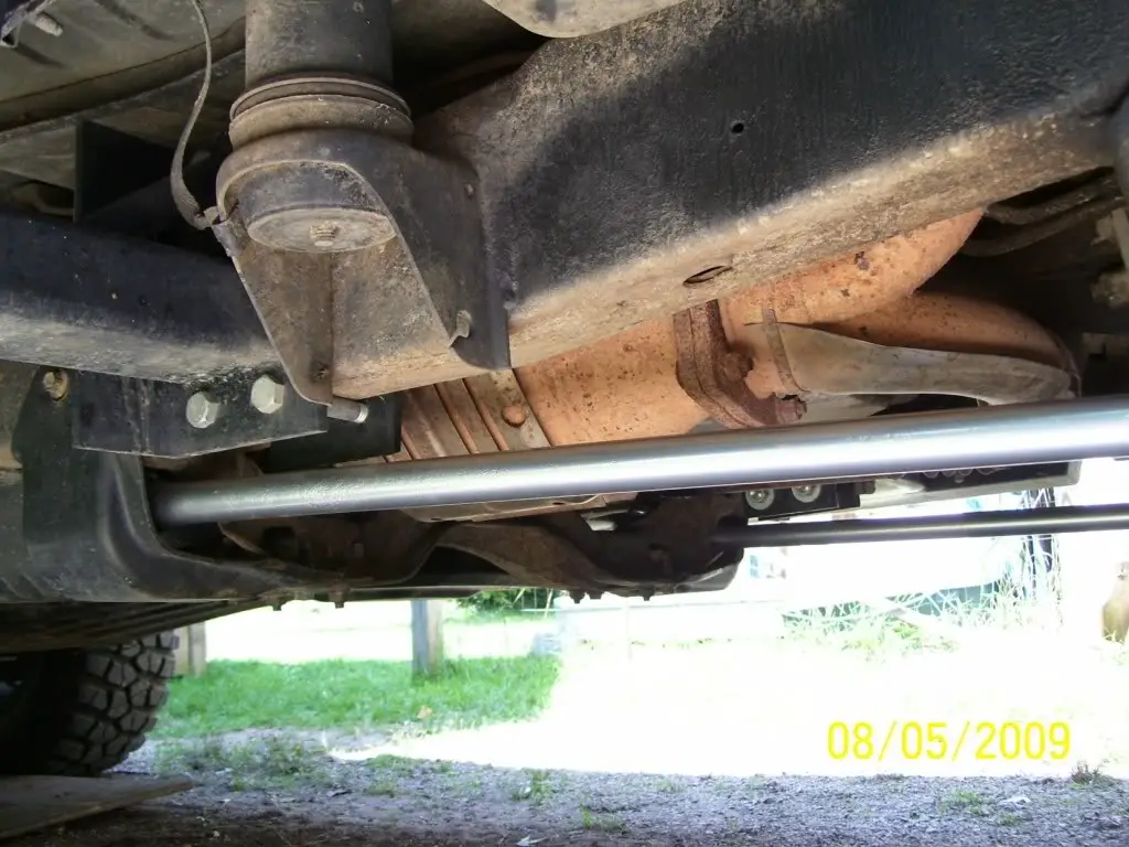

The sport trac T-bars were powder coated a chrome/silver, clear coated, and installed.
The rear Rock crusher diff cover was Re-done to its formal glory as well.
Chris (Inh), made me a CB bracket for the whip antennae and it got some powder as well.
Only thing on the list that didn't get done was my Vac gauge install. I will work on that B/4 trip to Ouray.
I must say, I really like your truck greg. It's turning out quite nice =] Let us know how you like the gears and sport track torsion bars once you get some time on them =] Then let me know when I can help you get a front coilover conversion fone ;)

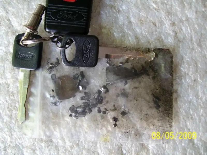

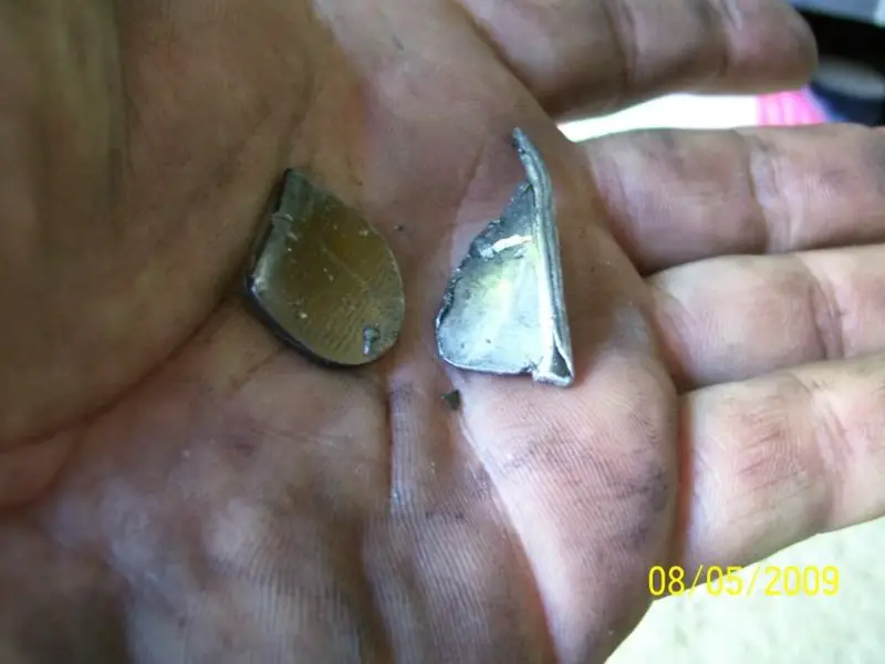

Well, I called the shop who installed the Locker back in March. I explained to the manager that we had the rear diff apart, and found huge chunks of LS clutch fragments from when it blew up. They installed a open carrier(used from them) and my locker (I supplied) for the tune of $325.00.
He didnt remember me or my rig. I had to explain to him what they did, and when they did it. He was bewildered to try to recall the job, I figure they have done a lot of bizz since I was there, no biggie.
His reply to me was this," We probably didnt clean it out before or after the install. To many people want work done for as cheap as they can get it. So we just worry about the install of the parts you want installed. If you wanted it cleaned out, you should have requested that we do so, it would have been an extra charge to do so."
Here is what I asked," Do you mean to tell me, you knew a LS clutch pack was blown up, and you didnt think you should have cleaned it out, or inspected for fragments before installing my new parts? You sold me a open carrier to install my locker, cause you told me about the blown LS carrier in it. Is it common practice to not clean it out? By the way, you never suggested cleaning it out for an additional fee. I would think that is a normal part of the job."
His reply," I am pretty sure we did, you just don't remember. We just do it this way to save people money, it's common practice."
"I don't think you ever asked me about this." I responded.
"Yes We did, not my fault you cant remember!" He yells.
I hung up on him right there and than. I am so pissed that he called me a liar, I am about to go over there and break his nose! He couldn't remember the job, but he remembered telling me about cleaning it out for extra charge? WTF!
Oh, and I even supplied the synthetic fluids for the job!
This is some of what we found inside.
Wow man, that is some bullcrap right there. Time to let the BBB know. Whats the name of this place so others know to stay away?
