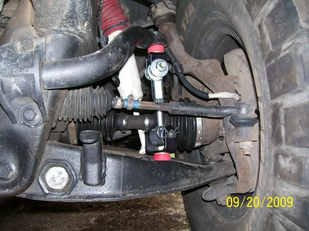

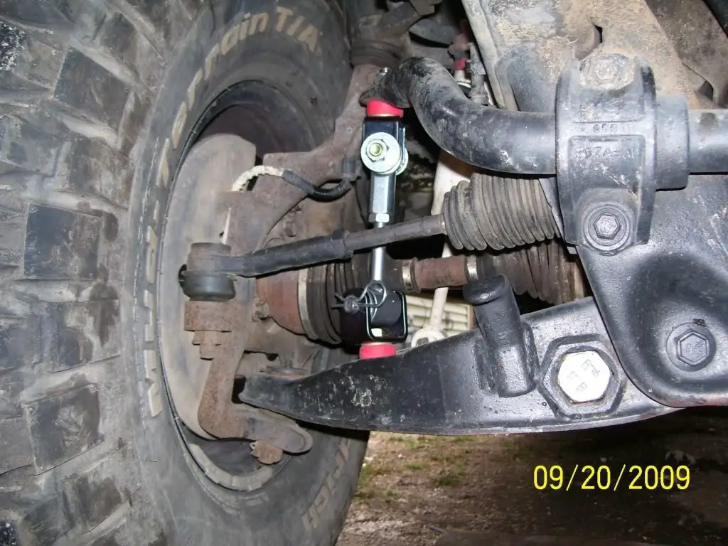

For now, the newest update is the front sway bar disconnects.

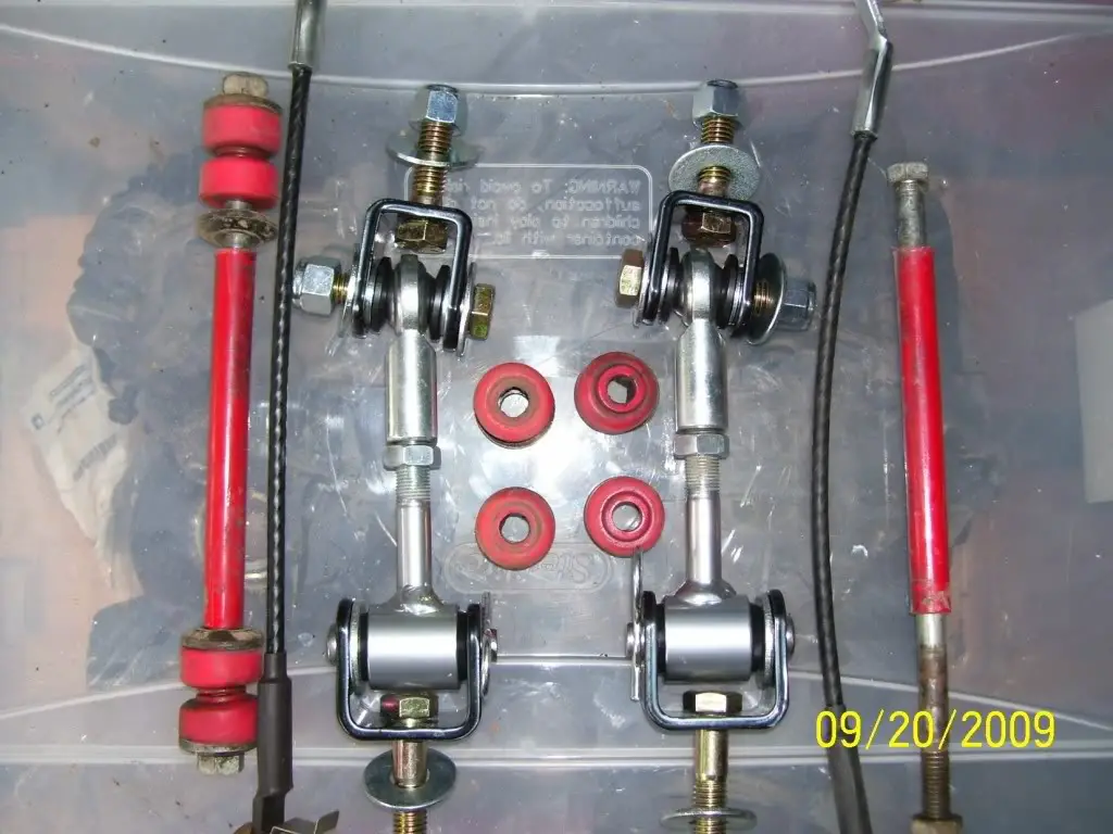

These were hand made by DkChrist, powder coated by Turdle.
In this pic, I have the old end links and the new disconnects.
I used the red energy suspension bushings from my old links for the new disconnects.
Pass side install
Drivers side installed
I also had to have something to limit my travel when they are disconnected, so I opted for a cheaper way, these are ranger tailgate cables. $10/pc. The rig is on a floor jack and the wheels are at full droop in the pics.

I should get a lot of articulation when these are disconnected. Get rid of that Bobble head action with the sway bar still connected.
I have to say, these disconnects made by DkChrist are very nice, heavy duty, and will outlast the rig most likely. I think you can get a set from him if you ask him real nice like ;)

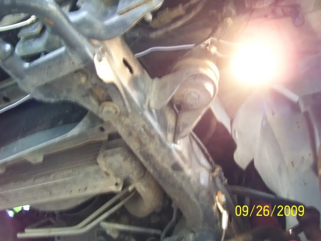

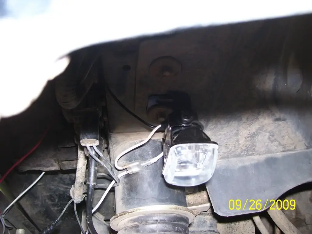

Latest:

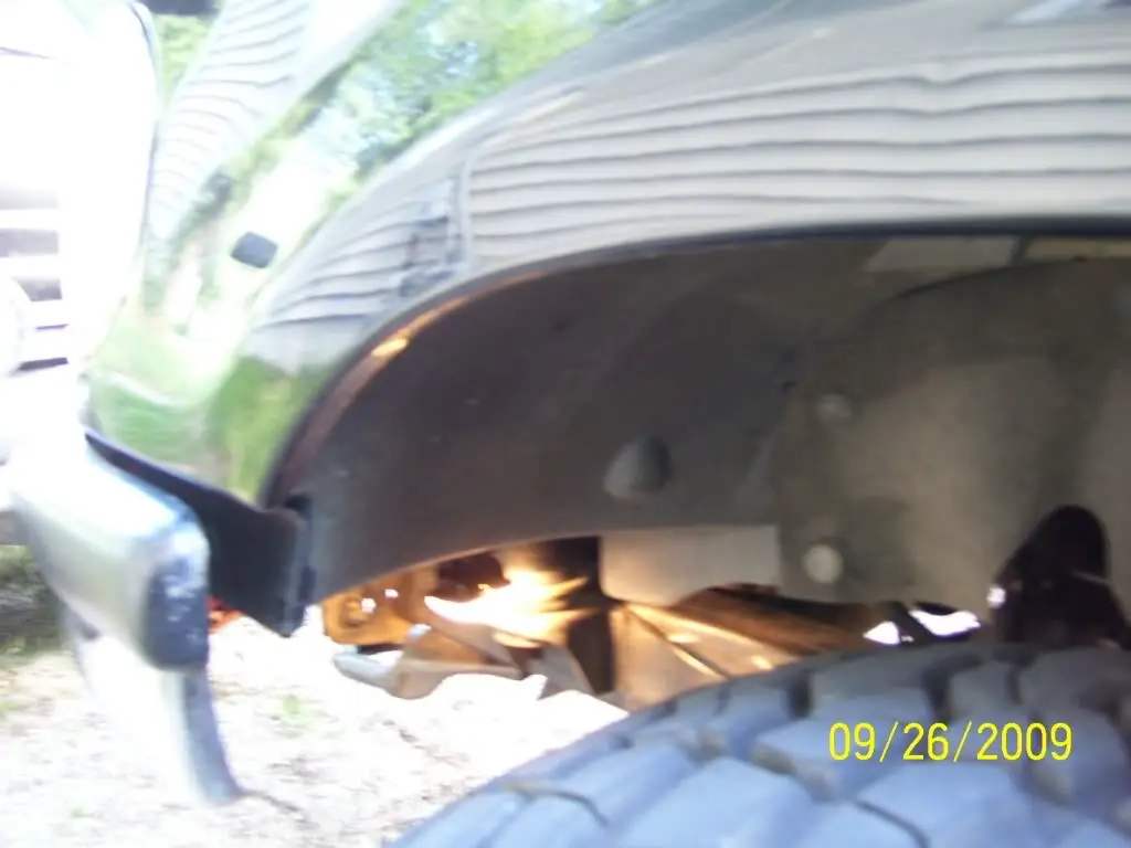

Wasn't happy with the front drivers lights used for rock lights.
SO...........
I installed 2 more 55 watt mini's for rock lights in the front. These are a major improvement for seeing at night. They will light up the area around the tire, where I can lean my head out the window and see whats going on. Perfect for changing a C/V axle in the dark as well.
