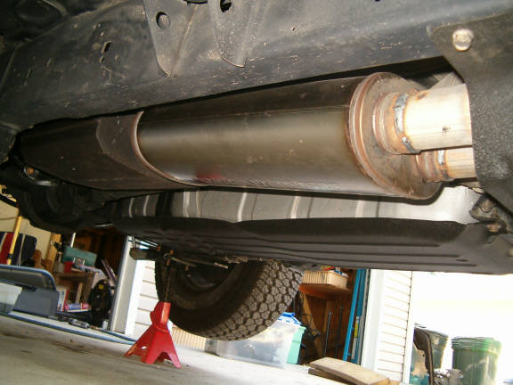

My engine has quite a cackle, so the above muffler was tried to calm it. It did, but man is it huge!! Fine for the street, but, too low for where I want to go.
It was from a duramax diesel pickup.
Now I have this-and it sounds mean-
louder and bigger sounding, and, actually quieter on the highway-
Rear cats gone- Magnaflow dual in single out in their place , and a Hooker Aero chamber 3" in 3" out stacked right behind it.
Ohhhhhh, it sounds sooooo good!!

Tom's Muffler in Chanute, Kansas hooked me up. All I have to do is display a decal-:thumbsup:
The space between the shock and swaybar links doesn't allow them to bend 3" pipe in there,as they have a 4" die and the bends are 2.5" apart-
so they are getting me some 3" mandrel bends and fabbing a 3" tailpipe from it. It wil be a while, not in time for Ouray. This will be the final exhaust, Sheri even likes it.

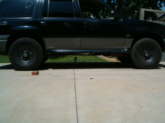

I can't tell from the pictures, does that exit out the side or rear?
Right behind the passenger tire-45 degrees away from the driver and 45 out the side-
Jon I had to buy a couple 3" SS mandrel bends to make it from the y-pipe that is right after my muffler to the exhaust tip which comes out in the stock location. The only thing I got real close to was the 5th shock and I am hoping it doesn't have to much movement!
