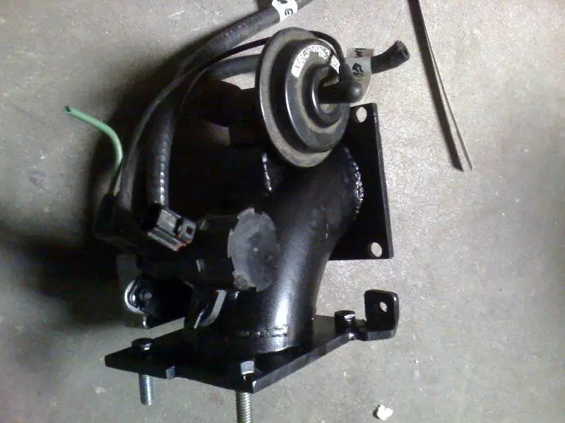

i finished up the intake elbow yesterday. i ended up going with steel as i was able to use materials on hand. it was the right choice anyhow because of all the extra little brackets i had to attach to mount the throttle cable bracket, the EGR valve and the 2 EGR control "thingys". doing that in aluminum would have been incredibly difficult. really happy with the results. everything has a home and it all fits in the package.

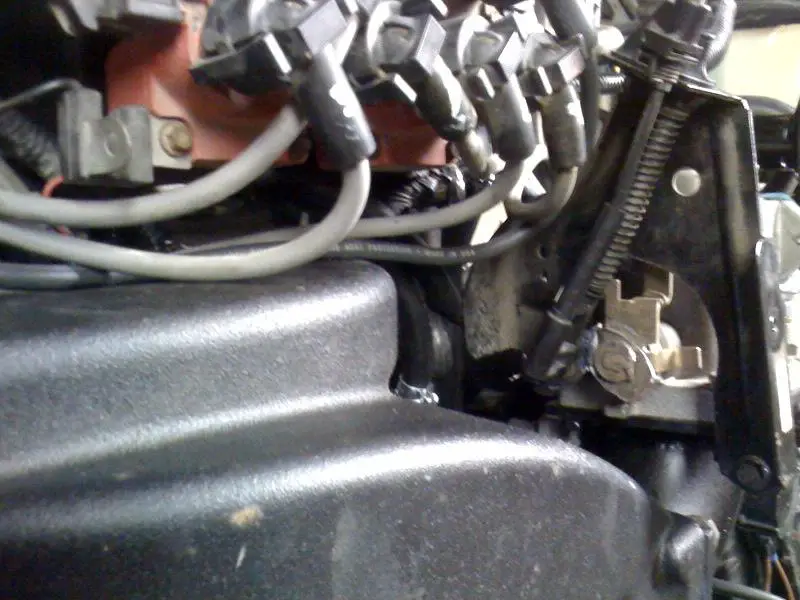

oh, and as you can see, i got the throttle body lever worked out too. i grafted a stock lever arm onto the BBK throttle body.
