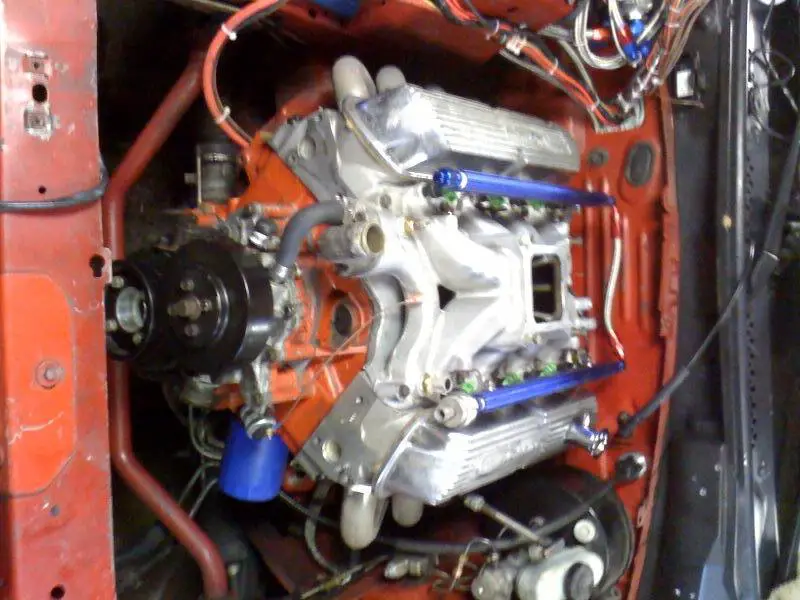

so, i pulled the 408 from the mustang and am starting to swap the timing cover, water pump and motor mounts. i am going to put the mustang back together first. i am on the hunt for some used parts to get the 347 in and running. i need a stock t-5 (g-force isn't legal for AI), 10T 10.5 clutch disc, 302 dizzy w/o TFI, road race oil pan/pickup and 302 longtube headers. if anyone has a lead, let me know. once i have the parts, its gonna take about a day to get it in and running. then it goes out of the garage and the turdle goes in to use as the test fit rig. once i get all the custom fab done, its getting pulled and dropped into my mounty. i did decide to stick with the 4406. i am going to shorten the shifter though, because it does get in the way of my leg. i talked with andre from edge converters and he is going to get me an awesome converter for this setup. i just need to decide on the cam first. i think it should be a similar lift as the cam i am selling above, but with alot less duration. if someone can tell me how to post pics, i will keep everyone in the loop on the project. i know there have been other 351w swaps, but has anyone done it in a fully street version?

these should be pics of the 347 just plucked from turdle and the 408 about to be pulled from the mustang.
it worked! its going to be kind of annoying cuz all my pics were taken from my iphone. so, they have to be uploaded sideways and they are grainy.
