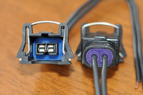

injector connectors
I didn't like the stock injector connectors. Two of mine were brittle and the locking tabs broke when I removed them. I replaced all of mine with Delphi EV1s: EV1 FUEL INJECTOR CONNECTOR QUICK RELEASE (ev1 delphi) 6 QTY
Nice! thanks.
I'll be picking some up for the next time I have the upper intake off. Everything is pretty brittle under my hood and some of the injector connector lock tabs have broken off.
I need the USCAR style, but Im sure they are there.

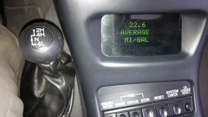

I was happy with combined 18mpg going back and fourth from work in the past. Now I'm 22.6 mpg. I may not end up that high after all the smoke clears, but there is clearly a gain to be had here. I'm guessing the biggest gain in mpg has come from James's Tuning.
I did order some new injector EV-6 (uscar) connectors to have on hand for the next time the upper intake comes off. There are at least 3 that the positive lock is broken on. Some are just really brittle, and you look at them the wrong way and they break. Special thanks to streetrod2000 for posting the ebay link. While I can't use that style, I hadn't thought of ebay for these. I bought the pigtail style also, as I think soldering a pigtail gives a far better connection than crimping wires and inserting pins into a connector.
