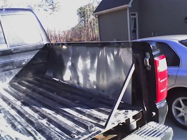

Got the bed 3/4 the way sheetmetal'd. Need to get one more sheet. For some reason the pics make it look like the sheets are bent up and tweaked and nasty. But their not...?? O well.
i was gonna say the same thing. seems like a good way to ruin a really good build
