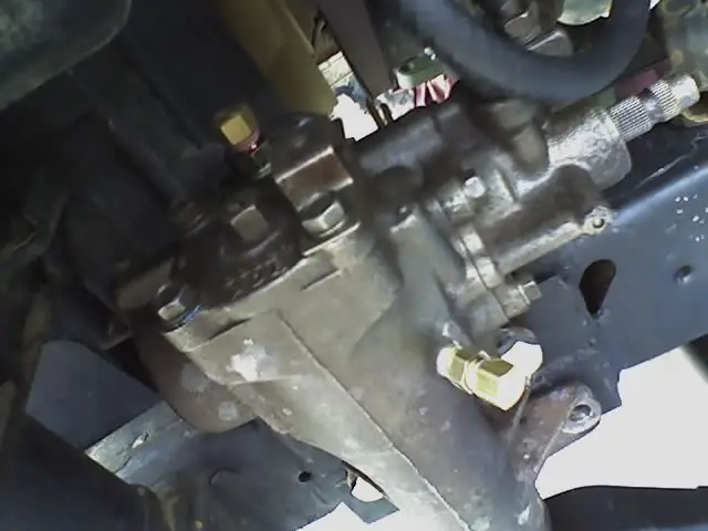

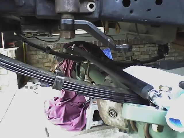

LOTS OF PICS. My power steering is hooked up, and fully functional. If i had brake lines and shocks, the front would be complete (minus hydro-assist, ram is backordered).
Pressure and return lines...
Steering box in place...

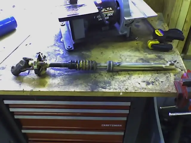

Steering shaft, completed.
Steering box with shaft attached.
Drag link and box installed...

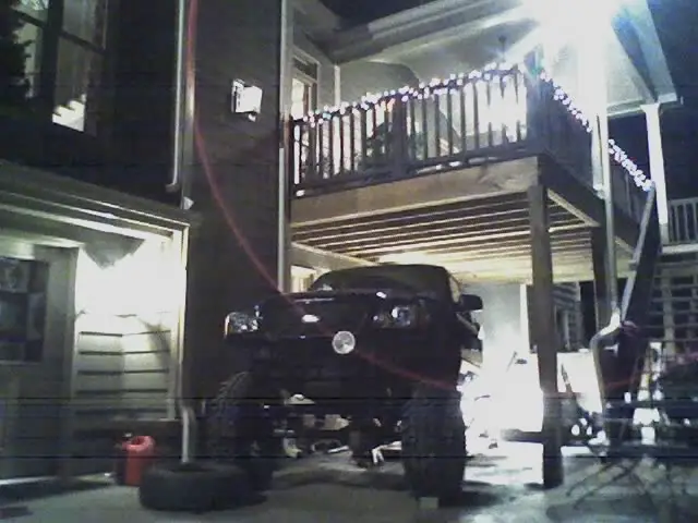

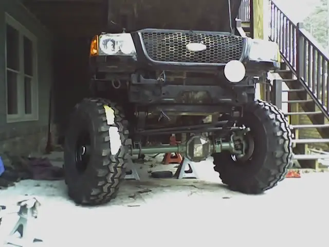

It's running, and these are shots of it right after i turned the wheel.
Left...
Right...
Pitman arm is one spline off, thats why i have less steering turning right, if it rains tomorrow I get work off and i'll rent a pitman arm puller and fix it.

That steering shaft angle is a little severe. You gonna paint the axle any certain color or leave it the way it is? Looks good!
The shaft angle actually isn't very bad, there is still alot of travel left in the joint at the box. This angle is also sem-unnavoidable now, because of the body lift, but when i take that out, it will be alot better.

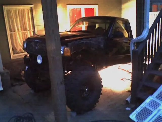

Moved my truck forward...
Got the bed sittin on some 31" MT/R's...
Narrowing ~8" on each side...

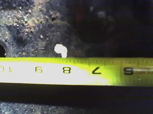

Drivers side cut.
Both sides cut. Inside of bed rail at cab = 54". At tailgate = 37". Narrowed a total of 17" at the tailgate side of the bed.
