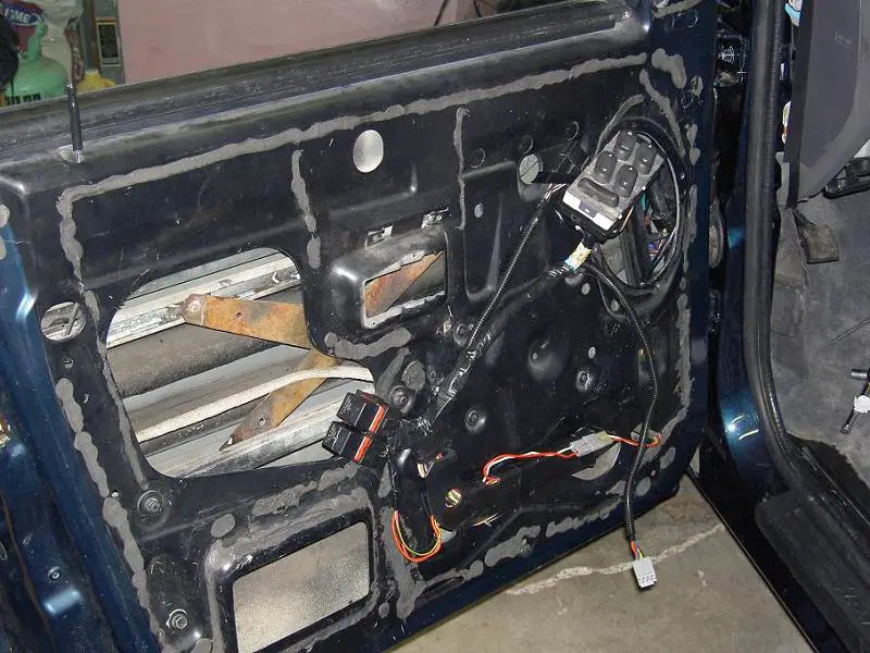

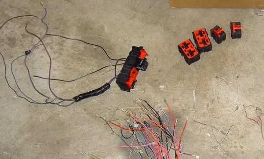

They're in a few components, you have to first remove everything but the core pieces and the center locking(red) parts. They are very hard to separate, and to put back together. It took me a long while to figure out which way to push and pull on each part, to get them to let go. Go slow and steady, don't let your hands jerk in any direction quickly. The corners and edges are all sharp enough to scrape or cut you easily.
Everything is easy in general to get apart, except the main center sections(squares). It's been since 2006 that I worked on those, so I've forgotten some things.
These below is the four relay unit I made and the four double units I put into each door. I used two relays in each door to control window motors, controlled by two different master switches. Note the smallest ones are from cutting a block that uses the small relays, in half.

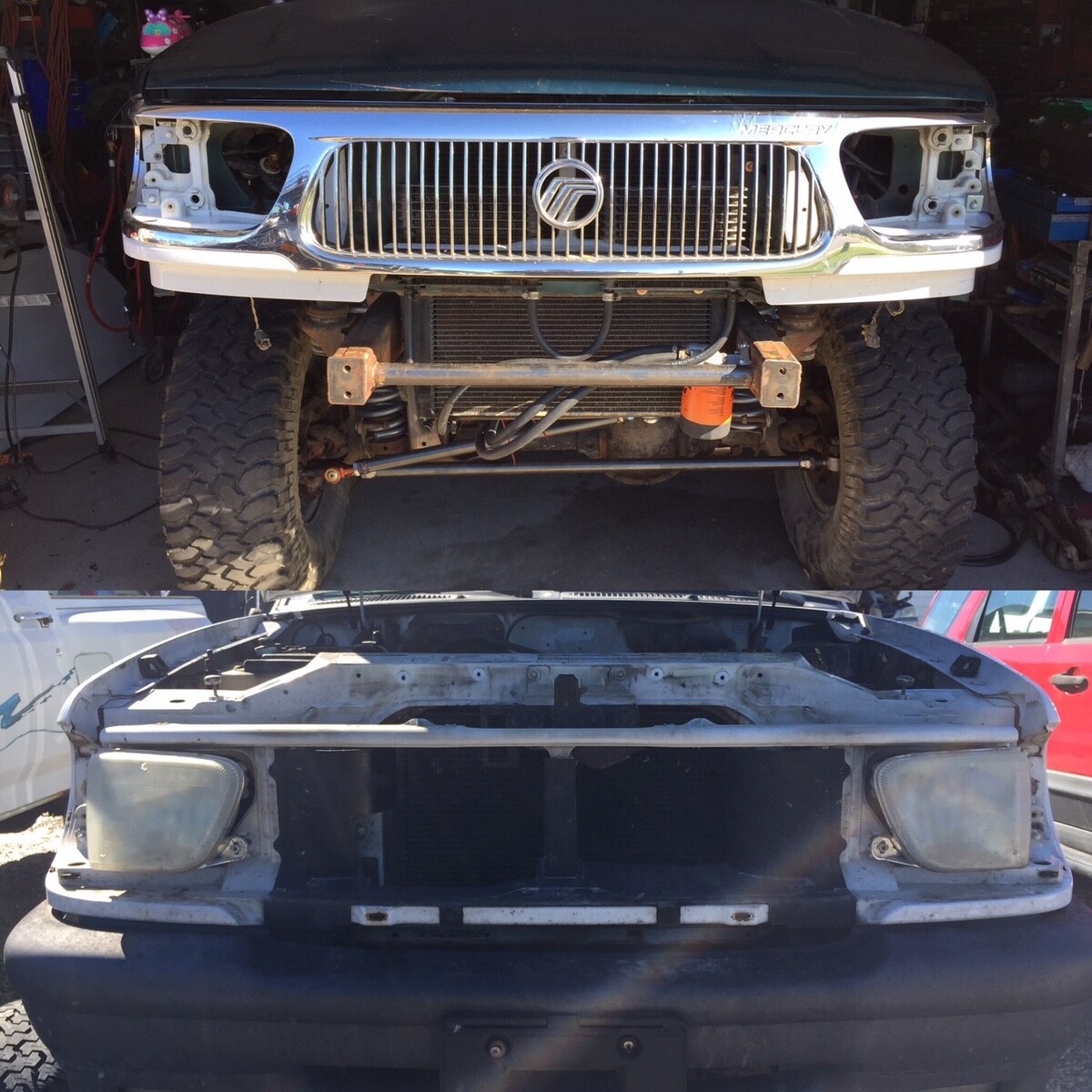

While at the junkyard, The same V8 Mountaineer that I pulled the trans cooler from, had a nice grill and grill support....I was all over it! I love the headlight setup than the stock Explorer units. ;)
New headlights and turn signal lenses are on the way!!!!
**Note to self....change secondary latch handle :snicker:
Good get. You'll like those, but it does need a small wiring change. There are fewer turn signal lights I think is the issue. Several people swapped to the Mountaineer grille and lights a long time ago. Eric with a 99 Sport was the first, he figured out the lights then and posted it in his 302 swap thread. He's got an LS in one now, it shouldn't be too hard to find his threads.
I really like how the Mountaineer front grill and lights look. I have been wanting to do the same thing with mine.
P.S. Looking very good sir.
I figured others have done it, but nothing that I could see here on the forum. (The chrome grill I got isnt the best, but will do great for now till I find a new replacement.) Fitment looked way to close for it to not work.
Ill look for that thread for the wiring....should be easy enough!
Thanks Don! @CDW6212R
You're welcome, I have to do that with my 98 Explorer too. I bought a colored grille ages ago for my Mercury, and now my 98 will be my best truck project. The OEM NOS lights were still available on eBay when I bought my last set a year ago. Hunt those if you can.

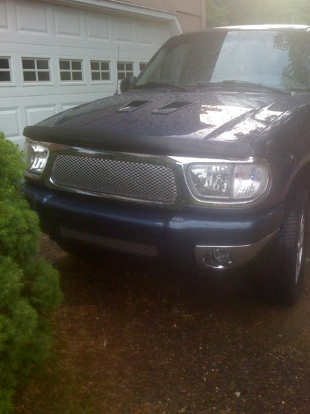

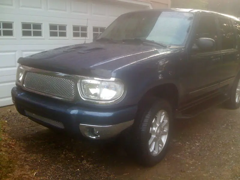

I did this mod years ago with my '98 Explorer. Just leave the two extra sockets for the front lights empty, but protected from getting any water seeping into the sockets. The Mountaineer has a different flasher (same type connector) from the Explorer and all you have to do is use the flasher from the same year Mountaineer in the place of the Explorer original flasher. No rewiring necessary.
I did this mod years ago with my '98 Explorer. Just leave the two extra sockets for the front lights empty, but protected from getting any water seeping into the sockets. The Mountaineer has a different flasher (same type connector) from the Explorer and all you have to do is use the flasher from the same year Mountaineer in the place of the Explorer original flasher. No rewiring necessary. View attachment 163816 View attachment 163815
Excellent, thanks for the answer, and I don't recall seeing that hood. Well done.
Thanks Don for the compliment about the hood, but the real credit goes to Monmix who originated what he called the "Two Scoops" Raisin Bran mod. I really liked it so much, that I had my body guy follow the directions from him found on this forum site. It still is one of my favorites mod for my Explorer.
My hood scoop write up ( sub titled Rasin Bran )

No I will be on the look for a Monty Front Grill and Lights. Just to make it more Different. I like how your grill looks on your Ex @mic98xlt .
You'll also need the 98-01 mountaineer header ( headlight mounting) panel FYI and it is a pita to pull in he junk yard, unless you completely molest the wiring running over and through it. It is a fiberglass part.
I bought a new one for about $50 last year, that was easier. I hope it's as good as OEM, it's some "who" name brand thing.
