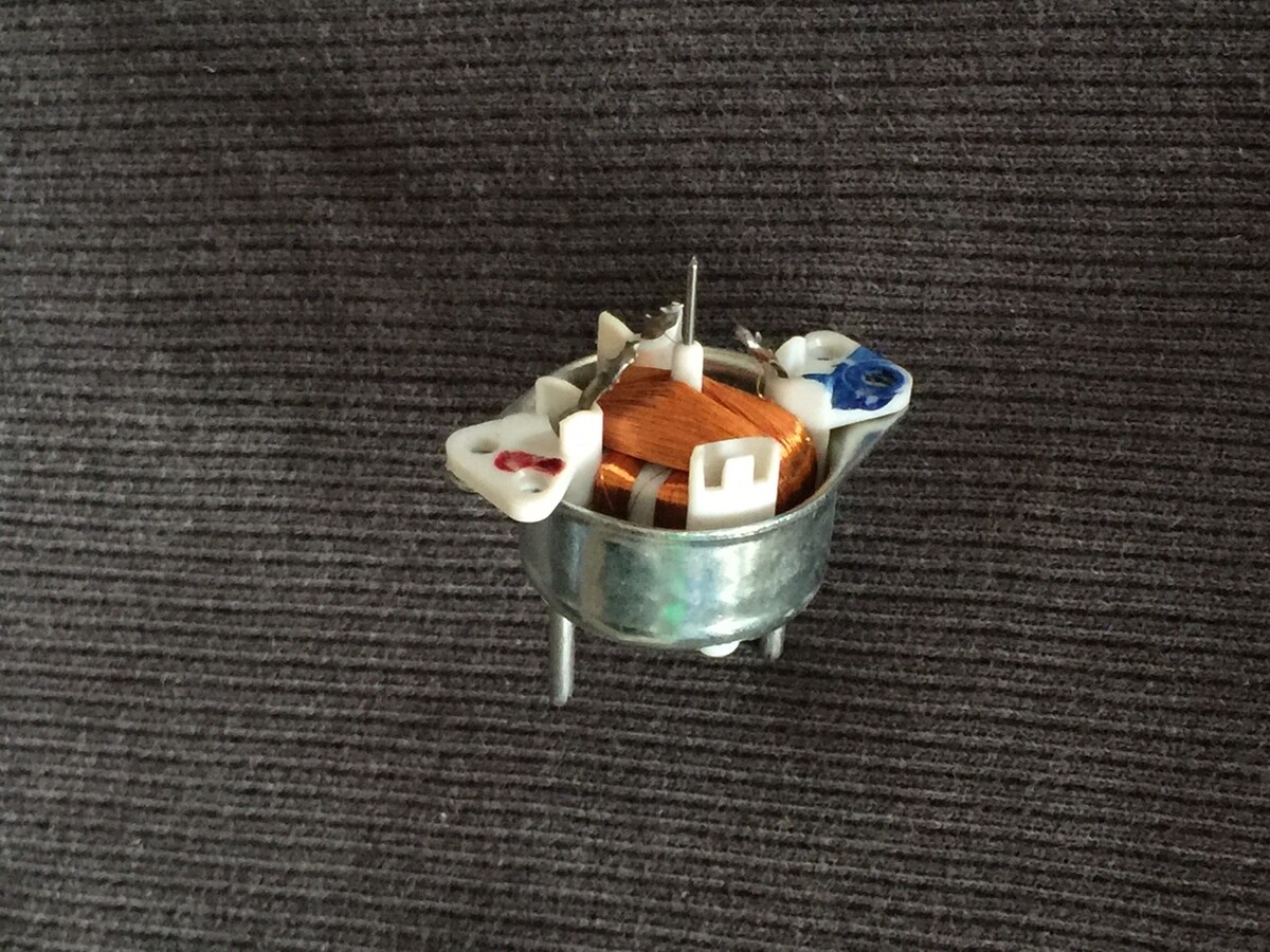

So I thought I would swap out the temp gauge to see if that might be the culprit. I checked my fuses and they were all in good order.
I went to the local JY to pick a couple gauges from a few of the Ex's available and it would give me an idea what to expect when I remove and disassembly my own for the swap.
Removing the cluster was very simple; I don't think I need to get into that. The only one thing that I would mention is to be careful of the shift indicator cable. Carefully remove the indicator by releasing the 2 plastic spring tabs holding it in and slide it out.

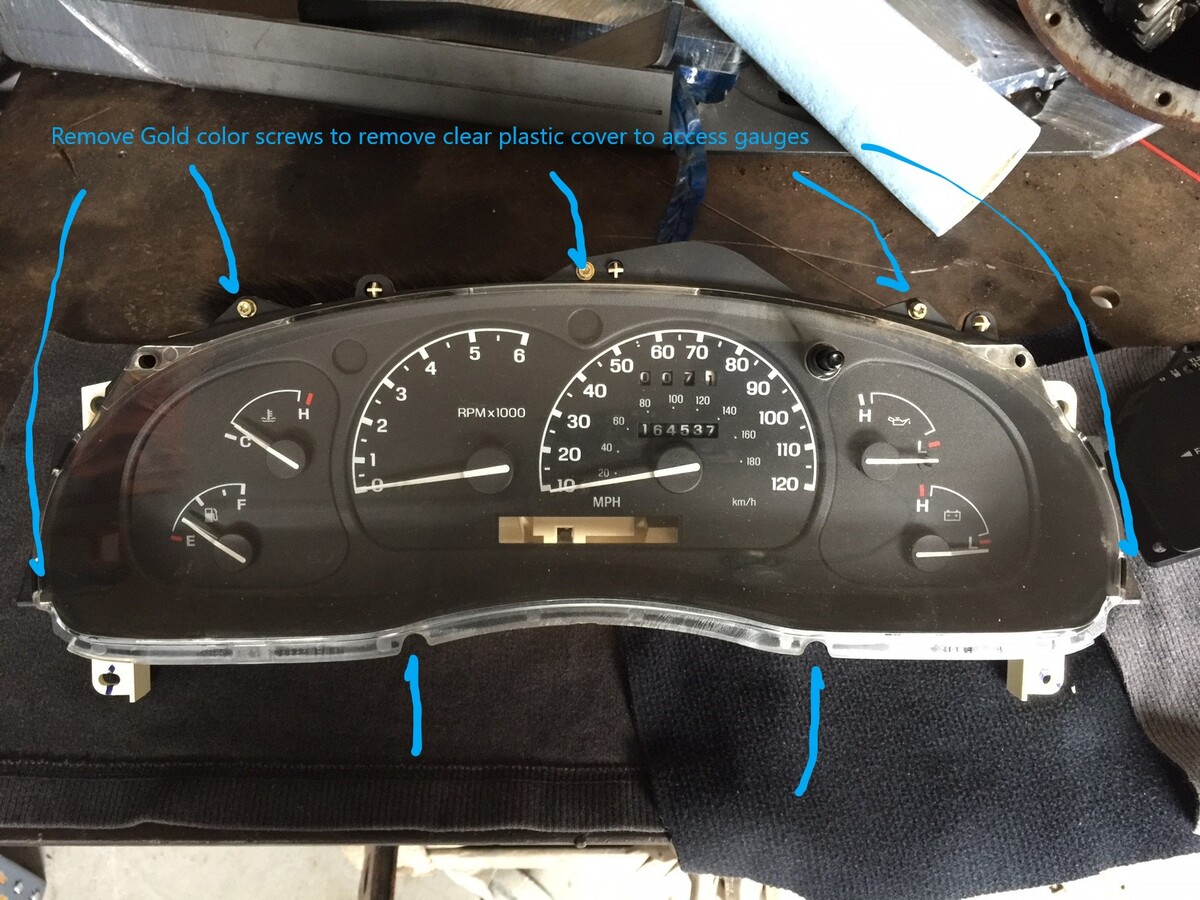

Here is a picture of the original cluster on my welding bench:
index.php
To access the inside of the clear cover, you have to remove the gold screws. The clear plastic cover will remove easily. Note the shift indicator has been removed and is still in the Explorer attached to shift indicator cable.

I will also note the metal tabs that 'grip' the gauge prongs to keep it in place. Note the Temp and Fuel gauge locations.

I removed the needle and temp gauge from the panel -

...(FIX) - I replaced the thermostat in this vehicle. The unit in the Explorer came apart in pieces, there are photos of it removed. The gauge has started working since swapping in a new thermostat.
