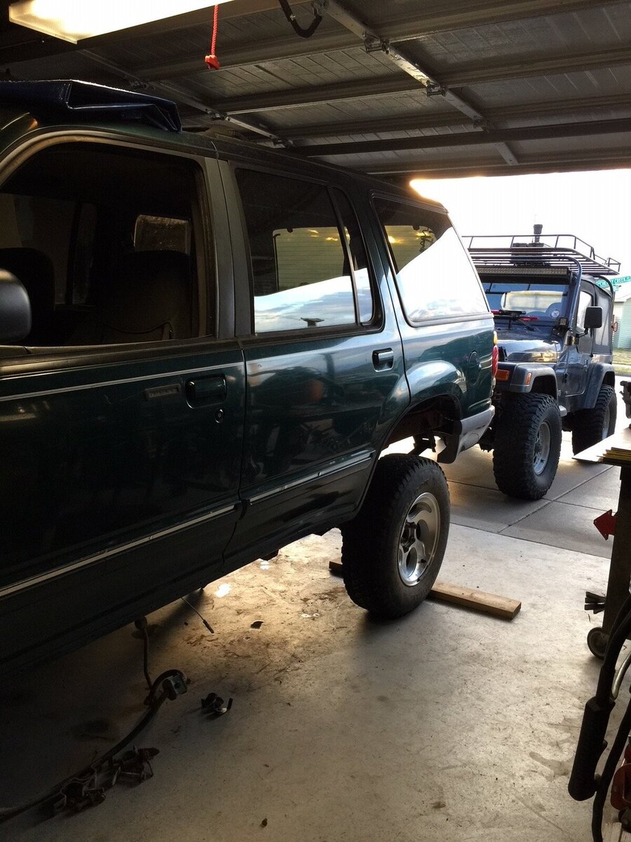

As for the rear, I put the springs back in, got everything line up and welded the brackets in place. For mocking purposes, I used the original U-bolts to put everything together to get it back on the ground so I can set up the rear brake line from the frame.
Bent a new line for the rear axle - ill get it back on after all the new brake hardware arrives. I wanted something clean and simple.
Looks like I will need a few new parts, but here it is after the swap. (Ill get a side by side this week next to my Sport so folks can see the height change.)

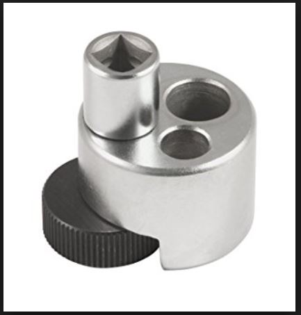

These normally work great, not enough meat to grab the stud....Darn!

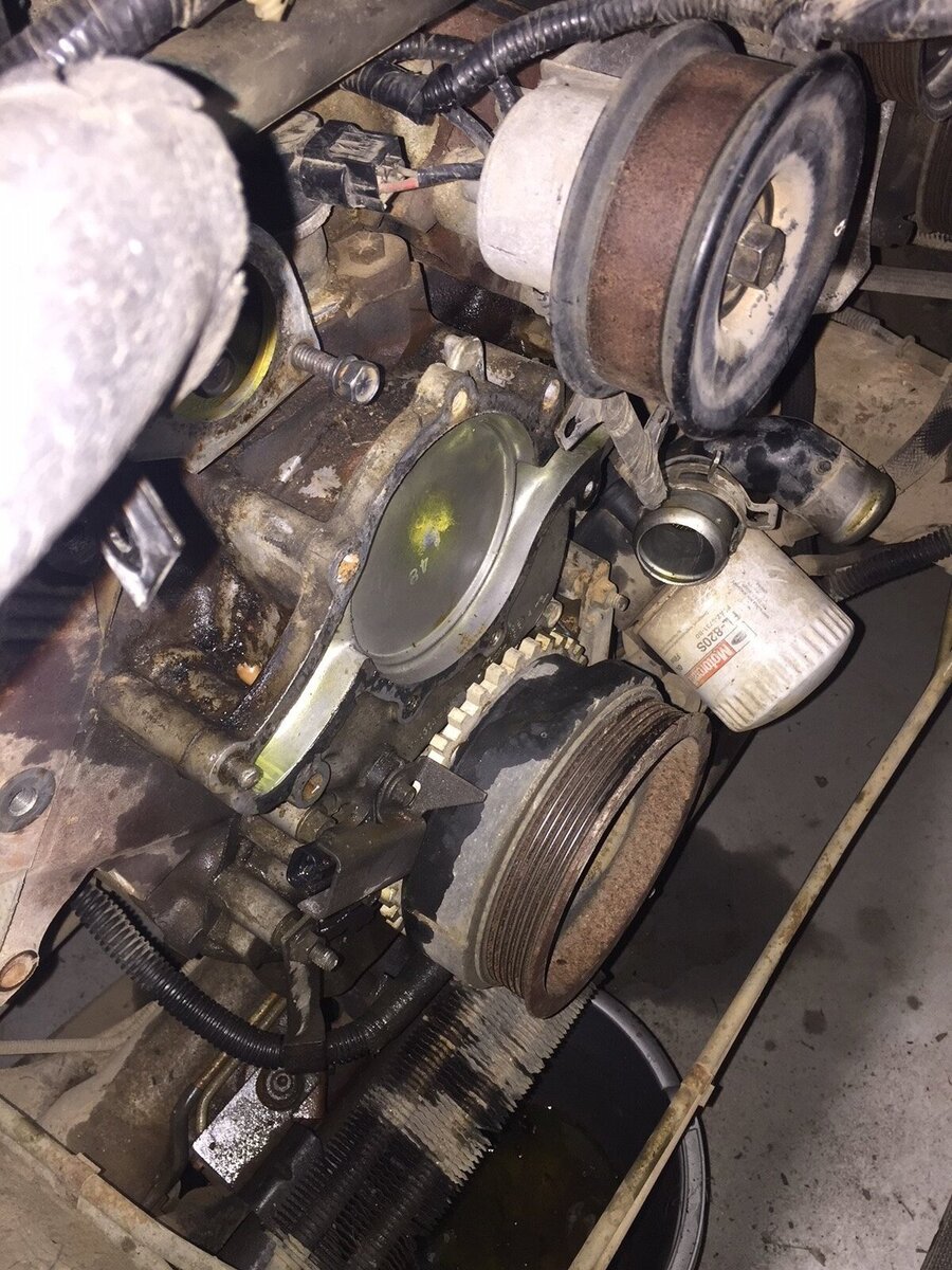

I went through the process of pulling the Harmonic Balancer. I'm sure this is covered extensively so I wont bore with the removal details. Just make sure you have a 3 bolt puller on hand!
Got the balancer off and removed all the bolts on the lower part of the timing cover. All of them, including the 4 in the oil pan came off nicely.

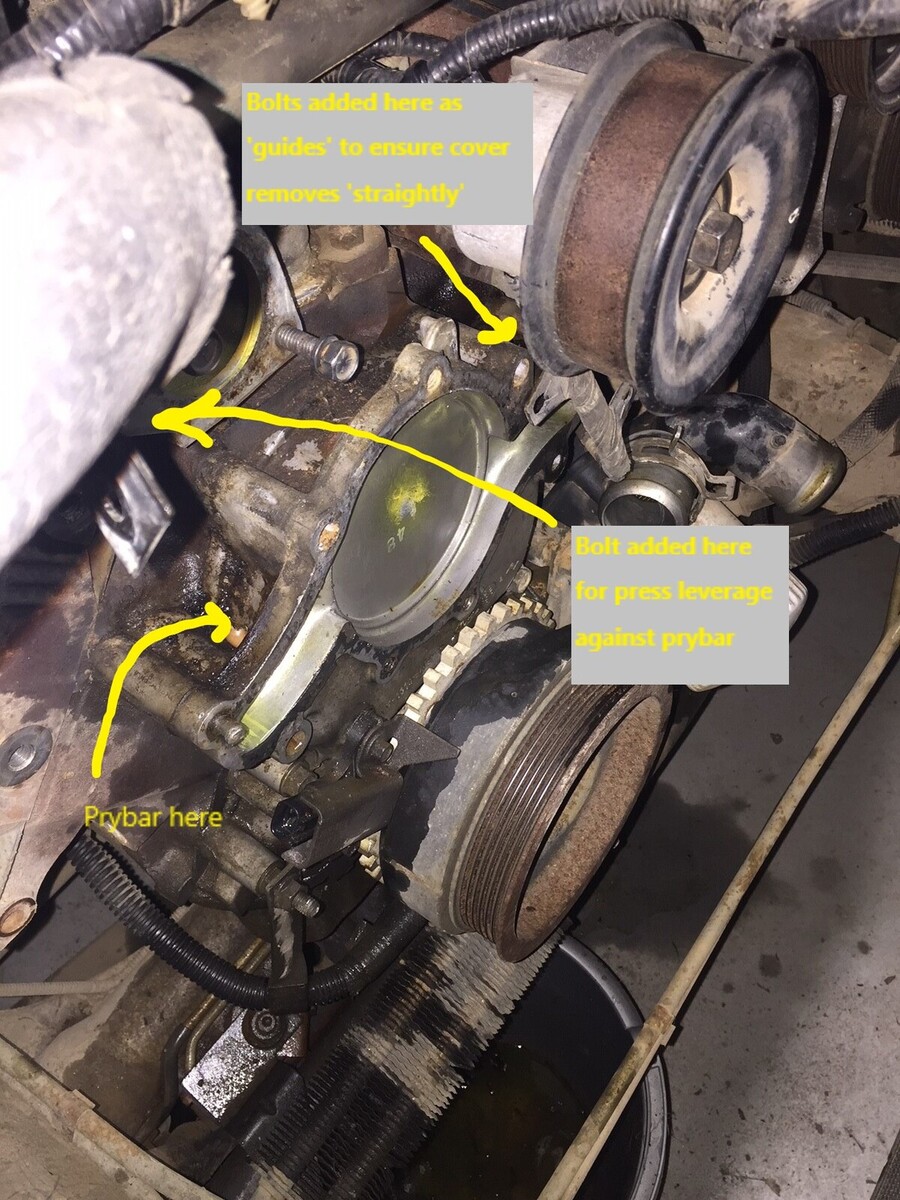

The biggest issue I had was trying to get the cover to clear the broken bolt. I had not done this before on these motors so I wasn't sure if the bottom of the cover had to be lifted up first to clear a lip in the oil pan. Luckily, there was no lip and the cover needed to be pulled straight off the block. It took me 2 long...frustrating hours of finessing the cover using a large pry bar in the upper corner near the bolt in order to get leverage to pry it off near the bolt. As soon as I saw movement, a grin started to evolve on my face. I left 2 bolts on the opposite site of the timing cover to ensure it pulled away from the force straight-like without warping the cover. Right above the cover, I had to put in a long bolt to give the prybar a place to press against to help rock it off. (see picture)
index.php
Timing Cover removed! :mad::confused::p

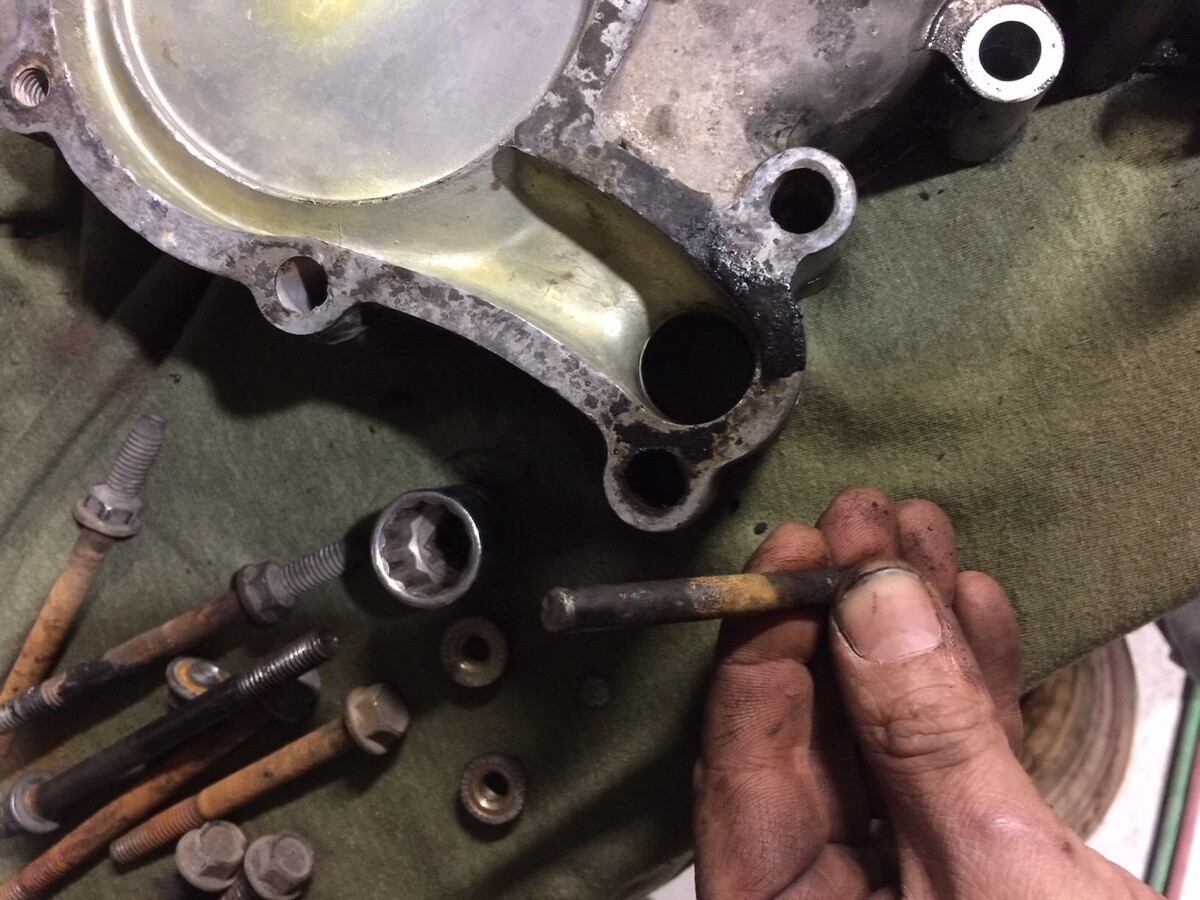

Okay, here is the 'WTH' moment of the day o_O
I get the cover off and the bolt easily comes right out of the block with my 2 fingers. :eek: Im not complaining but seriously!
index.php
The issue was there was a massive amount of rust built up in the hole. Rust expands as it grows and can bind up spaces without you knowing it.
I took the bolt and scraped the inside of the hole and all this 'gunk' came out. I then took a wire brush and used a drill to clean it out further. Dont be fooled! :cool:
index.php
